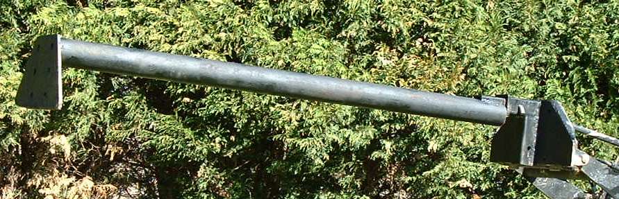

<font color="blue"> We've got a few more projects to come. We're planning a PHD and a winch that will share the same hydraulic motor, hoses and valve. The motor is here, and the hoses, valve and fittings are on their way from Surplus Center. We may also be able to use the same motor setup for a wheel trencher.
Nearly all of the steel we use is salvaged from various sources.
We're trying to figure out a way to counterbalance some of the weight of the 60" mower in an effort to control the uphill wheel lift issue. Some sort of removable pring mechanism attached to the lift arms is our best current guess.
We also think a side boom heavy duty string trimmer might be possible. The design concept is for a hinged, lightly spring-loaded arm and fairly long skids at the cutting head to allow for a good bit of movement.
We've got the same plowshare from TSC that another TBN member (was it MossRoad?) used as a slitter, and plan to work on the cable-laying idea with it.
We also plan to shamelessly steal a bunch of JJ's engineering work for a grapple, although ours will be set up more for rocks and logs than for brush.

<font color="blue"> Steal away! I've been told that's the way the best designs happen.
I don't think I explicitly mentioned that I plan to combine various length booms with interchangeable end attachments.
A rake would be a good thing for us, too, especially come fall.

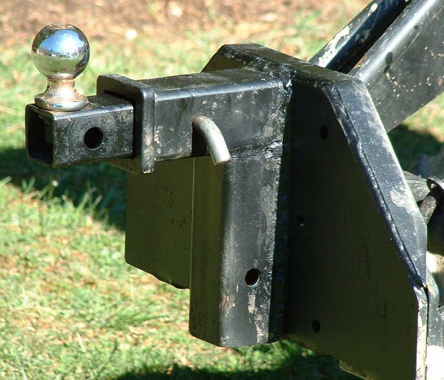

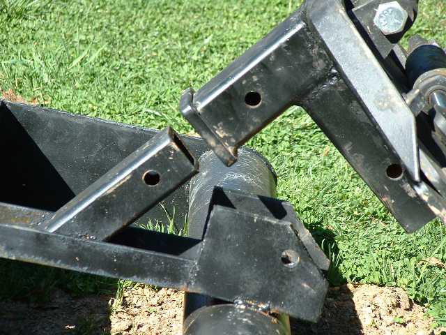

/ Meet Kermit! #33
Nice work, Gravy. I really like the two receivers on the quick attach plate. Very versatile. /forums/images/graemlins/wink.gif

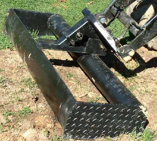

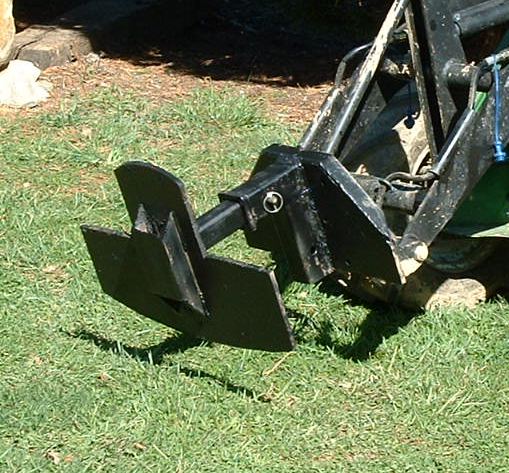

Gravy, how thick is the steel on the ditch scraper? Can you give me approximate dimensions? How is it holding up?
Thanks,
Bob Rip
/ Meet Kermit! #35
I came across something that you might can use to help with your welding. It is a magnifier lens that fits inside a welding helmet. Your local welding supply should have it. Just a couple of dollars. It helped me to see better. I use the automatic helmet. Good luck
/ Meet Kermit! #36
Thanks J.J.
I have stopped welding unless its a sunny day. That really helps me if it is bright. I have tried using spot lights with limited success. I will get the magnifer lens and give it a try.
PJ
/ Meet Kermit!
#37
Bob,
The plate is about 5/16" - 3/8". I haven't used it much, but when I did it snagged some rocks pretty hard and doesn't seem to have bent. If it does, I'll add some reinforcement.
Dave
