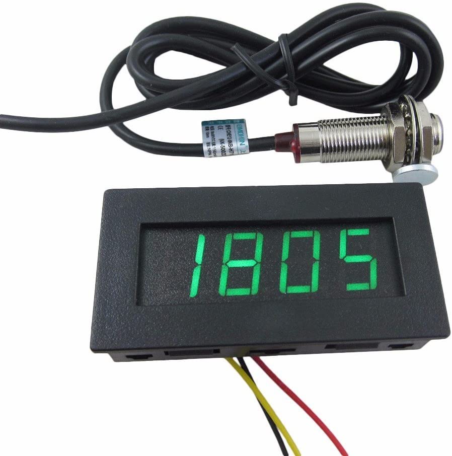

This ^ ^. I don't like not having a tachometer, and diesels aren't easily 'up-fitted' without a spark signal to trigger one. I found this digital online with choice of red, blue, or green readout for <$20. One only has to mount the sender and epoxy the rare earth magnet & a cwt 'somewhere' opposite of each other. Amazon.com: DIGITEN 4 Digital Green LED Tachometer RPM Speed Meter+Hall Proximity Switch Sensor NPN: Automotive
