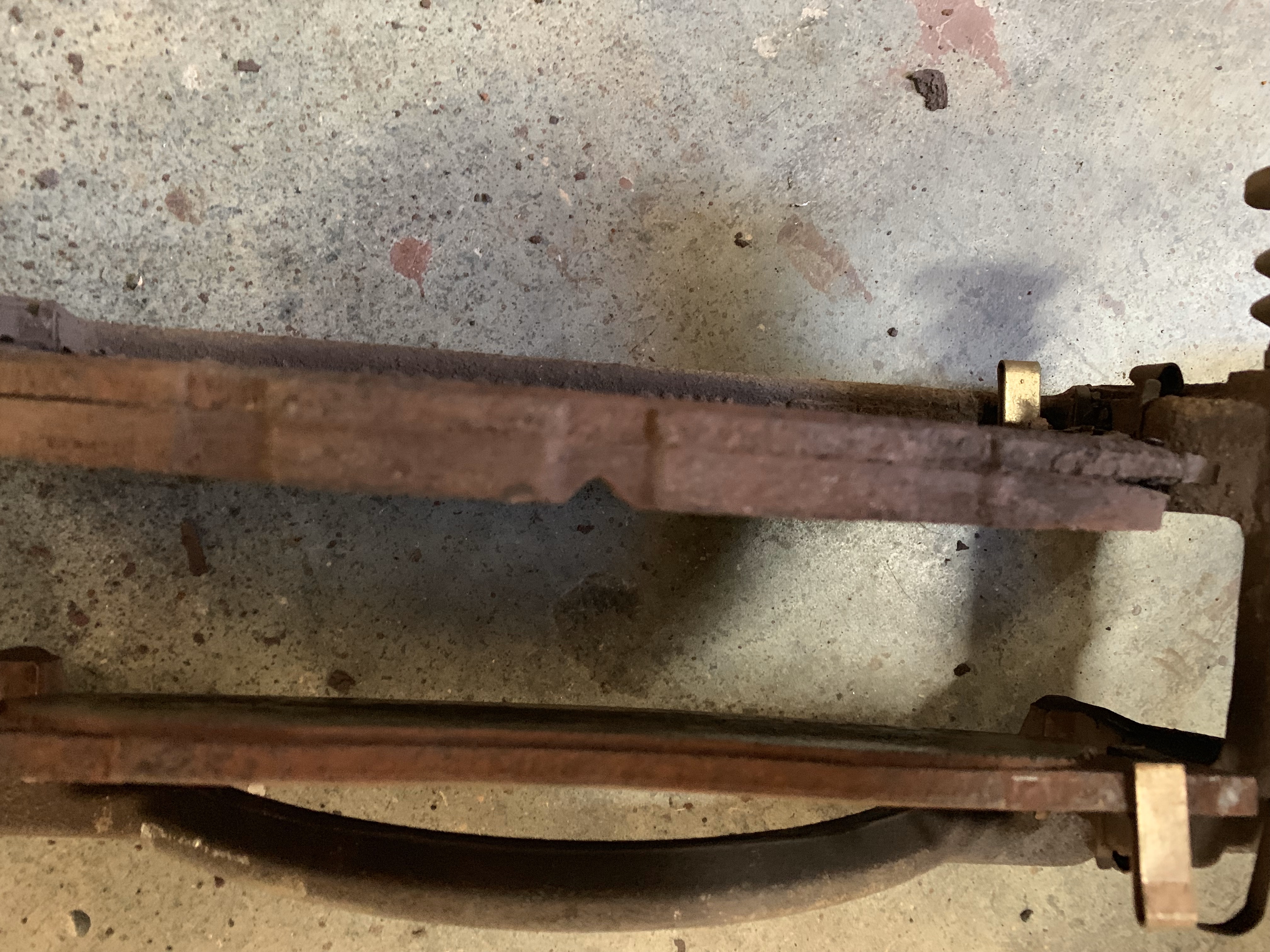

Today I noticed I get a squeak in the front wheel for the truck (2012 Ram 2500 diesel)- was fine going to the store, returning it was a constant squeal, like a brake indicator.
Truck has 28K on it (2012) and I just checked the brakes in Jan (1100 miles since then) and they had plenty of pad left.
I pulled the wheel when I got home and found passenger side front- basically in good shape and tons of pad left.
Drivers side , inside pad was fairly thick but rusted, outside pad was down to wear indicator and totally shot.

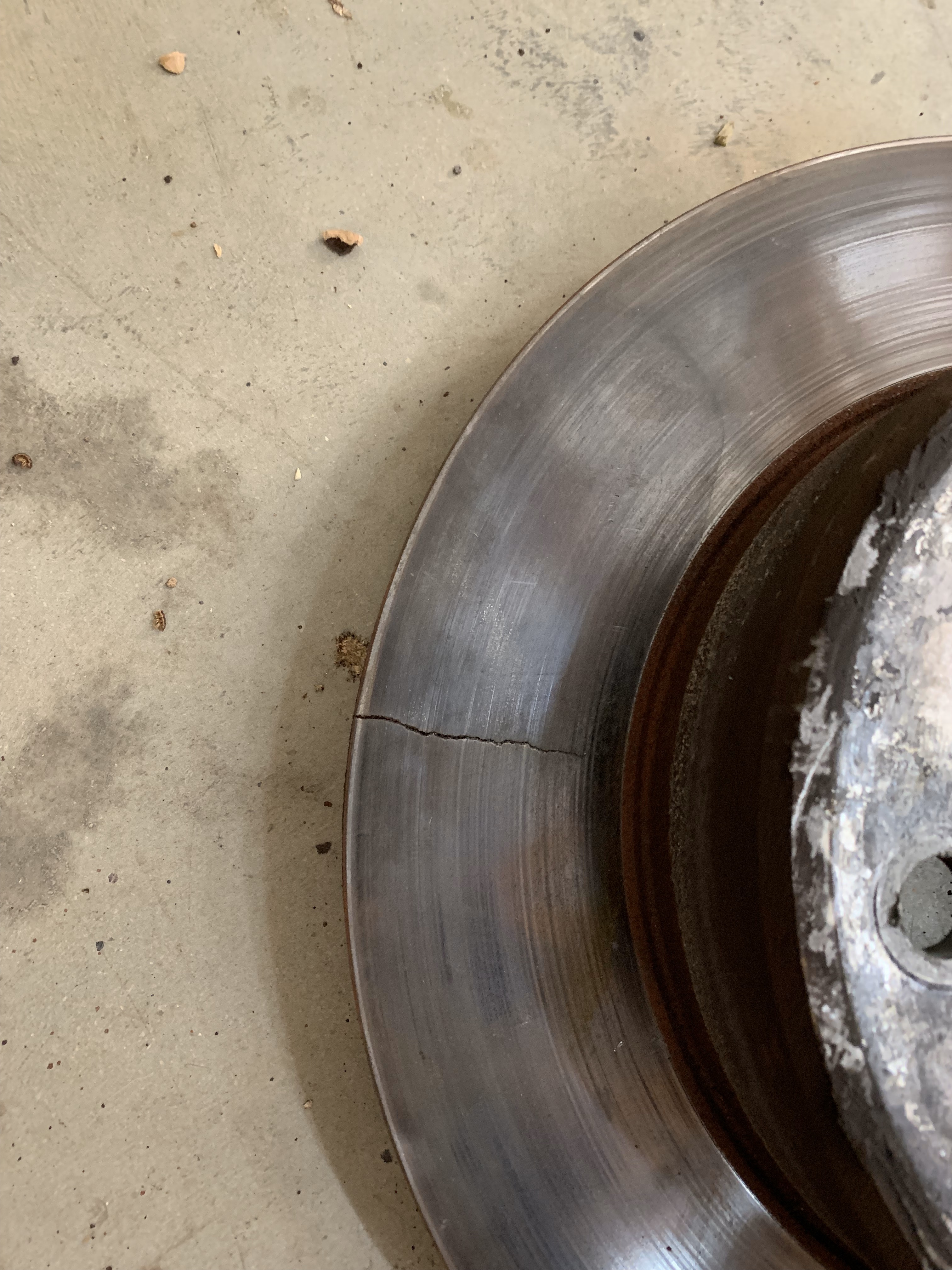

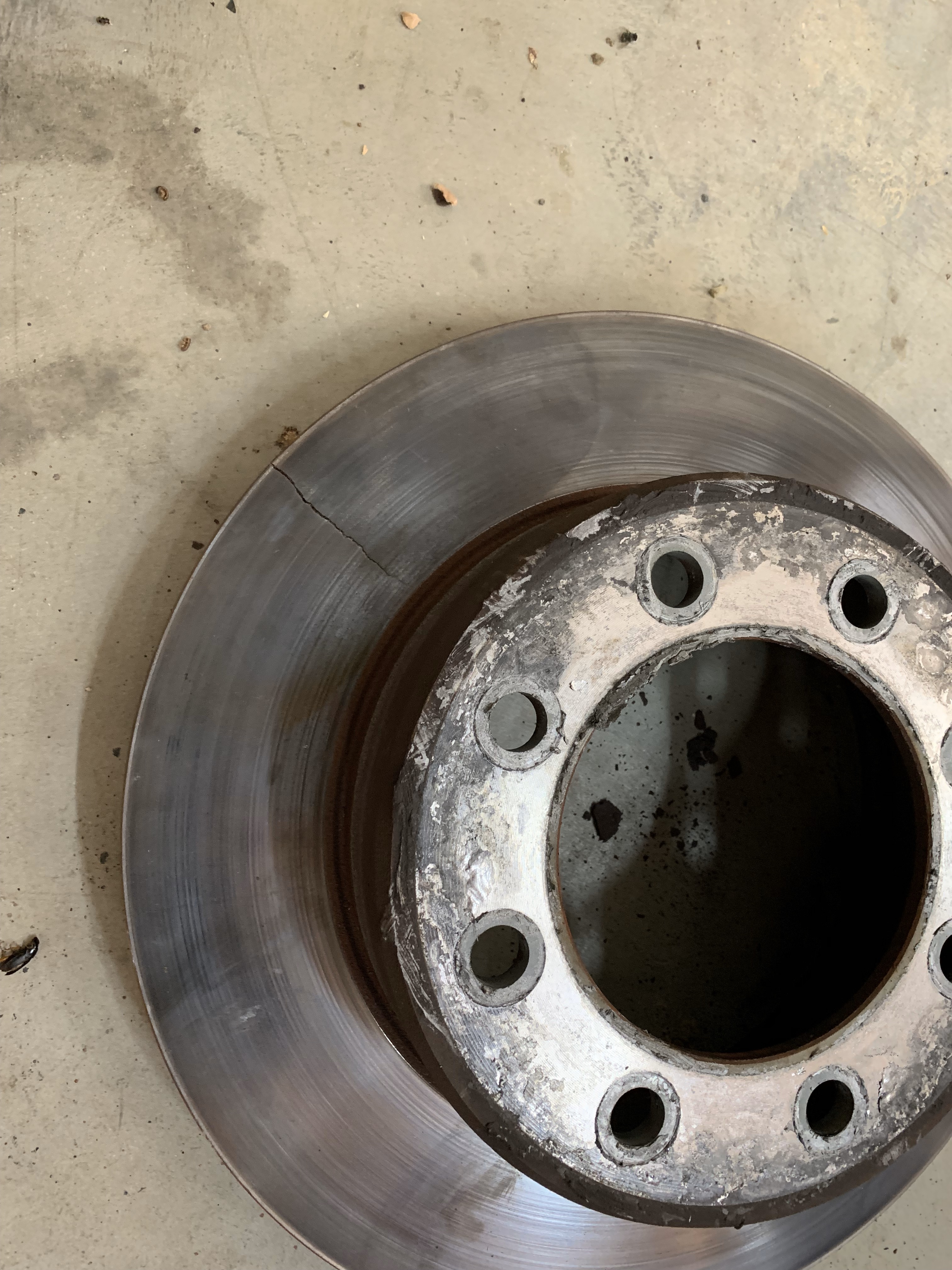

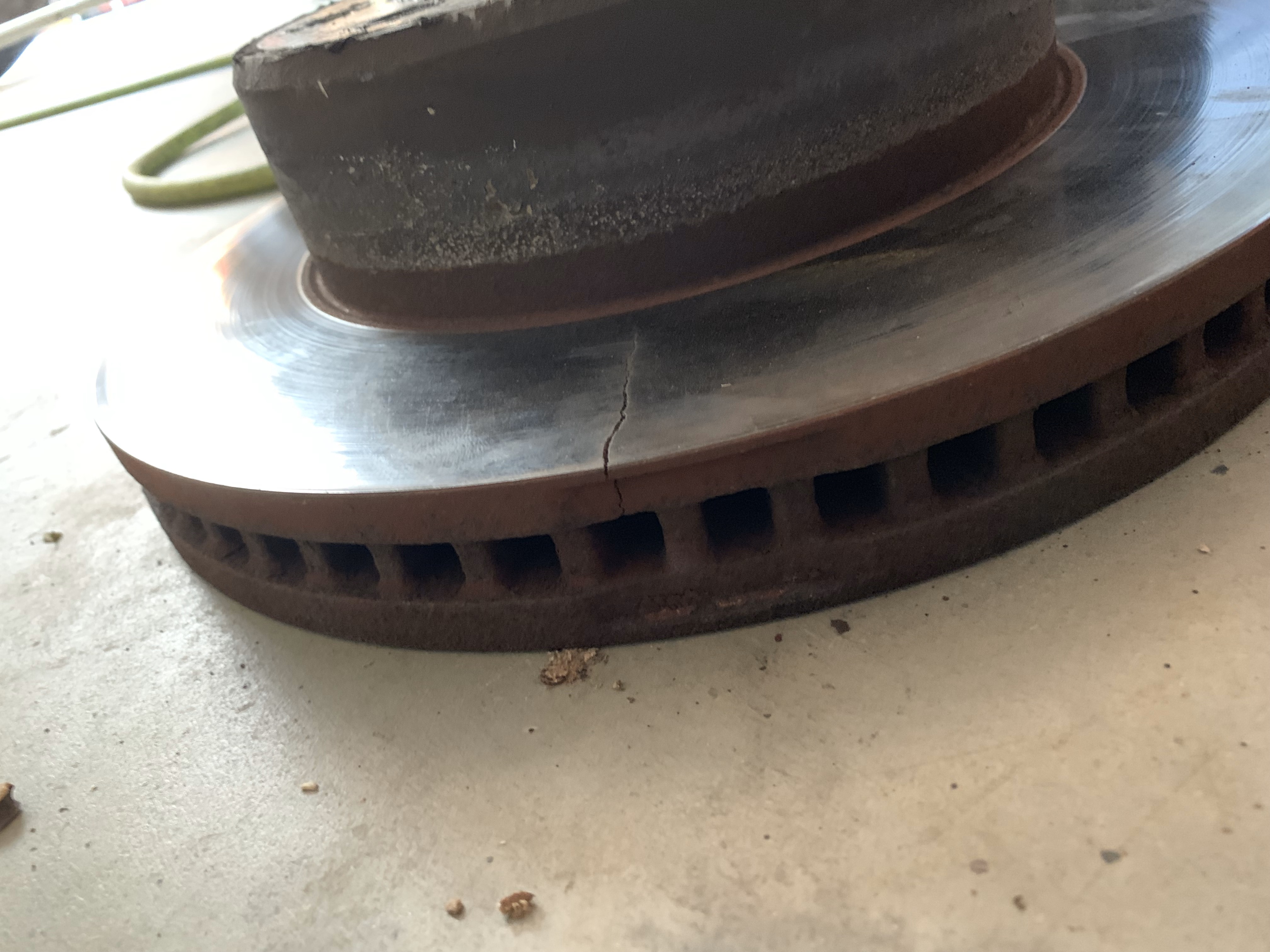

I figured I would pull it apart and order new pads and check the caliper. Soon as I pulled the pad I found my drivers side rotor was cracked.
The crack was on the side where the pad was worn to nothing.
I ordered two new rotors and new pads. Caliper I believe is fine and THINK the crack has been cutting a little off the brake pad and thus why only one side is worn.
Now the question is - what caused the crack? My GUESS, the truck sits a LOT. Sometime I drive it once every month or two. I was thinking the brakes seized to the rotor and thus when I hit the throttle I broke it loose cracking the rotor? I did notice what looked like a pad "imprint" on the rotor and thus why I was thinking this maybe the case. Any ideas/thoughts?
