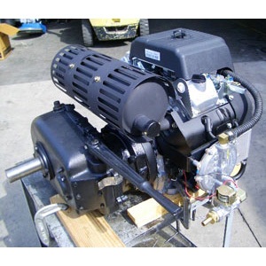

sent an e-mail to Continental engines yesterday to get specifications for a mechanical clutch they are building in- house to see if it would be applicable for the PT it looks promising will post more information as I receive it , unit is not very large judging by the pictures but I wonder about the price?

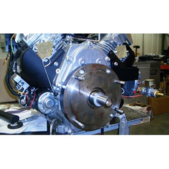

   / mechanical clutch for subaru engines #5
Good find.
They are coupling it with a reduction gear, but I would sure like just the clutch. I have been looking for an inline clutch like that, but the only v-twin clutches I have seen have had a pulley mounted to them.
Subaru EH72 Gear Reduction Clutch - Continental Engines - Greenville, SC - Orlando, FL
Edit:
Looking a little closer, I suspect that the plate above is just a mountingplate, and not the clutch. I think the clutch is resident as part of the reduction gear assembly, based upon the big lever that I assume operates the clutch throwout bearing to engage/disengage it. Don't think that whole thing could be sandwiched into our engne compartments.

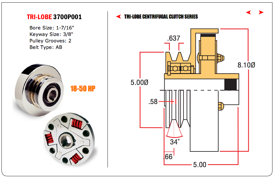

It is too bad that they don't make centrifugal clutches as inline clutches, with a stub shaft instead of pulleys on it. You see those all over the place, and just about every riding lawnmower around seems to use them.
http://www.noramclutch.com/centrifugal-clutch/trilobe.html
edit: hmm, maybe something like this:

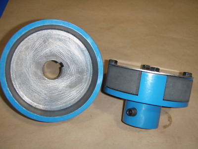

search ebay for centrifugal clutch coupling style, and you find a clutch that accepts 1" diameter keyed shafts from both sides.
This looks like a BLM clutch, but at least the ebay one of course has the wrong shaft sizes. It appears that you can spec the sizes at BLM, but I haven't found a vendor for them. Of course, this would require some sort of mounting bracket for the hydraulic pumps, since the current mounting bracket is not big enough around for a 5" clutch cylinder.
Anyone know the shaft diameter of the hydraulic pumps that PT installs?
http://www.blm-cm.com/prod1.asp\
Boston Gear also makes centrifugal coupling clutches. Anyone feel like being a guinea pig?
http://www.bostongear.com/products/clutch/chart-centrifugal.html
