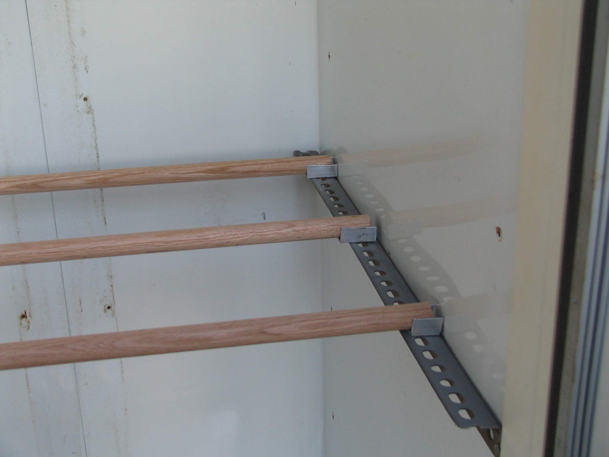

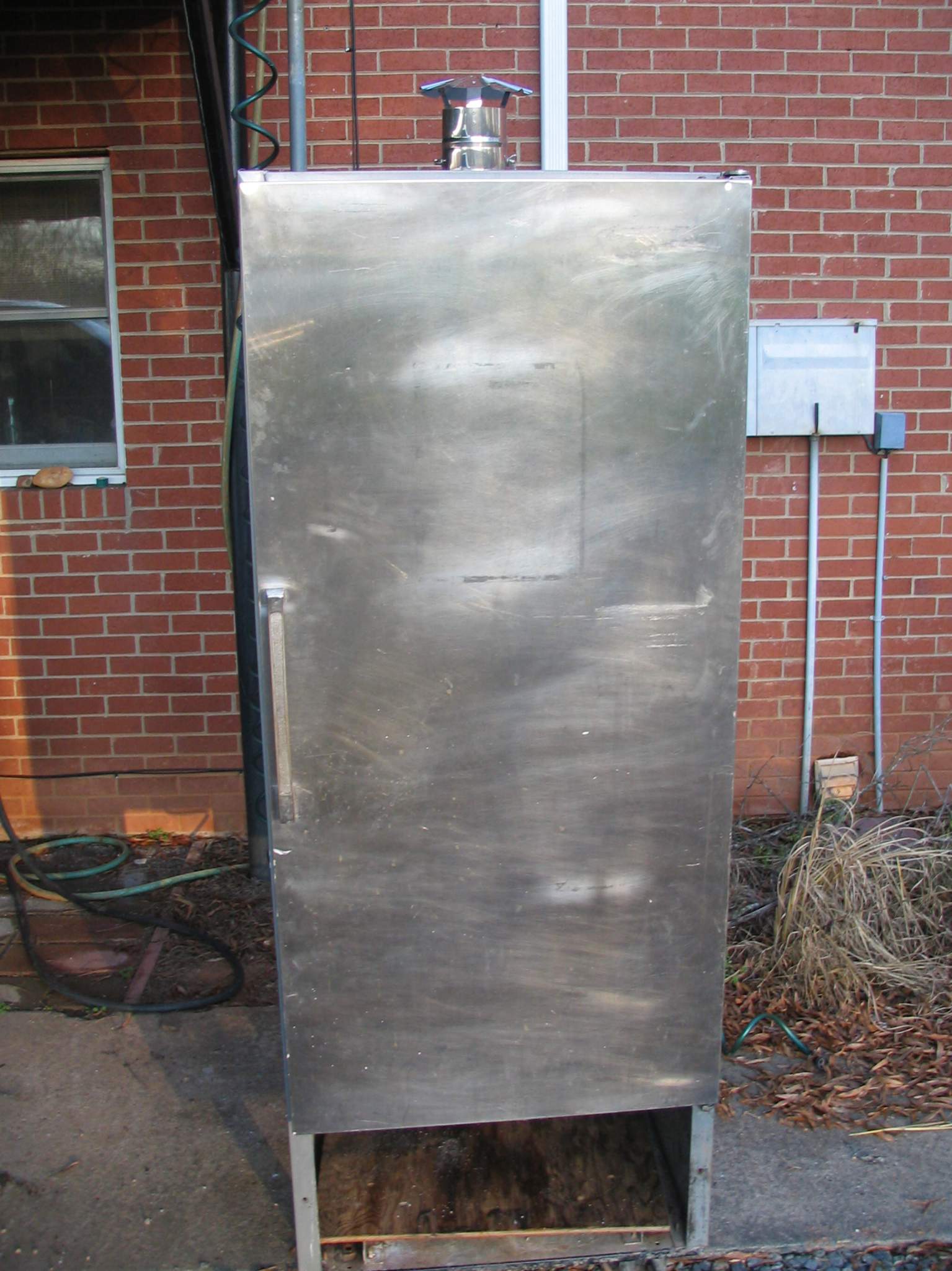

I built one out of a commercial beverage cooler. Just a big refridgerator. I used a $10.00 electric hot plate with a cast iron pot and apple chips. Not fast enough recovery, gotta do better. I have a separate fire box a friend built for me. Will probably use that at some point. Right now will probably build a lp burner. I used some of that 90 degree angle sheet metal for side racks, attached with tek screws. I can put standard oven racks on them. I smoked some polish sausage over Thanksgiving, hung on 3/4" oak dowels placed on the racks. I used aluminum c-channel from Lowes, made to put on the edge of 3/4" plywood to keep the dowels from rolling. Pics tonight.

My smoker. Used it over Thanksgiving. More work to do. Will add another level of angle iron for a water pan. Also a bigger burner.

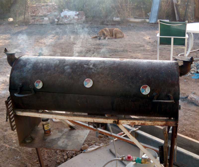

well i finally finished building one i can use..I used 100 gal compresser tank and a 100 gal propane tank cut in half for the fire box..Its a reverse flow..When I did the first burn I had temp as high as 400 F and holding with drafts wide open..Going to cook some ribs this week end

I forgot to add the tanks are 1/4 " thick..need to put some more paint on to make it pretty....:laughing:
/ meat smoker #56
Looks great the pics are a bit small to get the whole picture but from here it looks well done. :thumbsup:

ya sorry ..the pics are small because i took them with my black berry

wow used my new smoker today ...cooked ( smoked ) some ribs ..put a rub on them on them bought from sobeys grocery..They turned out great..What a flavour...wiil never go back to bbqing using propane
