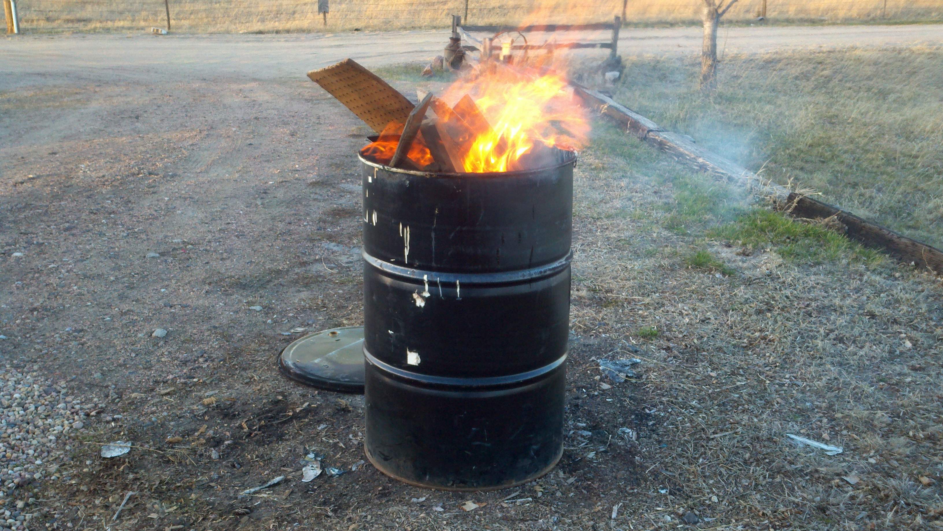

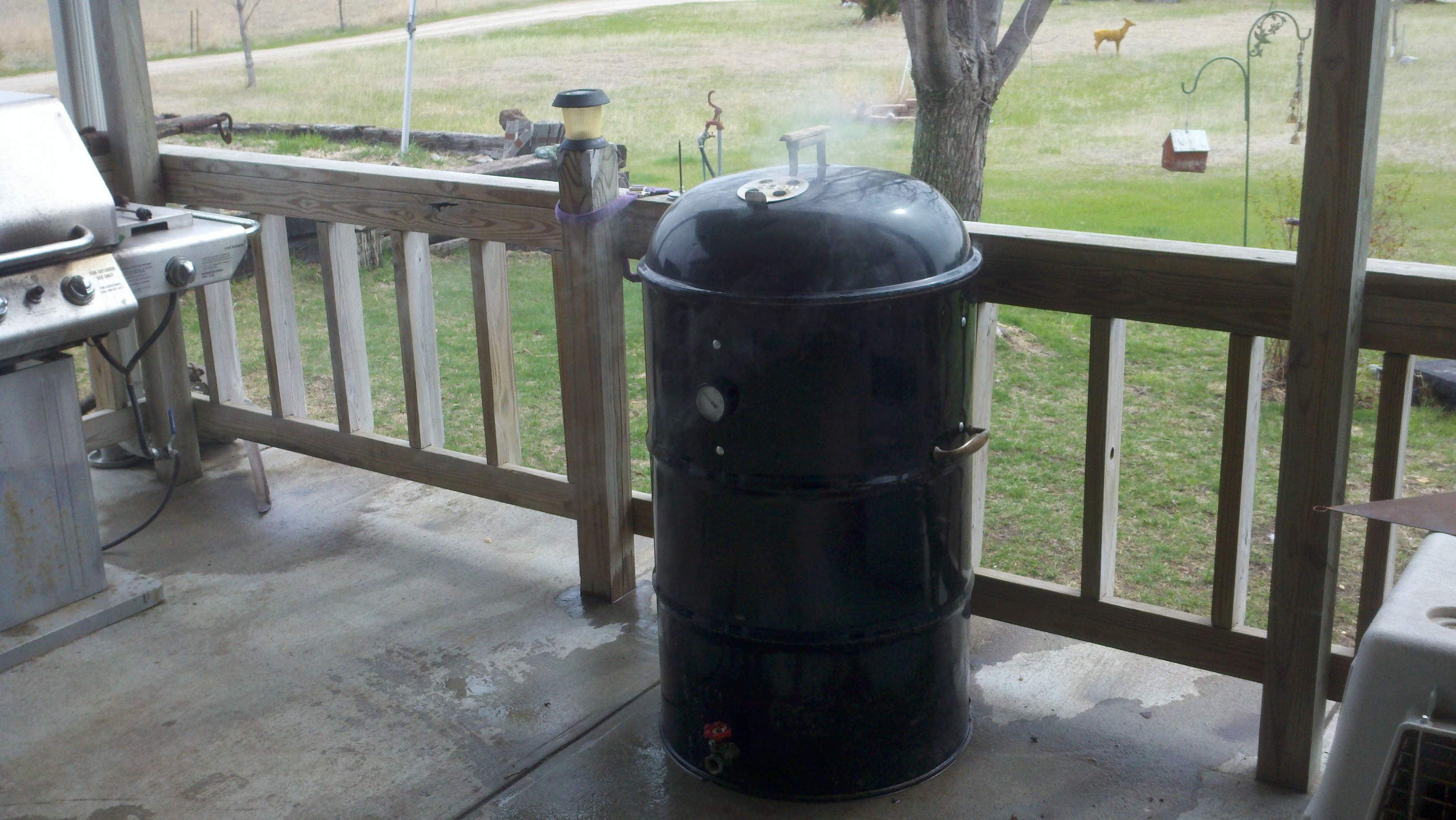

   / meat smoker #10
I made one out of a 55 gal steel barrel last summer they call them UDS. I love it have smoked everything i can think of on it works great and was very easy to make.

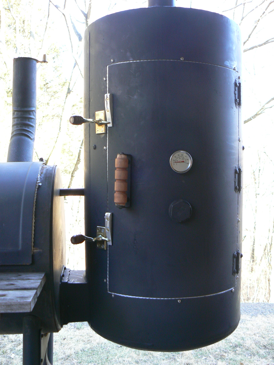

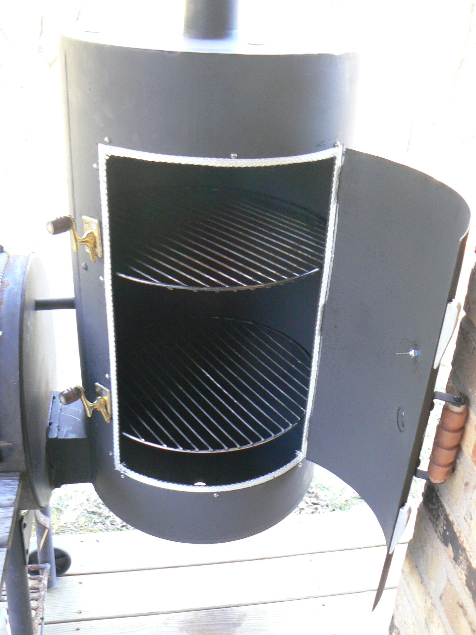

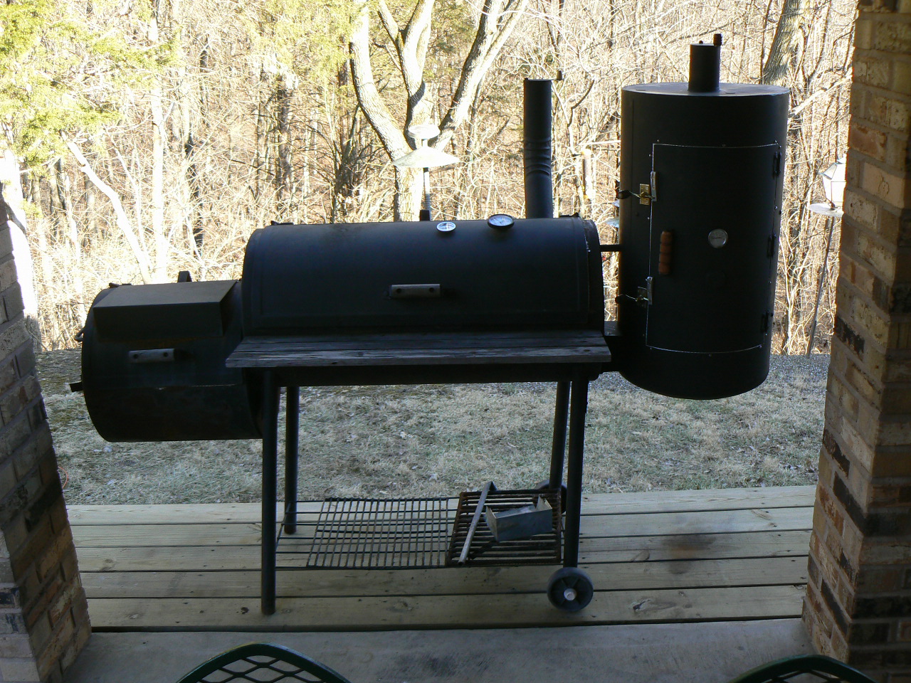

   / meat smoker #15
I haven't built one from scratch, but I added on to the one I picked up at an estate sale a few years ago. I used a little more than half of a 50 Gallon water heater. The add on is just used for low temperature smoking. When it's cold out I can keep the temperature under 60 which is good for smoking cheese.
The grates and water pan from my old Brinkman bullet smoker are a perfect fit.

   / meat smoker #19
+1 on the Ugly Drum Smoker. I built mine last year and have smoked quite a few dinners ever since.
