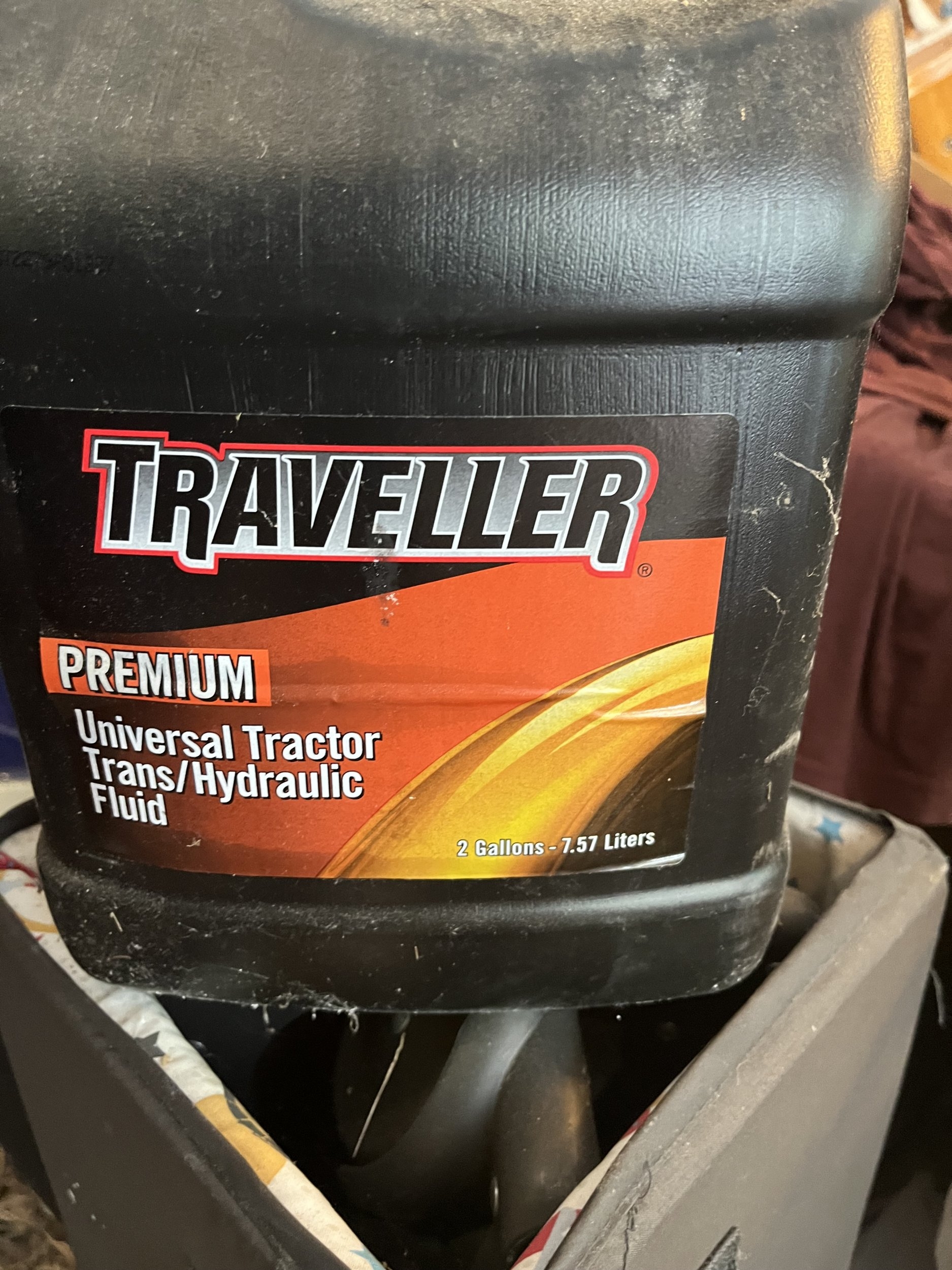

Hi, I need to top off my hydraulic transmission fluid in my Mahindra max 25 HST and I was wondering if this fluid is OK to use. Thanks! IMG_2246.jpeg
/ Max 25 HST FLUID #2
Don't know about the Traveller premium you posted, but I hope this may help you or someone else.
CARQUEST 760-01 tractor fluid.
it has the same spec as Mahindra Universal Hydraulic oil and the same verbage is on the label of the Mahindra oil and the Carquest oil. This leads me to believe they are either made at the same facility or just by "coincidence" are the exact same specification.
I use the Carquest oil in my tractor and know several Mahindra tractor dealers that sell it.
/ Max 25 HST FLUID #5
i refilled my tractor with that about 200 hours ago without issue

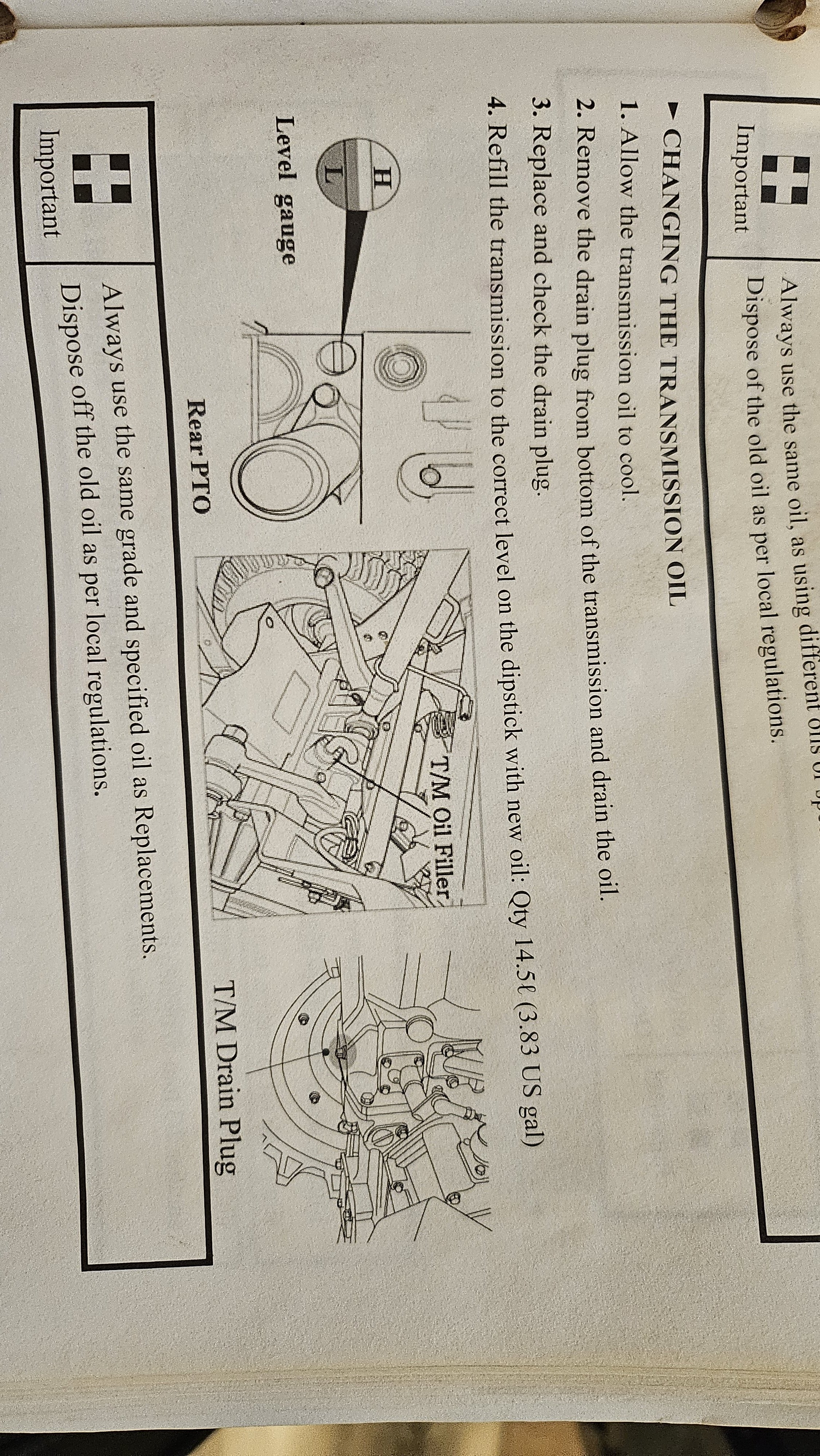

I used the same stuff in OP's pic. Never saw it in the sight glass and ended up overfilling it, I put in about 3 gallons of fluid. Do you know about how much extra these things hold? thanks
/ Max 25 HST FLUID #15
be careful, emax and max are 2 completely different machines, I can't speak to the emax.
/ Max 25 HST FLUID #16
