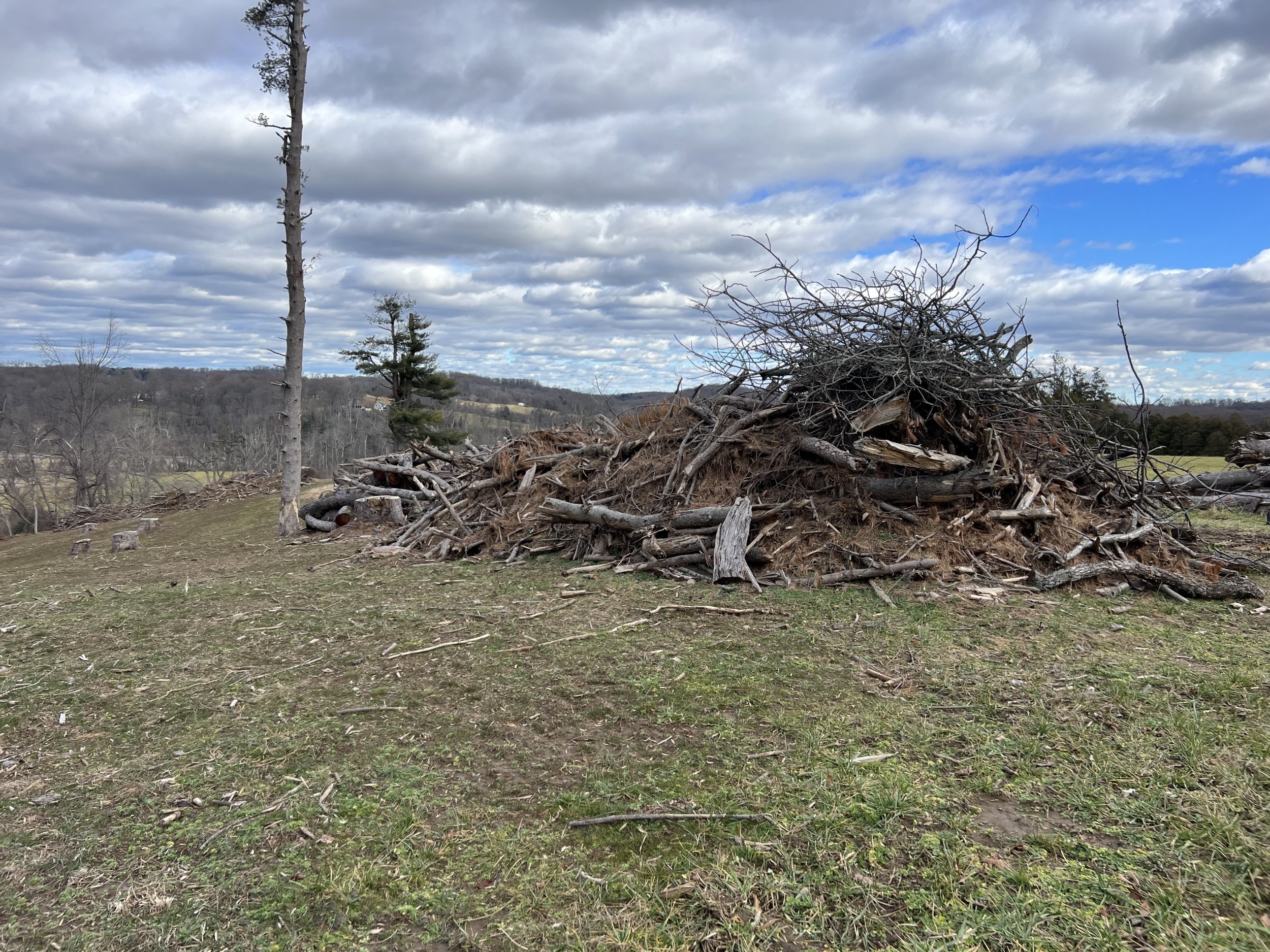

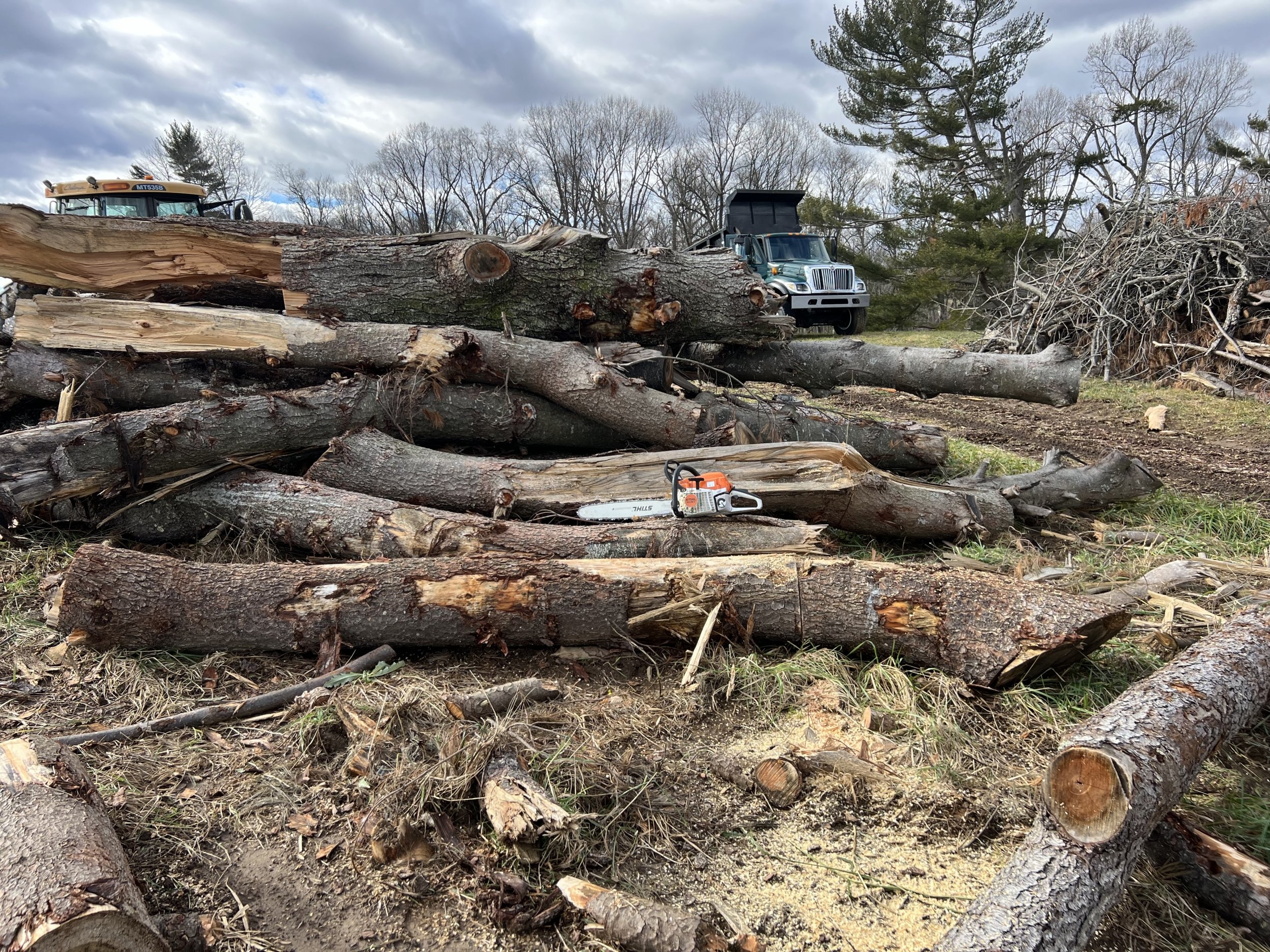

That's a lot to clean up! I collect the brush and downed trees for several neighbors, and burn it off every fall. Nothing like the volume you are dealing with though.

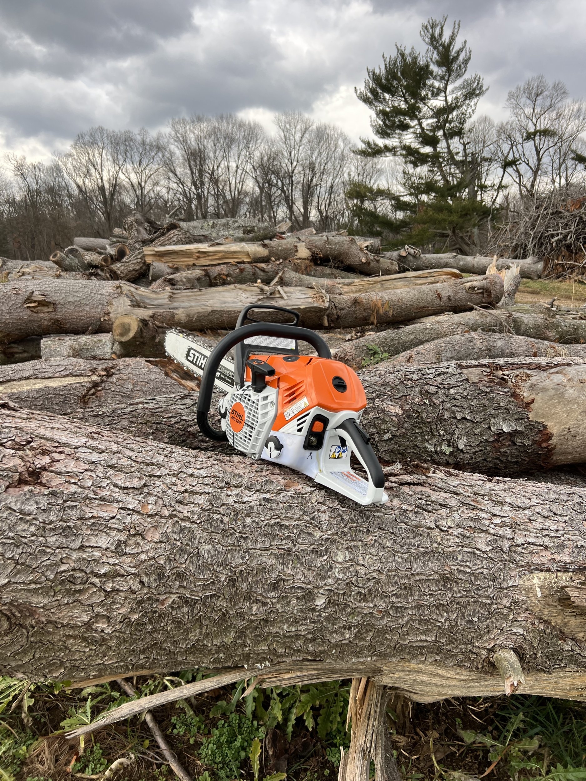

I particularly like the picture of the chainsaw sitting in front of all that WORK!
It sure is. No burning is their mantra, so only chipping or hauling away is left. We chipped 2 small mountains of chips 2 years ago. Neighbor has heater that burns wood chips and Customer uses quite a bit on their walking & tractor paths.
Either way, I get an opportunity to be involved.

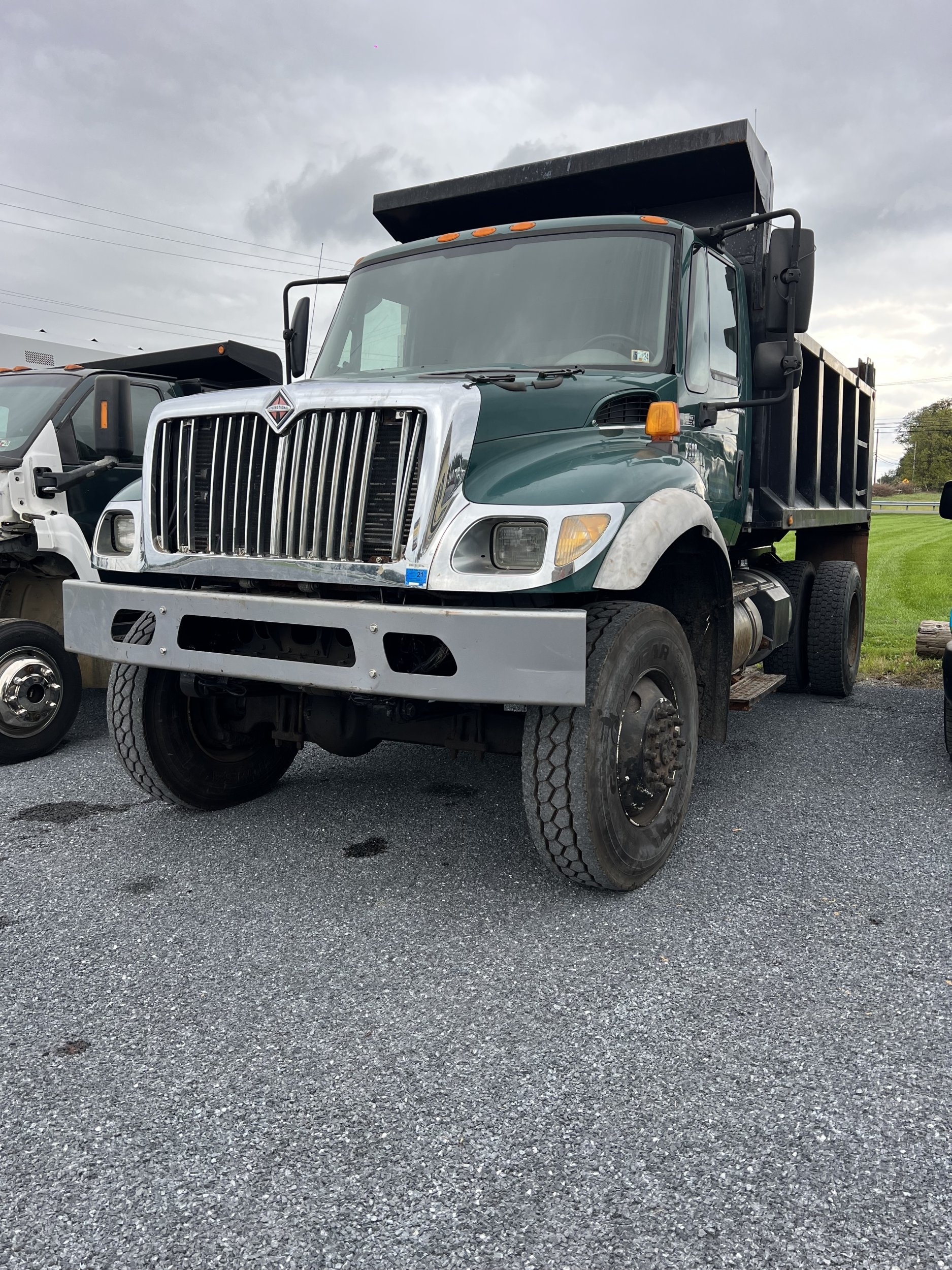

I don’t remember the bumper being kinked…..
Get into a scrape, ore did I just not see it before?
Yeah here it is a while back.

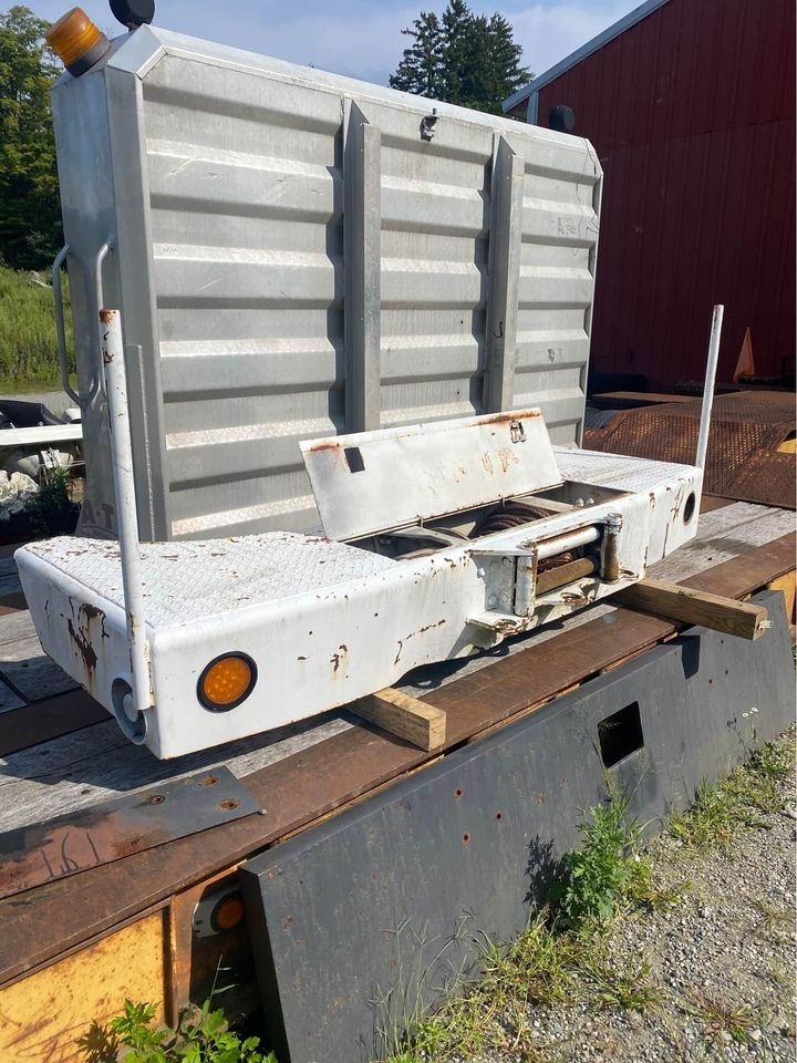

I hope to be replacing it with this 30,000lb winch bumper when $$ allows.

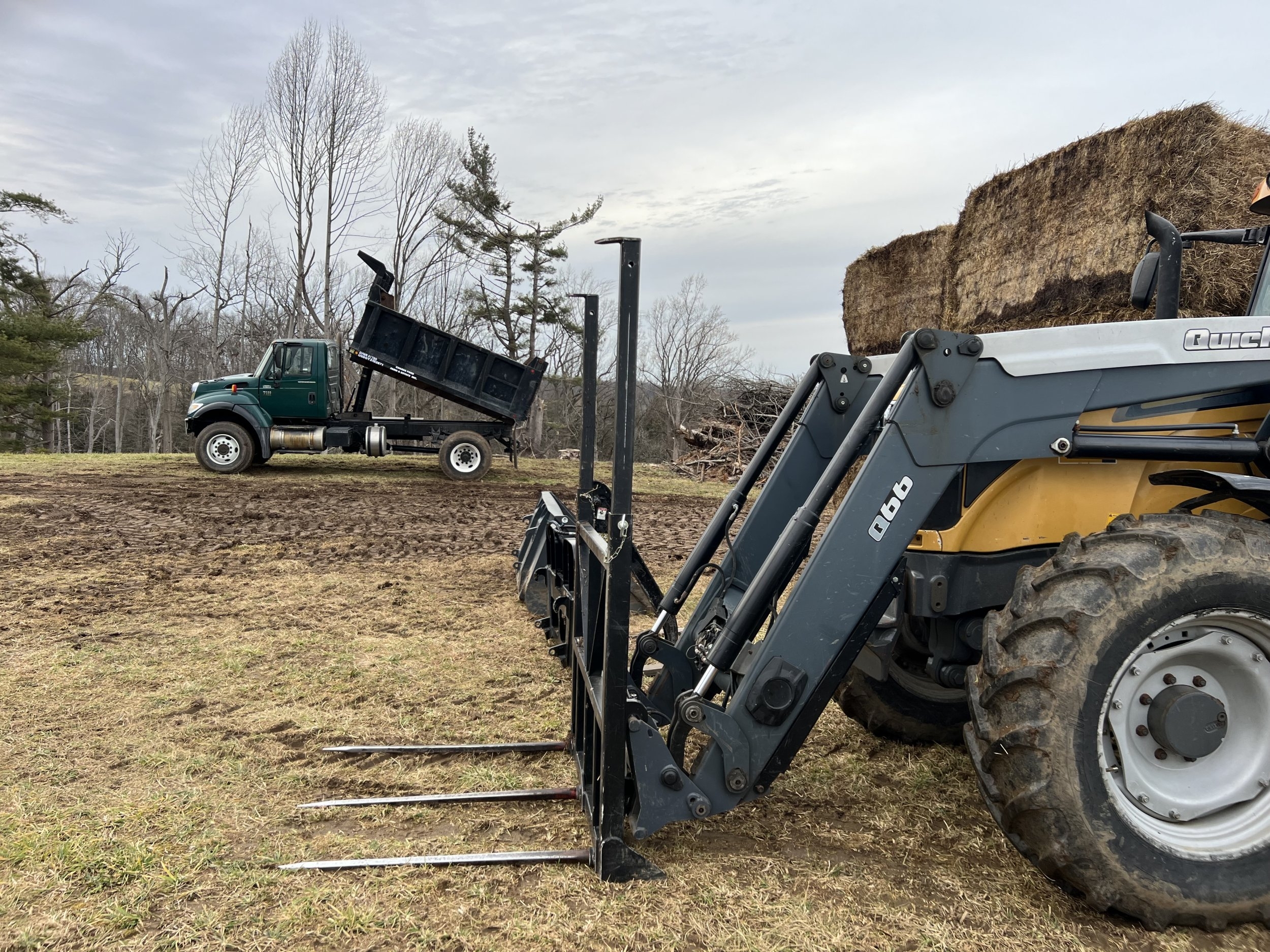

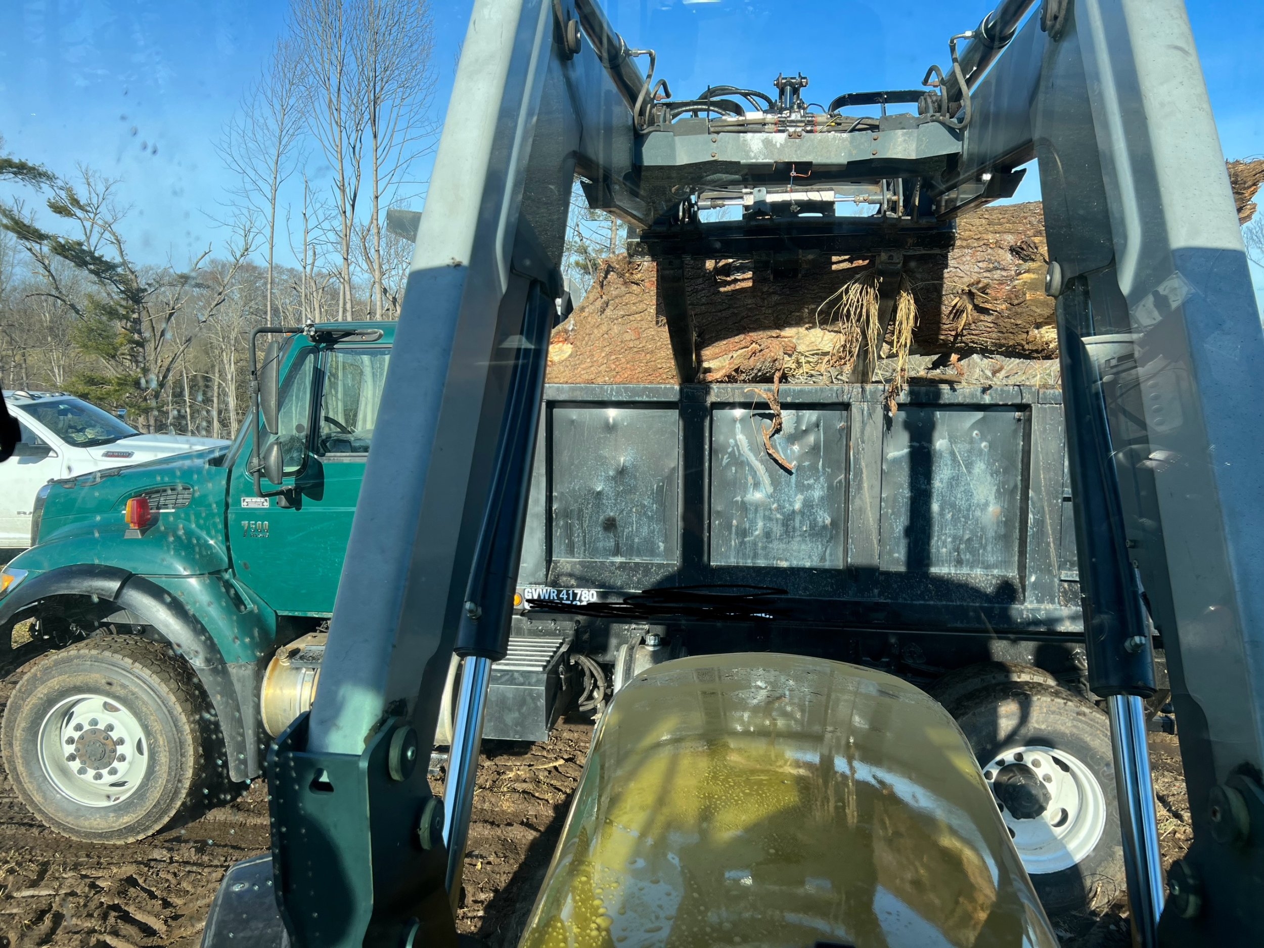

I was able to get this large pile hauled away this week.
This is about 1/2 hauled away.
Loading another of hundreds of logs.​
A few hundred feet ahead, you can see the next pile to be moved. Beyond the lone survivor evergreen is yet another pile.

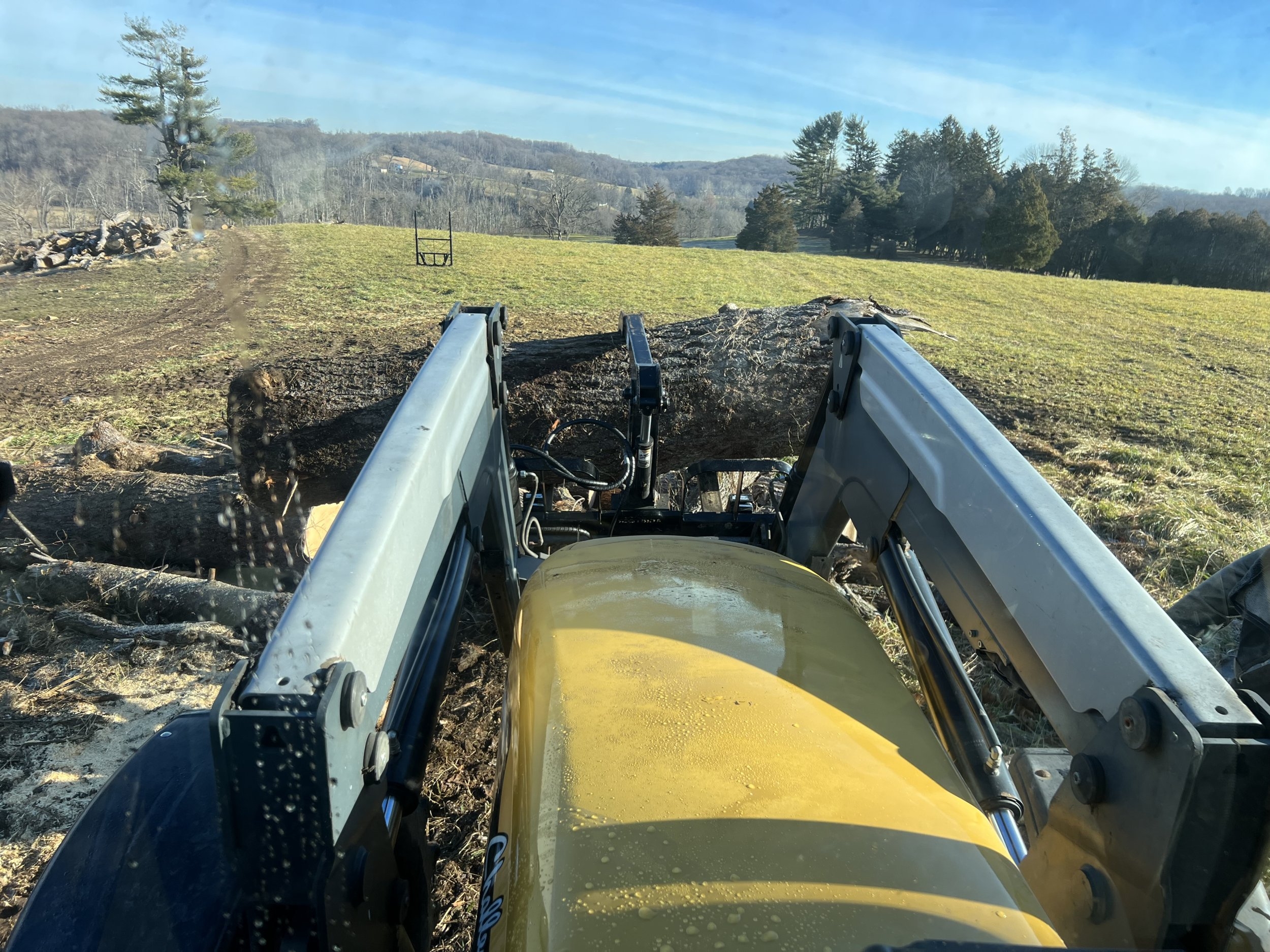

By the end of the week, I hauled all of just this pile off the Customer’s property. I brought some square bales up in the last day of nice weather. We are supposed to get rain & snow and very low temps in the next 5 days. These bales were way down in the hollow and will be tough to access if we get buried in snow.
The IH-7500 truck performed well, although I do have a drip coming from my transfer case cooler. Tightened it a few times, but it’s still dripping.
