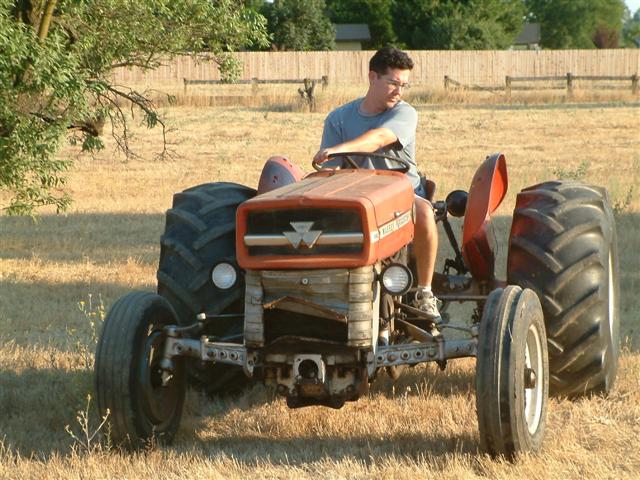

I paid $3600 in Jul06 for my 1964 MF-135 diesel. It runs OK (needs a water leak fixed now), but was pretty dirty and the front grill was beat up.
The MF 35 is an earlier model, gas. So if it's in really, really good condition, maybe $2500-3000.

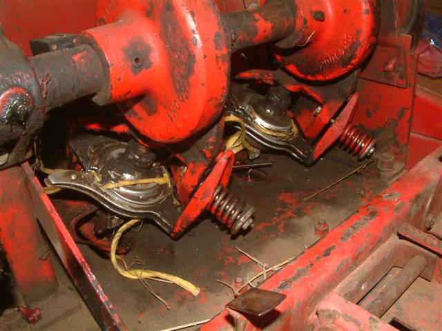

The knotters on your MF12 baler are quite a bit different from the ones on my 124 shown here.
I don't have a photo of the MF12 knotters, but, IIRC, they look more complicated than the 124 knotters you see here.
Do a TBN search on "baler" and you'll get a lot of good advice on baler maintenance.

Yea, the #12 baler looks alot more complicated than yours. Seems that you have plenty of room to work on knotters and see if there is a problem without disassembling alot. Thanks for the advice.

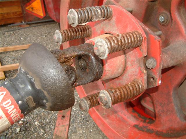

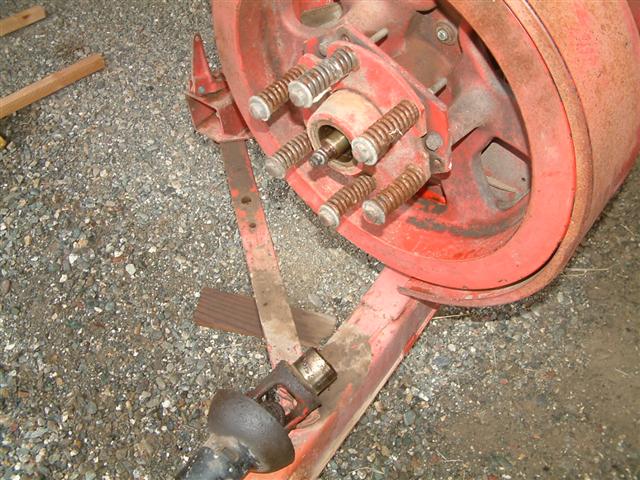

SG: thanks for that info. It's really timely since today I disassembled the slip clutch on the MF124 baler.
The pto shaft plugs into the sprag clutch inside the hub of the slip clutch.

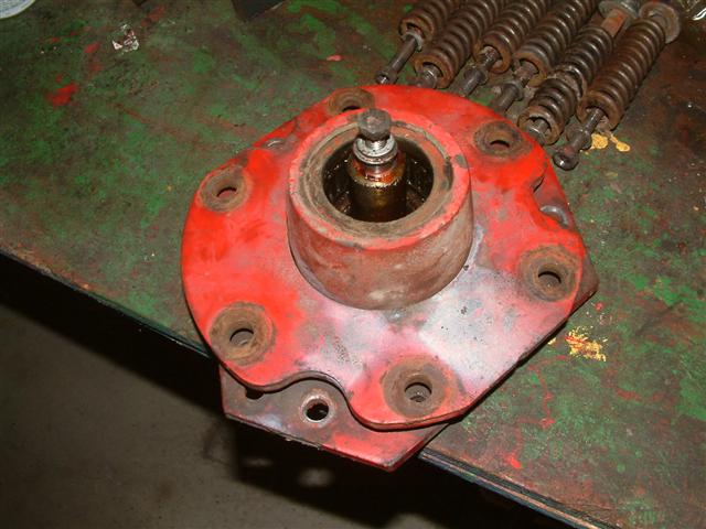

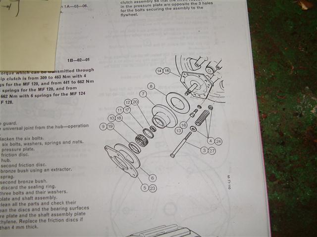

There's supposed to be two friction discs (#6 and #8) sandwiched between the drive/driven plates. Those discs have been worn down to nothing.
With nothing left between the plates, I could do short bales (24" long or so) OK. But when I tried to do a full length bale (~45" long), there was so much resistance in the baling chamber that the slip clutch started slipping.
I think I have a vendor for new friction discs. Hope to hear from him tomorrow. If not, I'll try the MF dealer in Chico. Don't like to do this because prices are high.
I may be using your suggestion if nothing else pans out.
