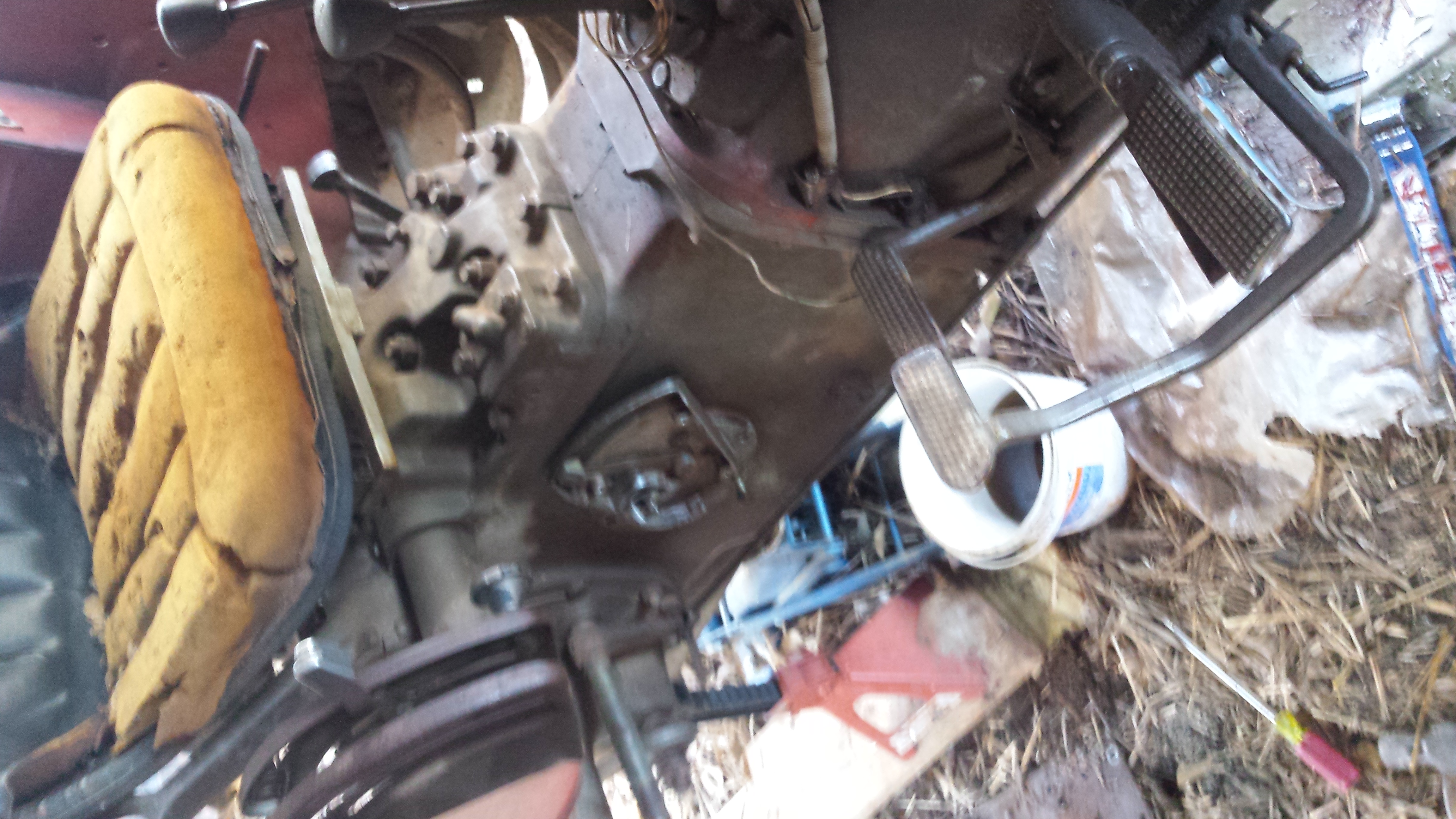

Im band new to the tractor world. I recently bought a home that came with a Massey Ferguson 230. I plan to use this to cut the large yard. I have started and driven the tractor but can not get the 3 point to drop or move.
I reviewed the manuals and see the there is an inspection plate on the right hand side where the dip stick is at. I have started removal of this but have no clue what todo once I get it off. One of the bolts is currently stuck. I have been spraying with PB Blaster.
I'll try to get some picture posted.
Any help with this would be greatly appreciated.

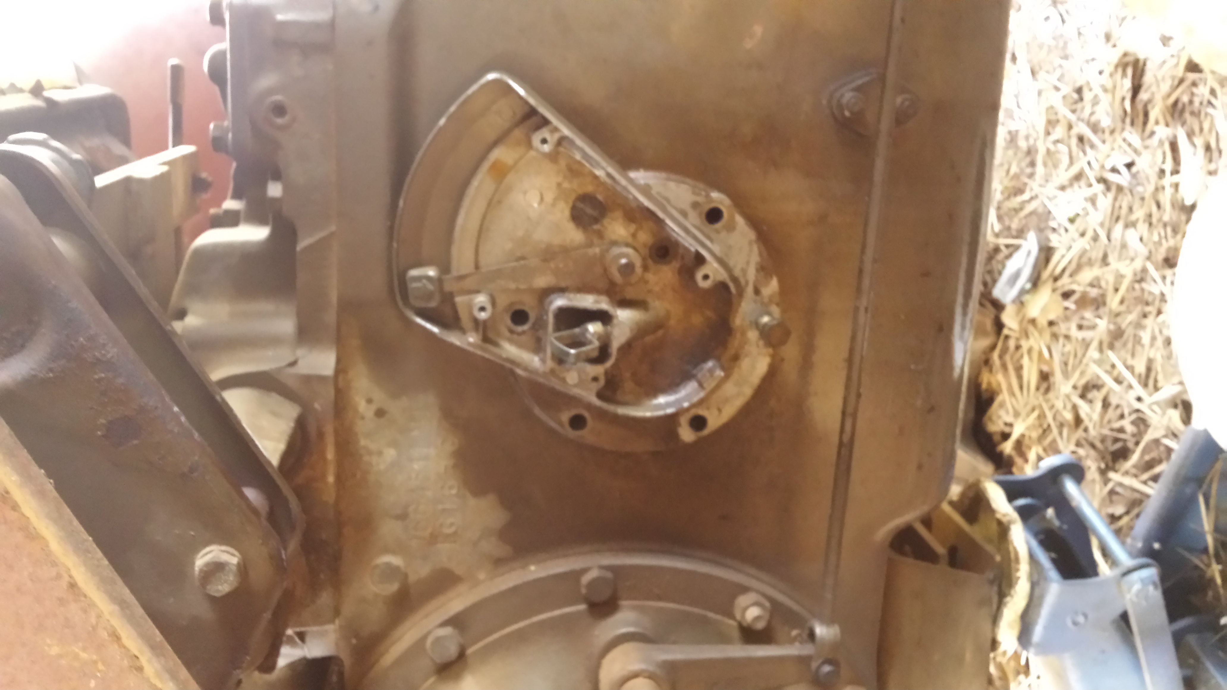

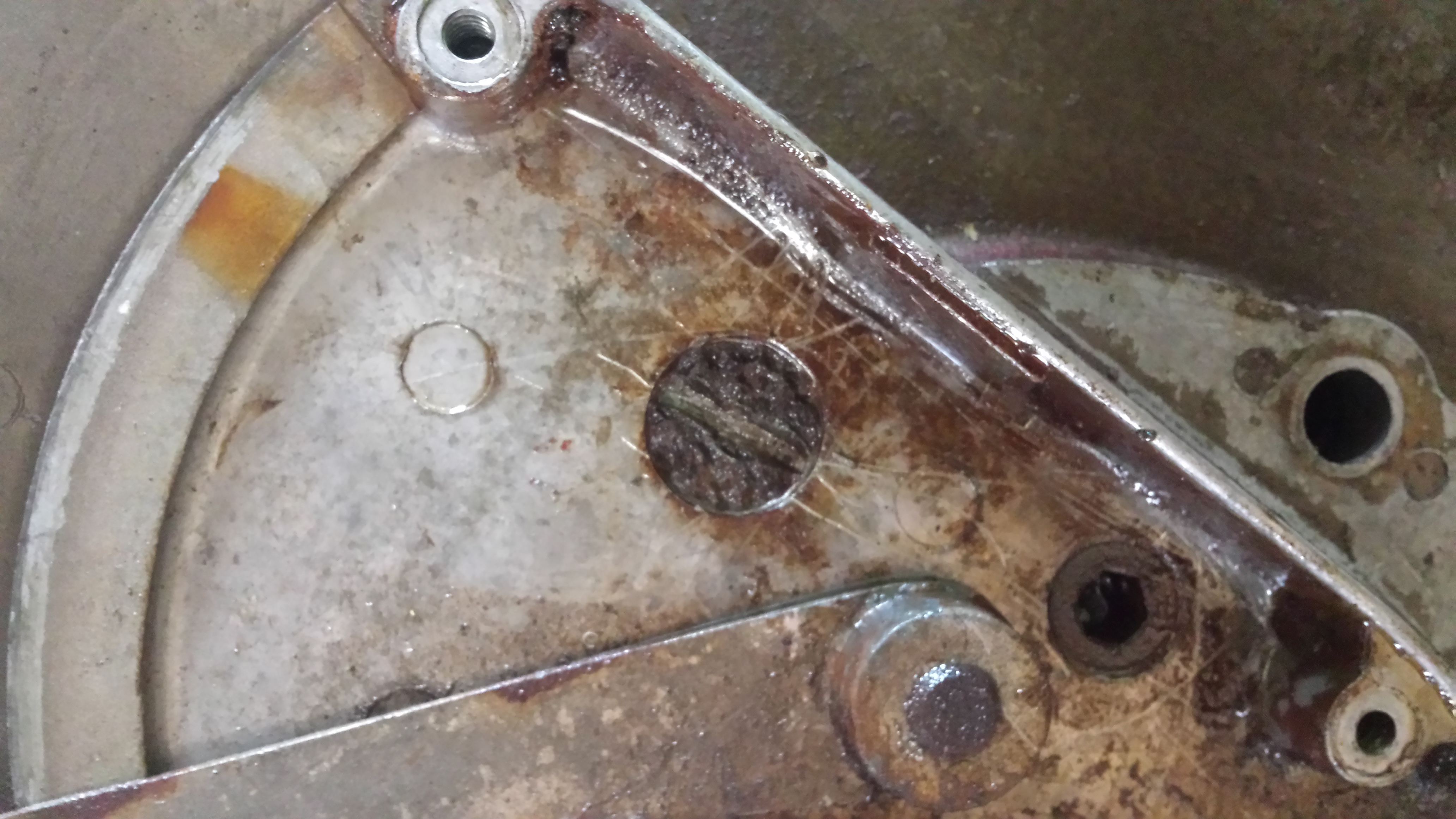

I still have had no luck getting the side Hydraulics cover off can anyone tell me if the bolt around the 2 o'clock position should be removed and what type of Bolt it should be I will attach pictures mine looks like a big rusted.

I have put the levers in every possible position and had two people standing on the arms. They dont budge.
I was hoping to remove the side cover to insure the levers are pushing and pulling on the pump control lever
