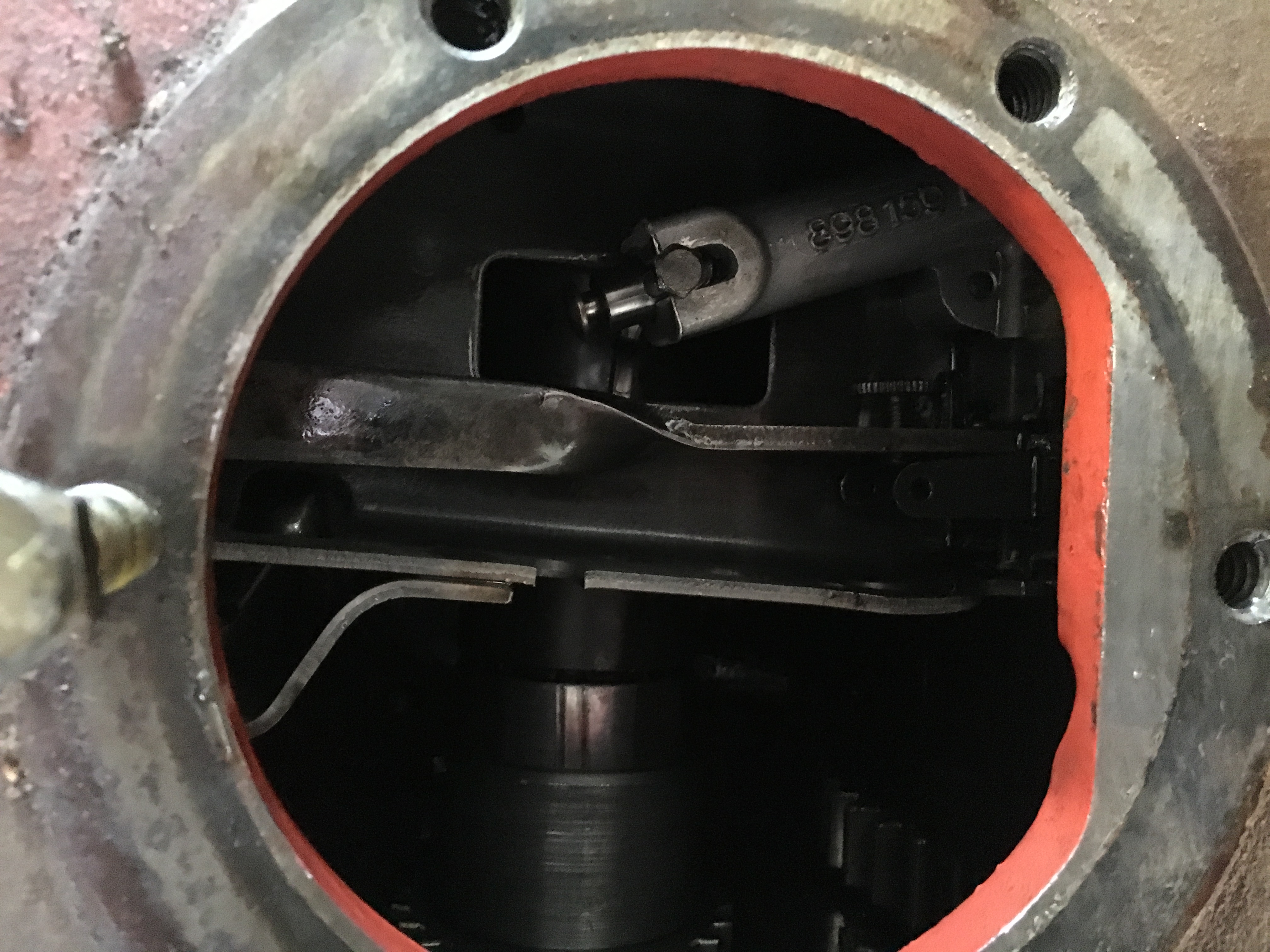

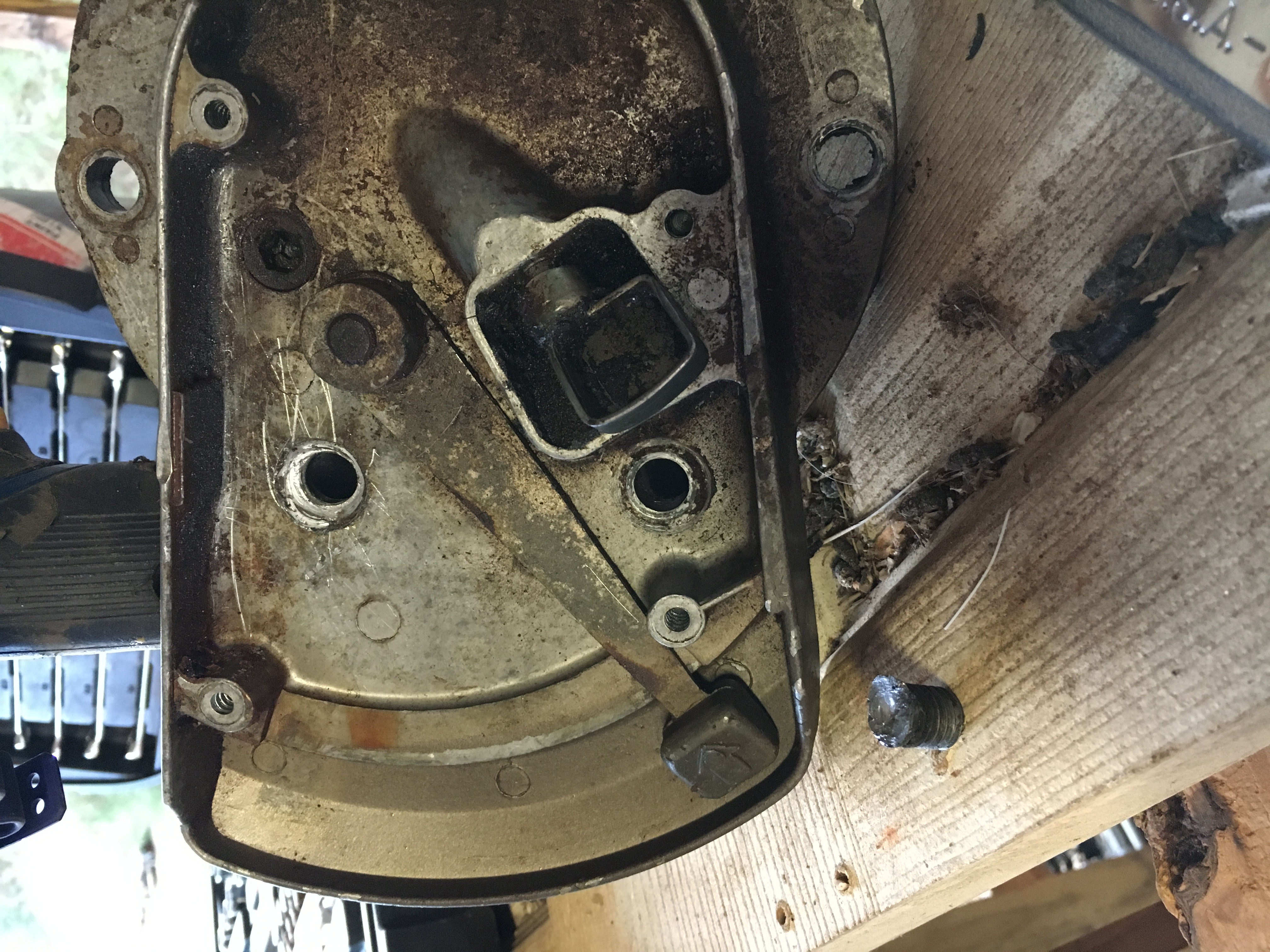

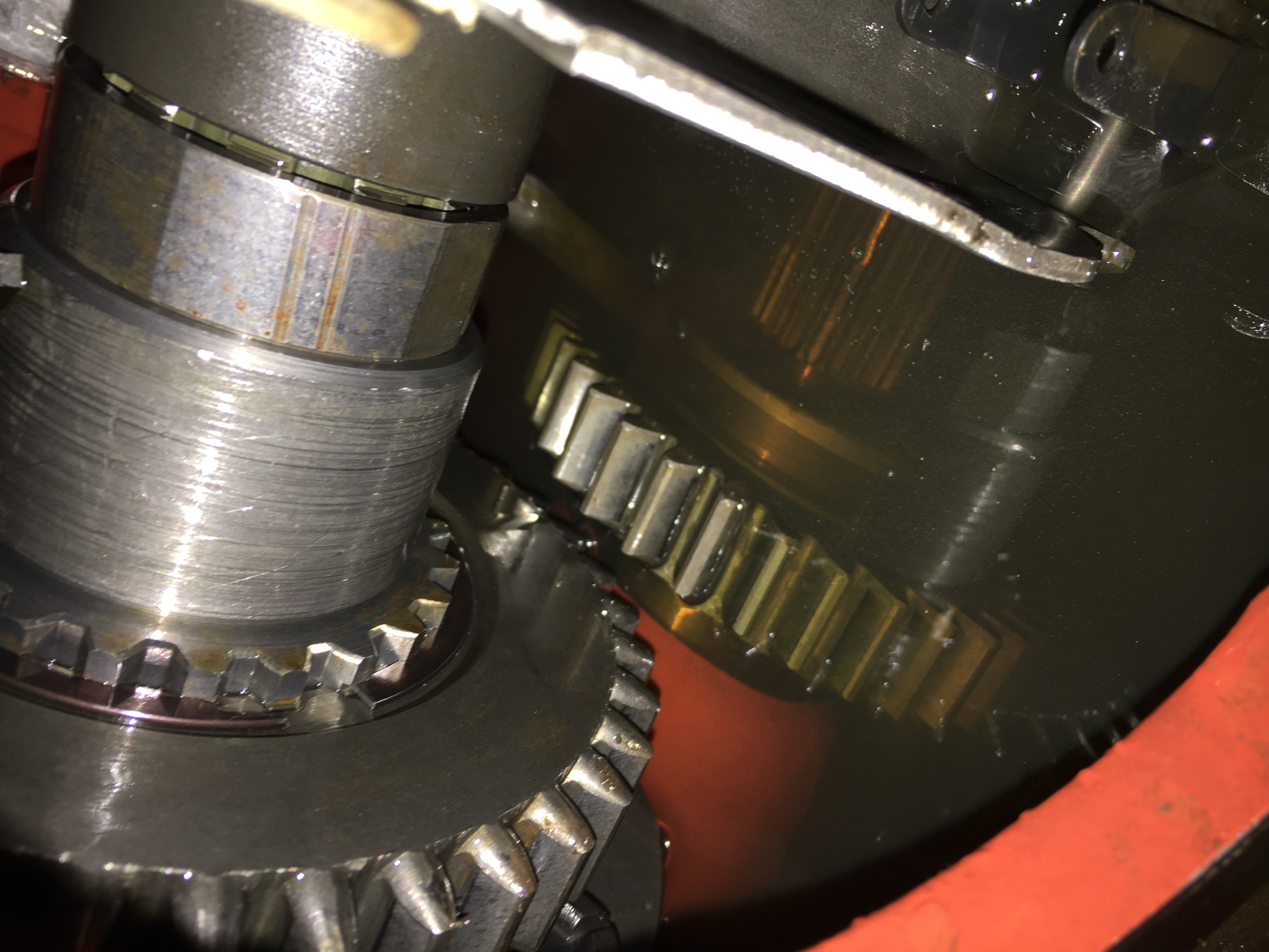

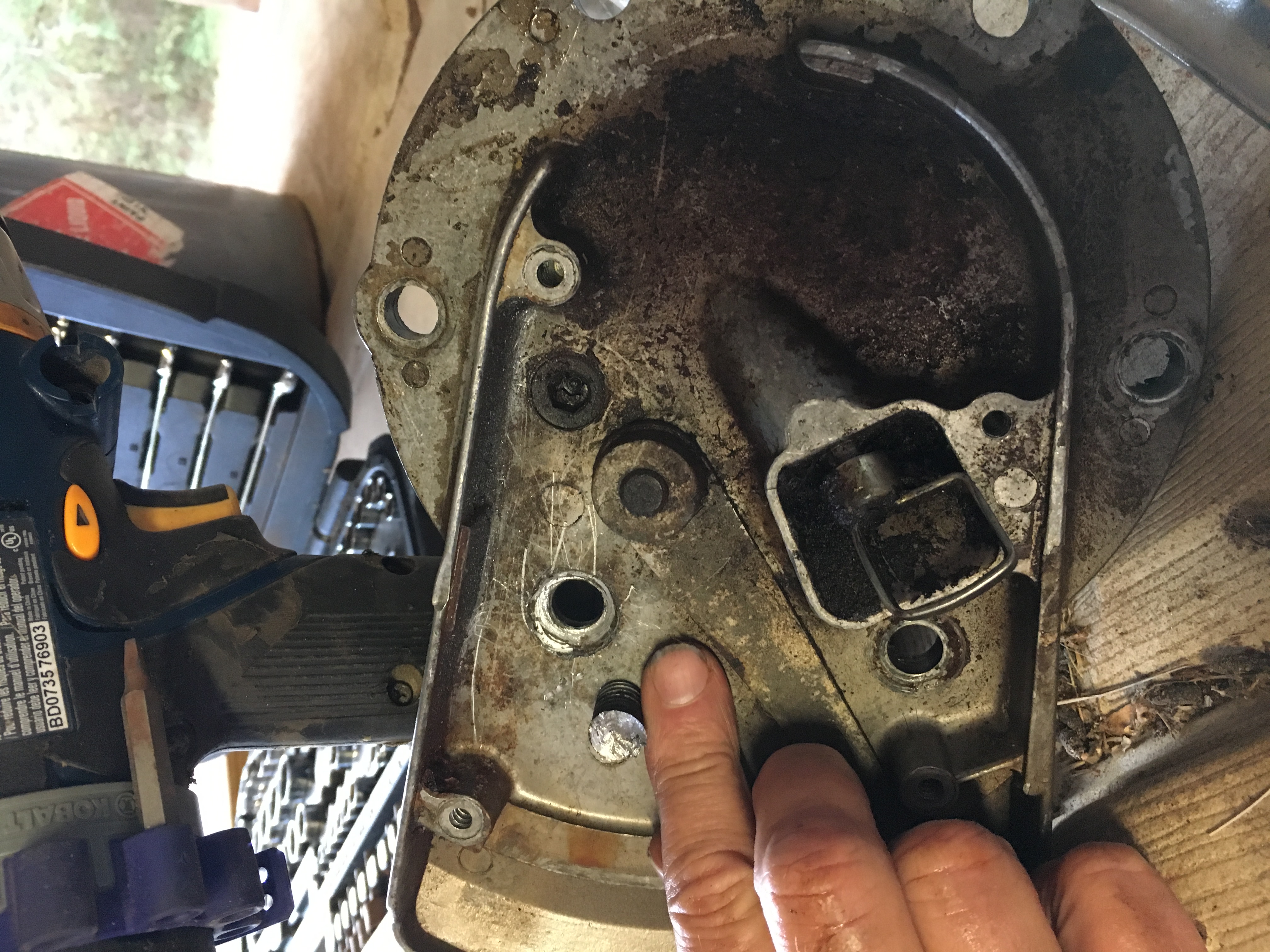

Well now its time for the good the bad and the ugly..
I had too end up drilling the bolt head out to get the side cover off. Once the cover was off the control lever was not really moving the plate/ roller wheel.
I view the video posted and decided to try and move the fork to see if that would do the trick to no avail. What I did accomplish was to dislodge the roller wheel and drop it into the case. :thumbdown:
Im now thinking the top cover is going to have to come off. the lift arms are still stuck in the up position with no movement when pushing the fork toward the rear of the tracktor.
I'm at the mercy of y'all and any help or guidance you can provide me.

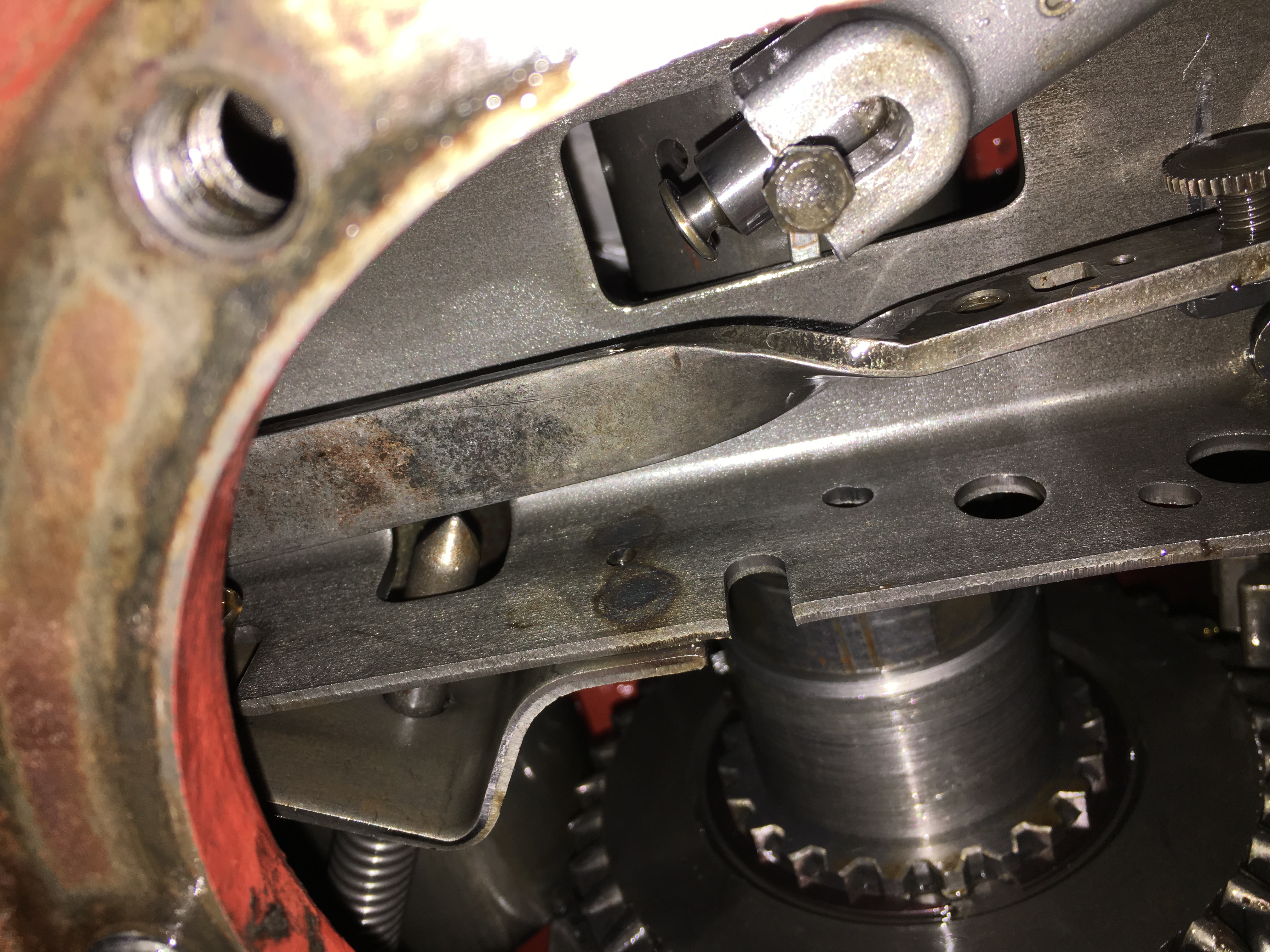

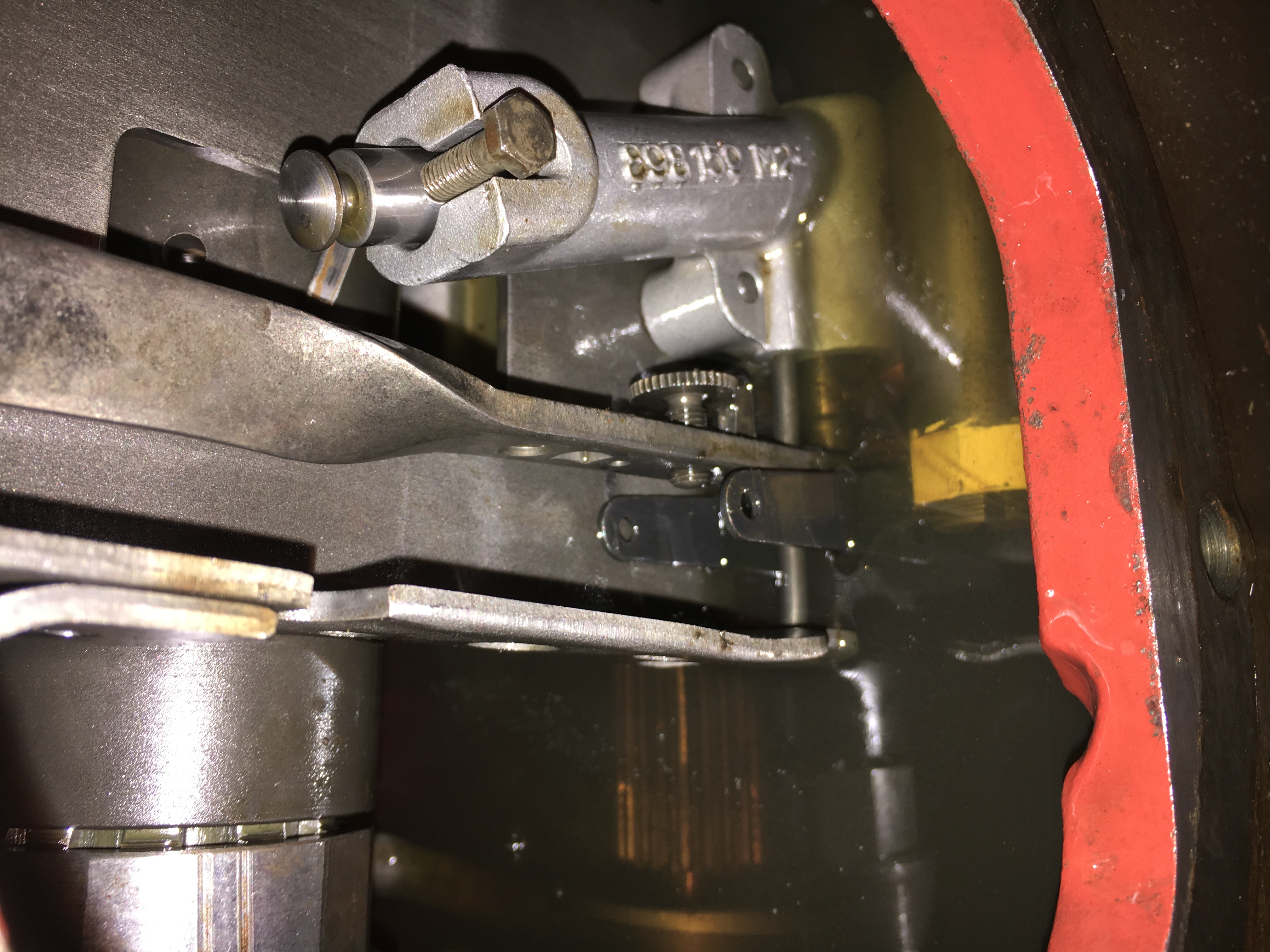

additional
