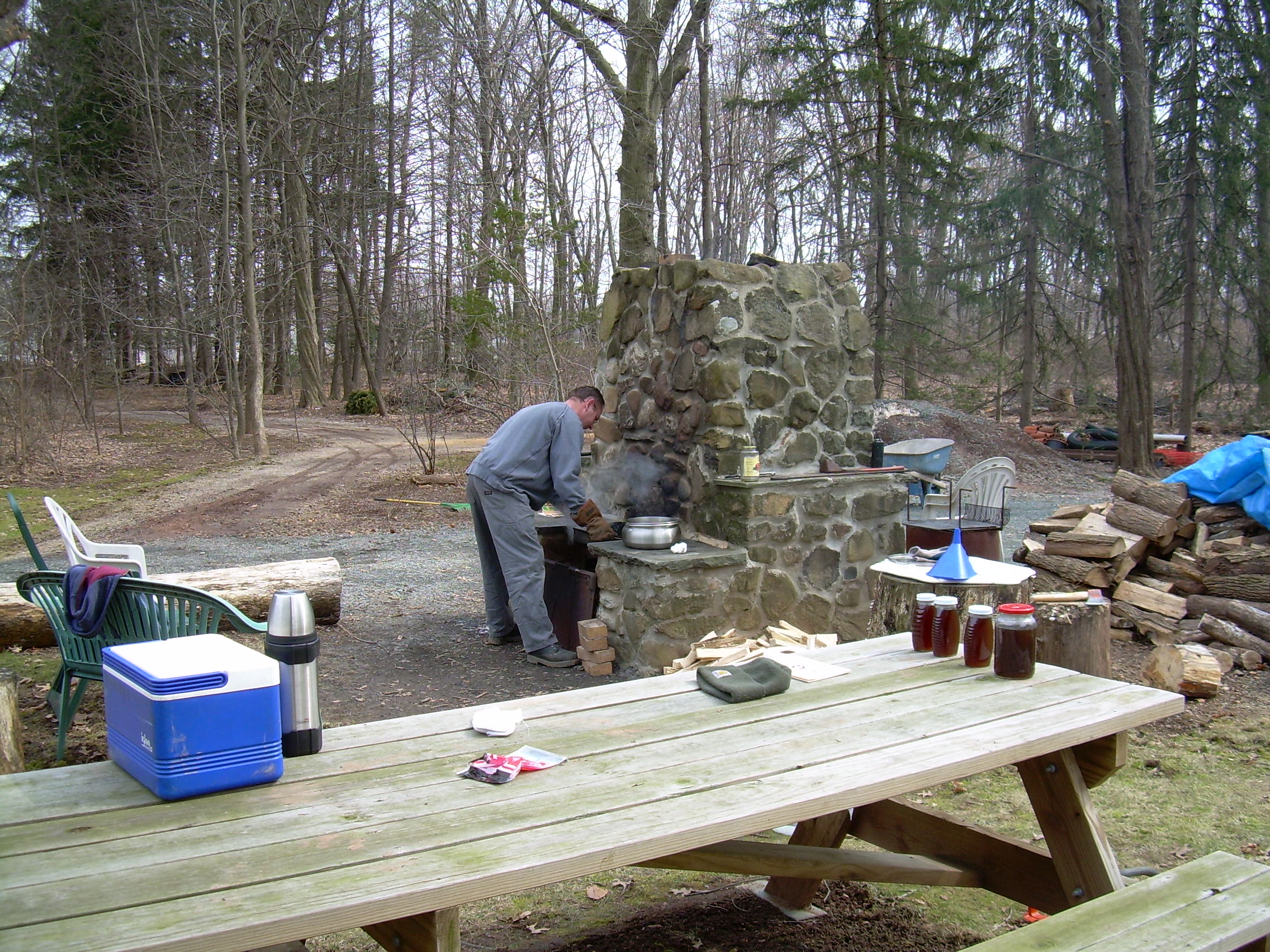

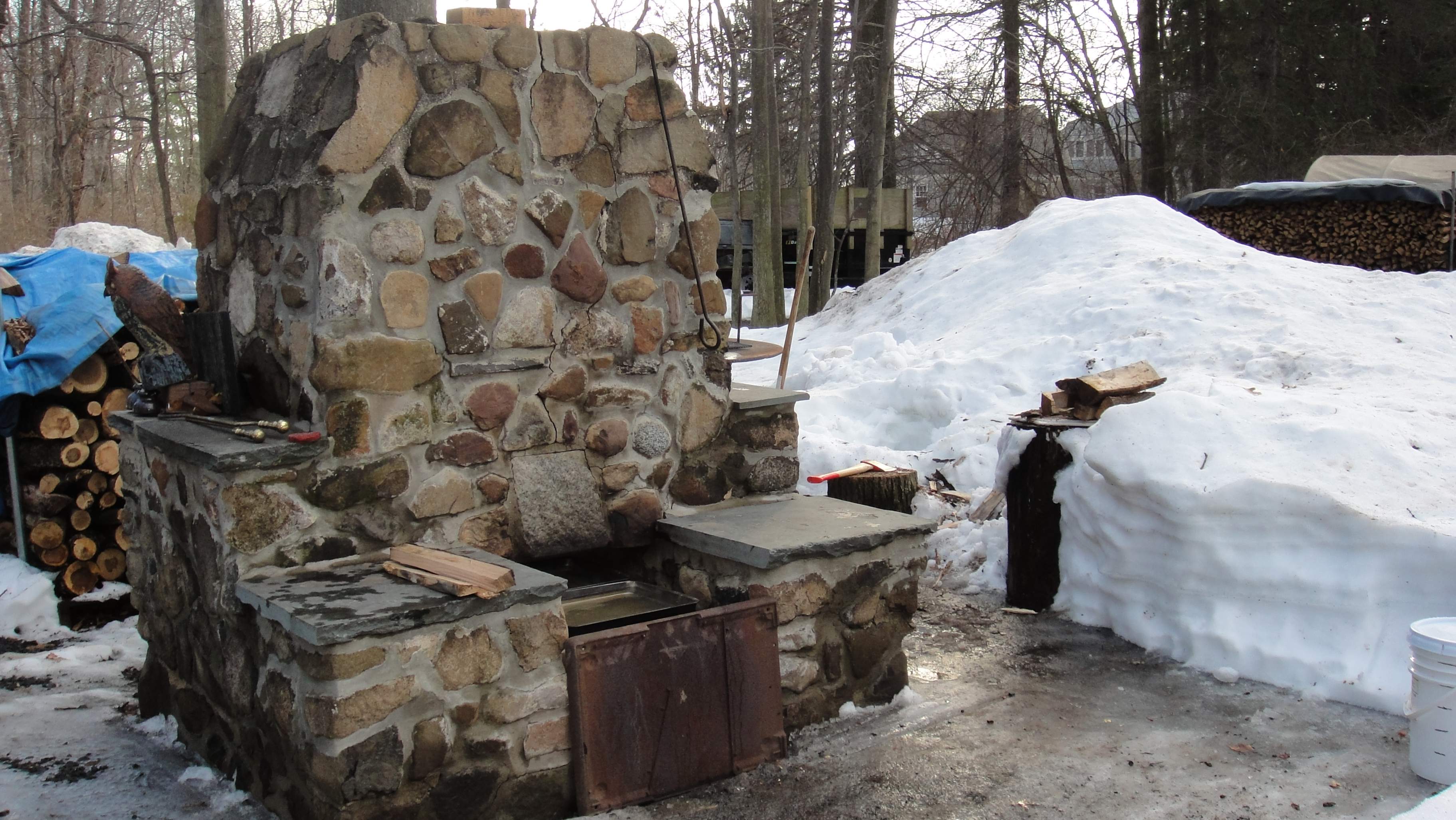

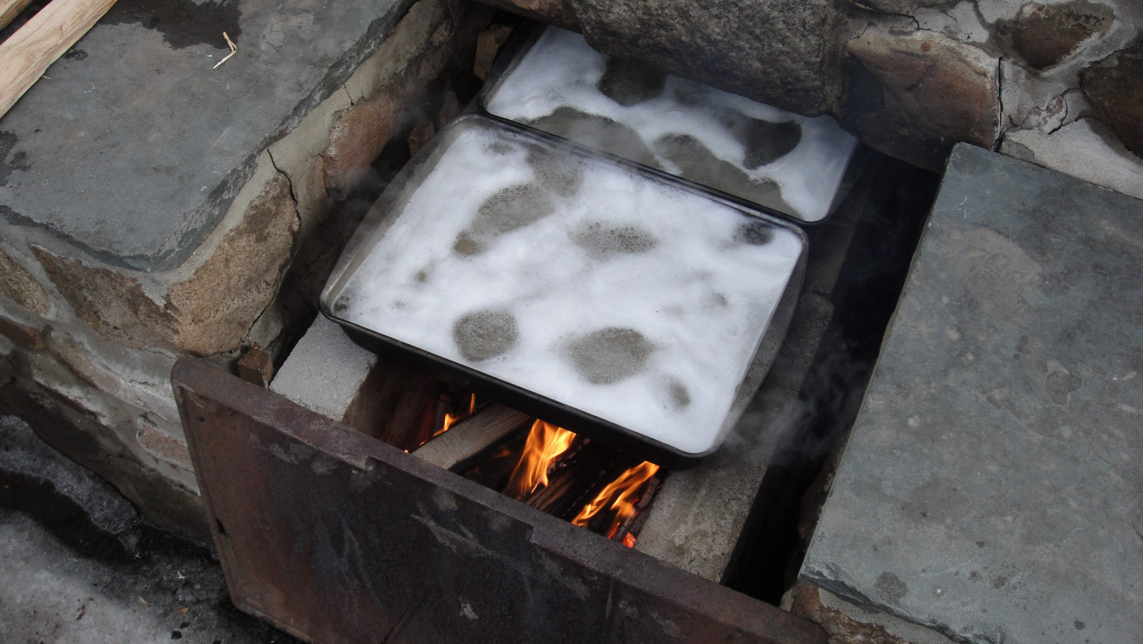

I've been fooling around with it for a few years, just for fun.
Last year I made over a gallon from just two trees, 5 pails. this year the sap is flowing already but I'm not collecting it, as I have no way to store it long enough to make it worth boiling.
Last year we had 4 foot snow banks to keep the sap cool/ fresh for a few days while I accumulated enough. this year it's freezing at night but the days are mid 40's and sunny no snow at all for my red neck refrigerator.
I do it on open wood flame, burning mostly red oak, with shallow pans, my way does make a little smoke flavor to the syrup, but no one complains.
My way takes a good 4-6 hours to make 2 quarts of syrup, but it's worth it as a hobby and plus we love to eat it.
Good luck,
JB
