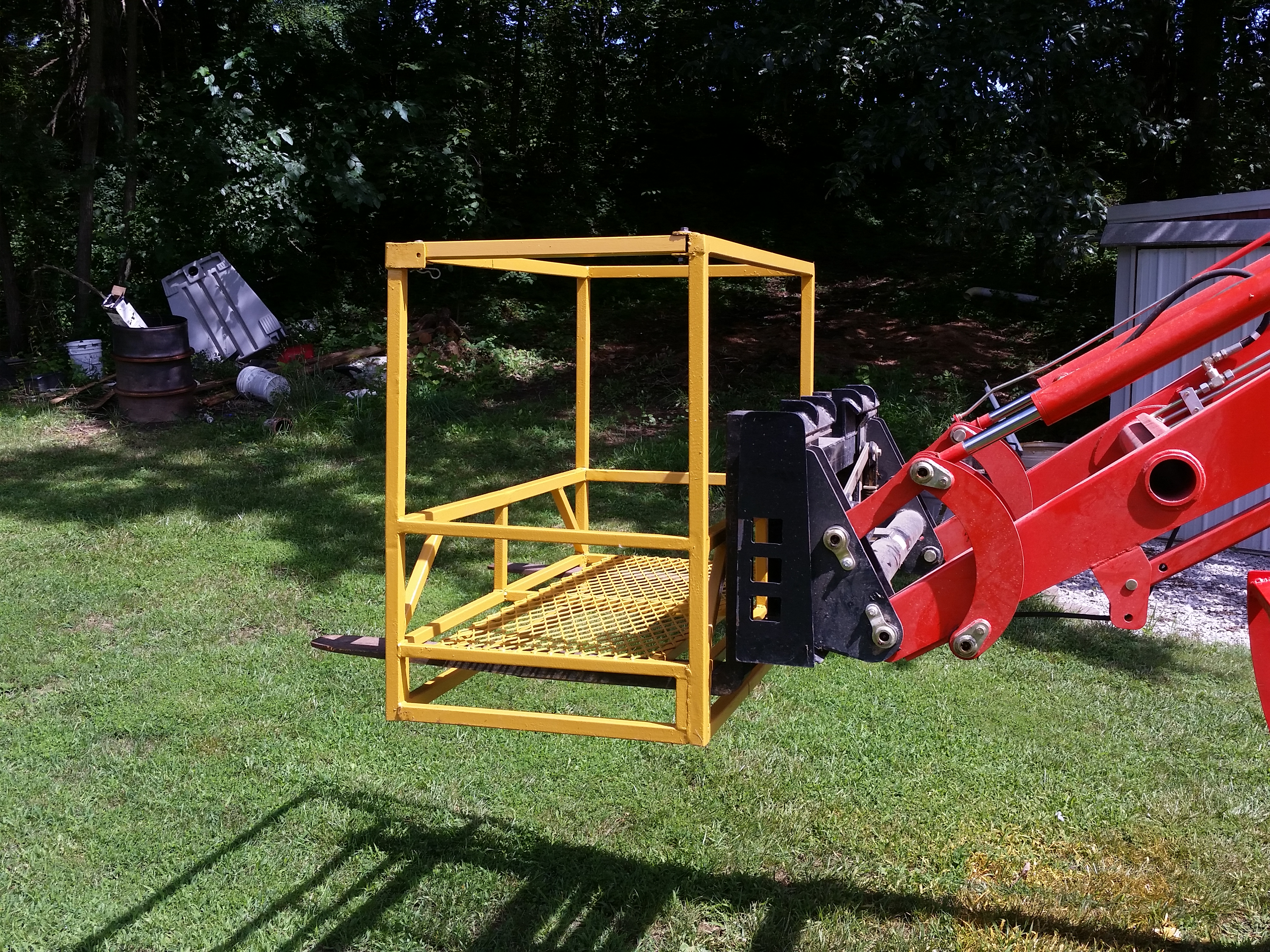

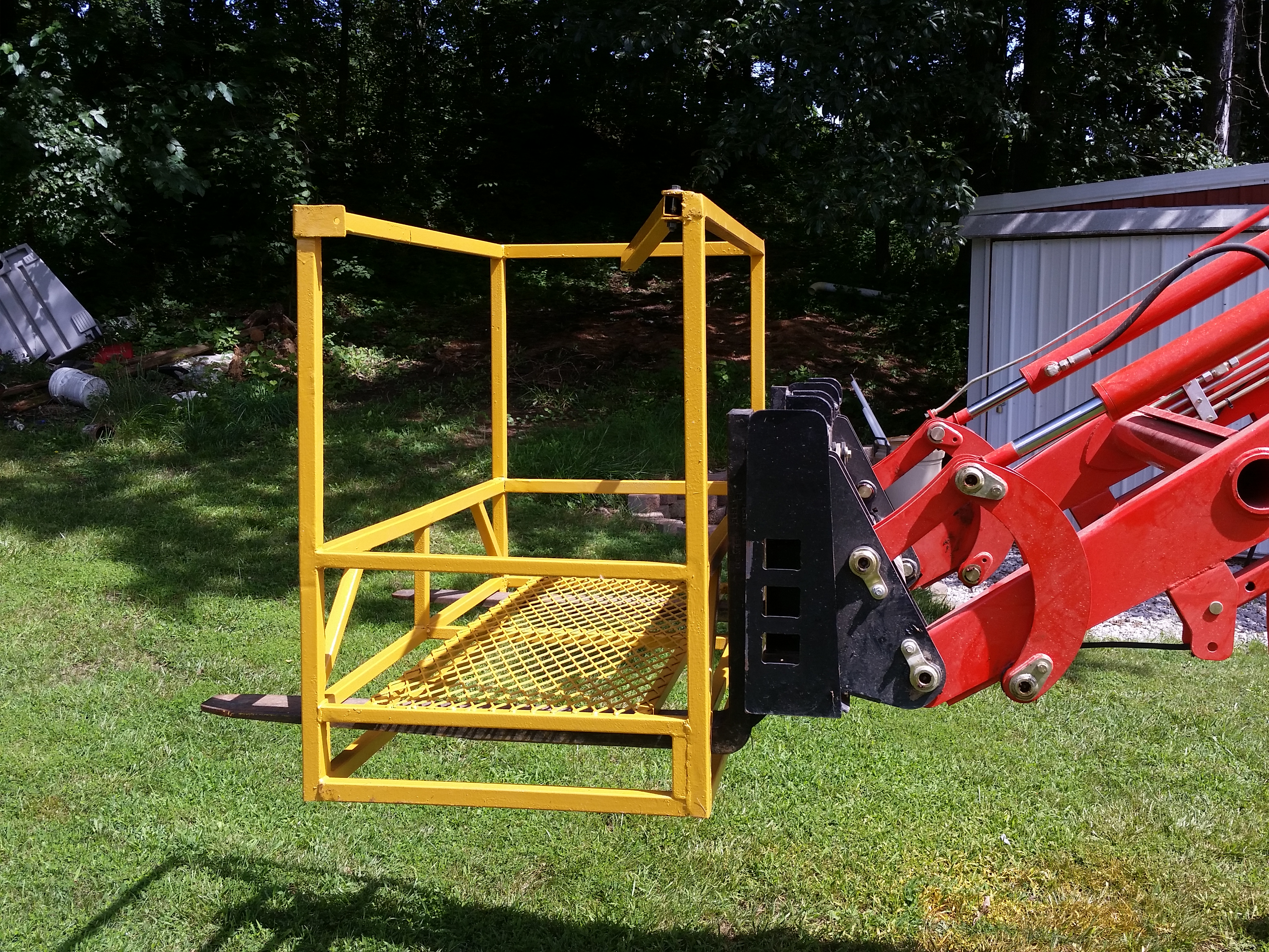

20160709_114539.jpgI squeezed in some free time And decided to weld up a lift to fit my NX4510 forks. Back in 1986 I had a new Ford Ranger and had a local welding shop make me a lumber rack. Around 1995 I put the rack in the woods. I was surprised it wasn't rusted bad so I yanked it out of the woods and began cutting it up. Used almost all of the pieces and only had to buy metal for the top rail. I made it to just fit barely span the forks and have the forks extend beyond the platform. I made a center attach point to attach to the tractor and harness (It is just siting in the pictures). Then brushed, primed and painted King Cutter color since I already had a gallon of that paint. Turned out decent. I'm happy.

Can I borrow it? I have some tree trimming to do... I just need to to deliver it to MD then pick up up, when I'm finished with it.
/ Man Lift revisited #3
Looks good, I've been wanting to build one just haven't got to it. I have the expanded metal but not sure I want that for the floor or to use a solid tread plate. Used a few with the solid bottom and some scissor lifts and nice to be able to set something down with out worry of falling through.

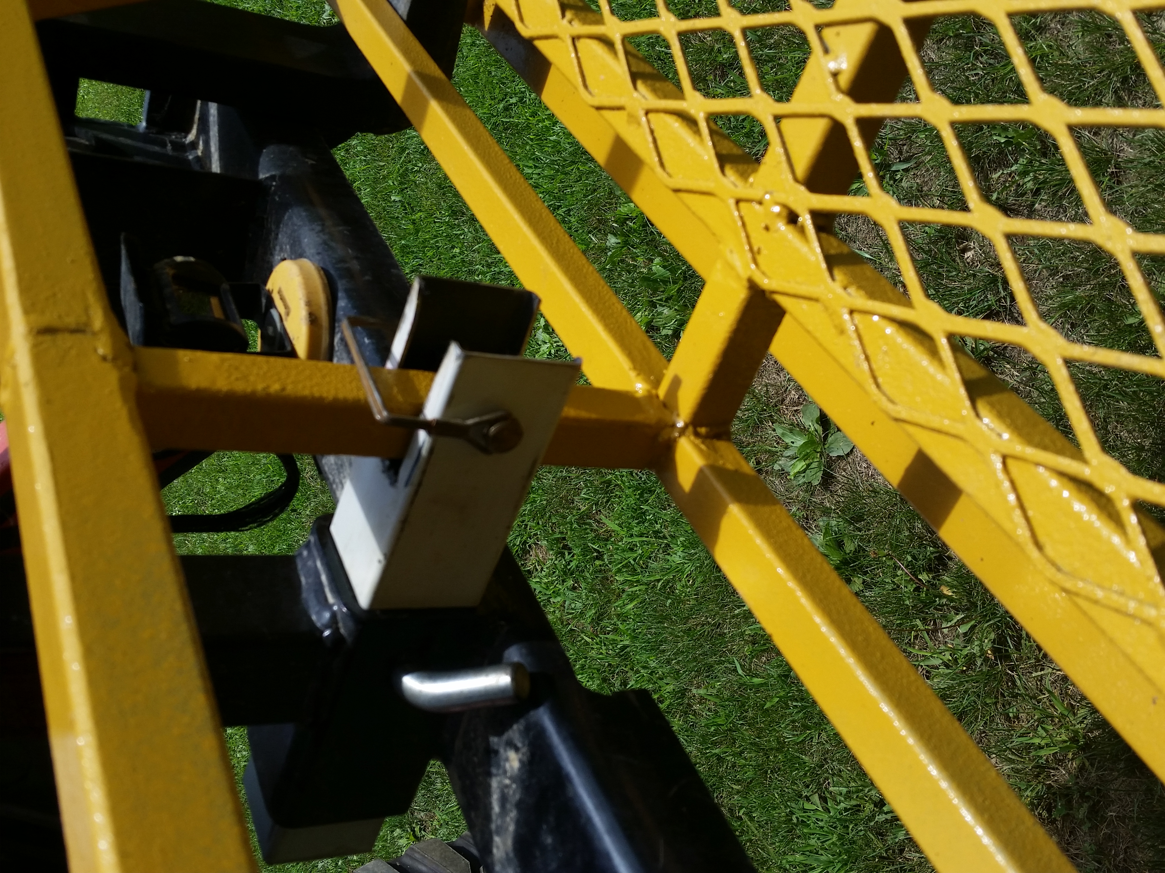

Decided to make an attachment using the trailer hitch receptacle instead of a strap. Need to paint it black.

I like the hitch on the forks... I'm going to have to learn to weld and add that to mine.

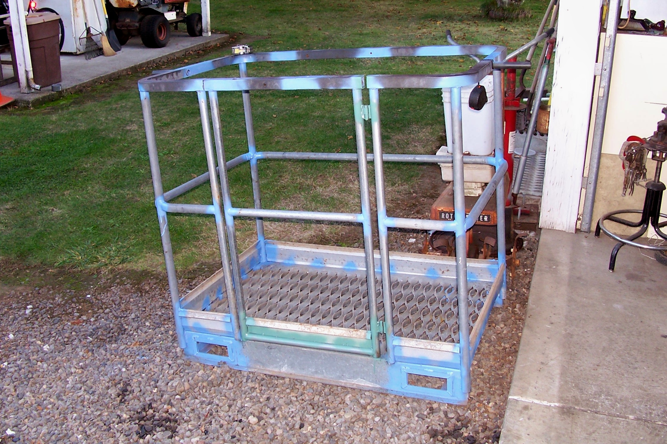

I built a basket a while back out of salvaged material I had laying around. The 4' chunk of catwalk was ideal for the base, the square top was from an old home gym that was by the road with a free sign on it, the 1.375 toprail was from a neighbor's fence I helped take down, the hinges are cut down house door hinges. Boxed the fork pockets with some old flat bar and tied the bottom together with a couple angle irons from a bed frame. Oh, and the toe rail is about 4" trim off some galvanized roofing that I kept; it's surprisingly rigid when tacked in. Painted the welds with some nearly empty rattle cans so it won't rust too bad. I have holes in the fork tips for a trailer ball and a hook, so those will prevent it coming off while in use.

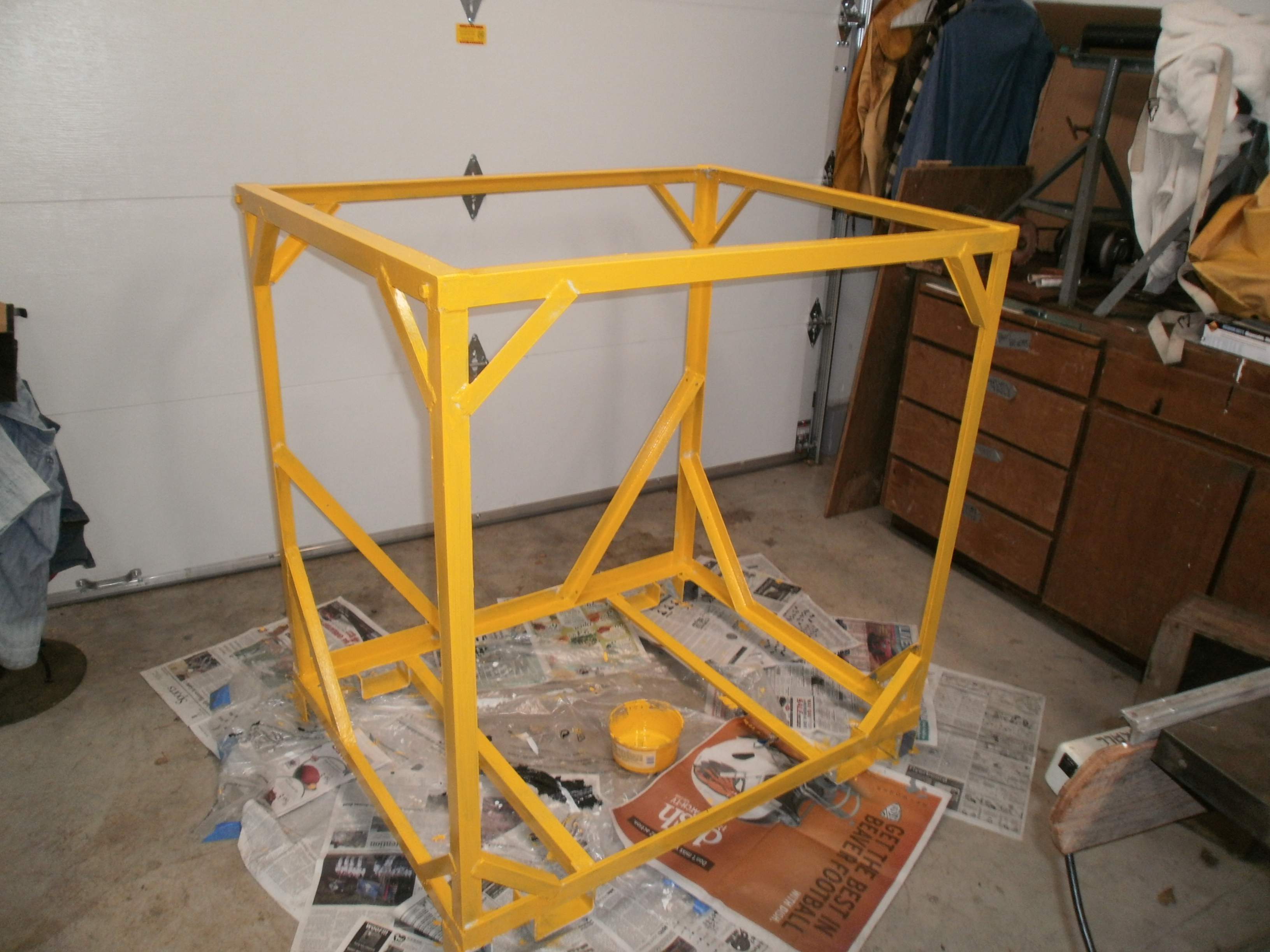

I had to offer mine... it is a double decker, I have it so I can reach a bit higher or lower which ever I need. Second level is held tightly with four c clamps. I hold the hold thing against my ssqa land pride assembly with ratchet web straps. The bottom began as being part of the frame of Woodmaxx chipper pallet. I added the rectangular tubing for the forks for a better and safer fit. It really works just great for us
