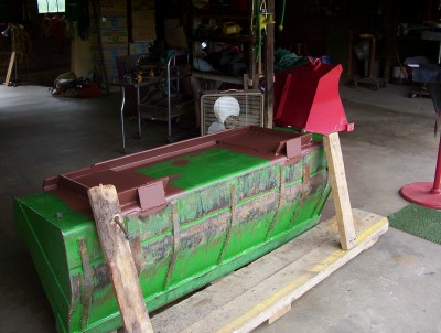

/ Making QA bucket? #5
Here is a small bucket from that I reinforced and added QA.
Pictures are not great, sorry.
The QA has the red primer on it.
Some of the metal I had to buy, other stuff I had, so don't know the actual cost. I do know that the QA is heavier and more rugged than the ones purchased.
I am using it on a 65 hp tractor, have used it quite a lot diggin' stumps, and have not been able to break it.

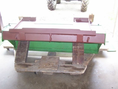

/ Making QA bucket? #6
In this pic, you are looking at the top. The green is the inside of bucket, and the bleached out portion is the back. Hope it helps.

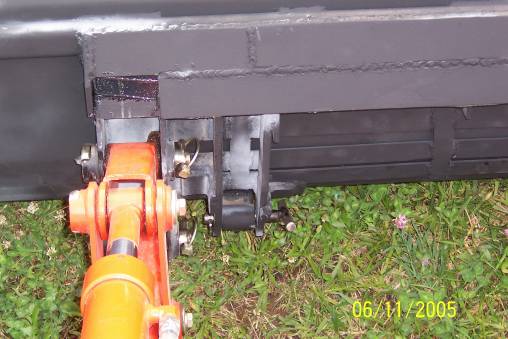

/ Making QA bucket? #7
I made a QA attactment for my loader on My CK 30. It has worked greated. when I slow down long enough to get my pallet forks put together and what ever else I can think of I will use it more. not sure how to post a link but if you click on my username and then somewhere is says see all of user post. then click on the heading under customization and see title "look what I did to my poor loader". I also will post a pix of a close up. mark
