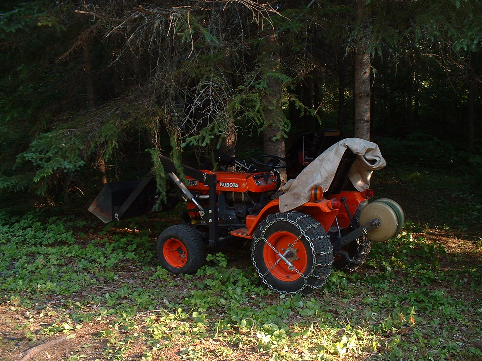

I too have made chains for my garden tractor and front and rear on the kubota. This photo shows the rear chains on the Kubota made with no special links (#30 chain). No paved roads in my area and not much wear in past 5 years of use. Paid under $1 a foot, though only needed 1/4 chain on the subcompact.
