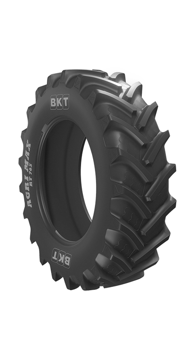

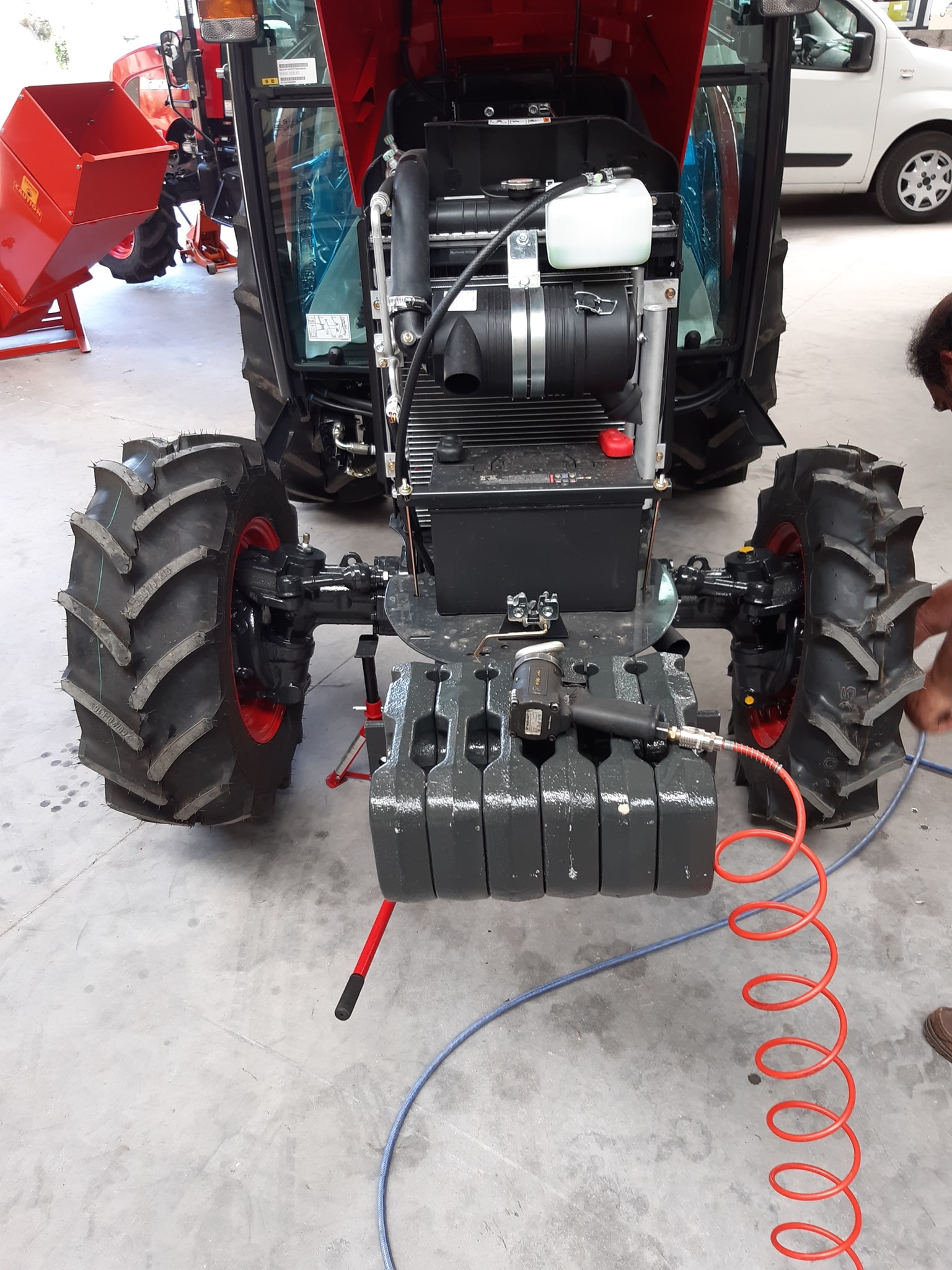

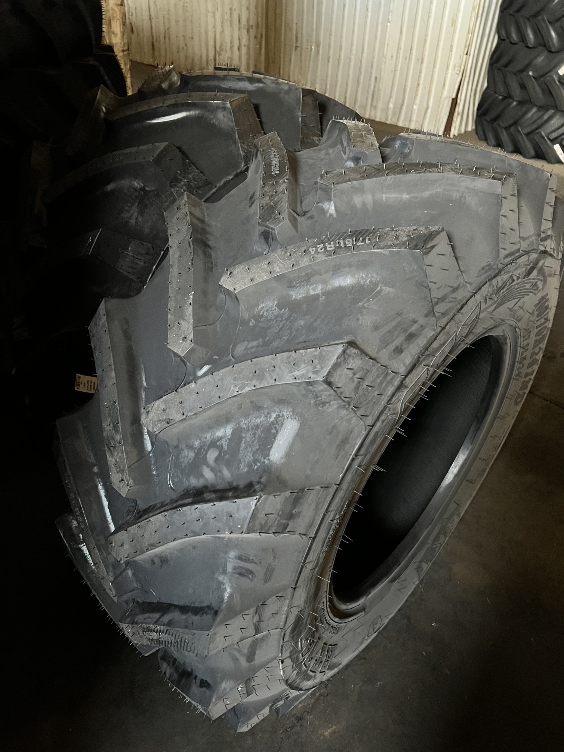

I don’t know what size your tires are but BTK makes the RT747 R4 tires that have a AG R1 tread pattern.
They are a radial tire vs bias ply.
Mine are 17.5/R24, so they are wide like how typical R4s are.
