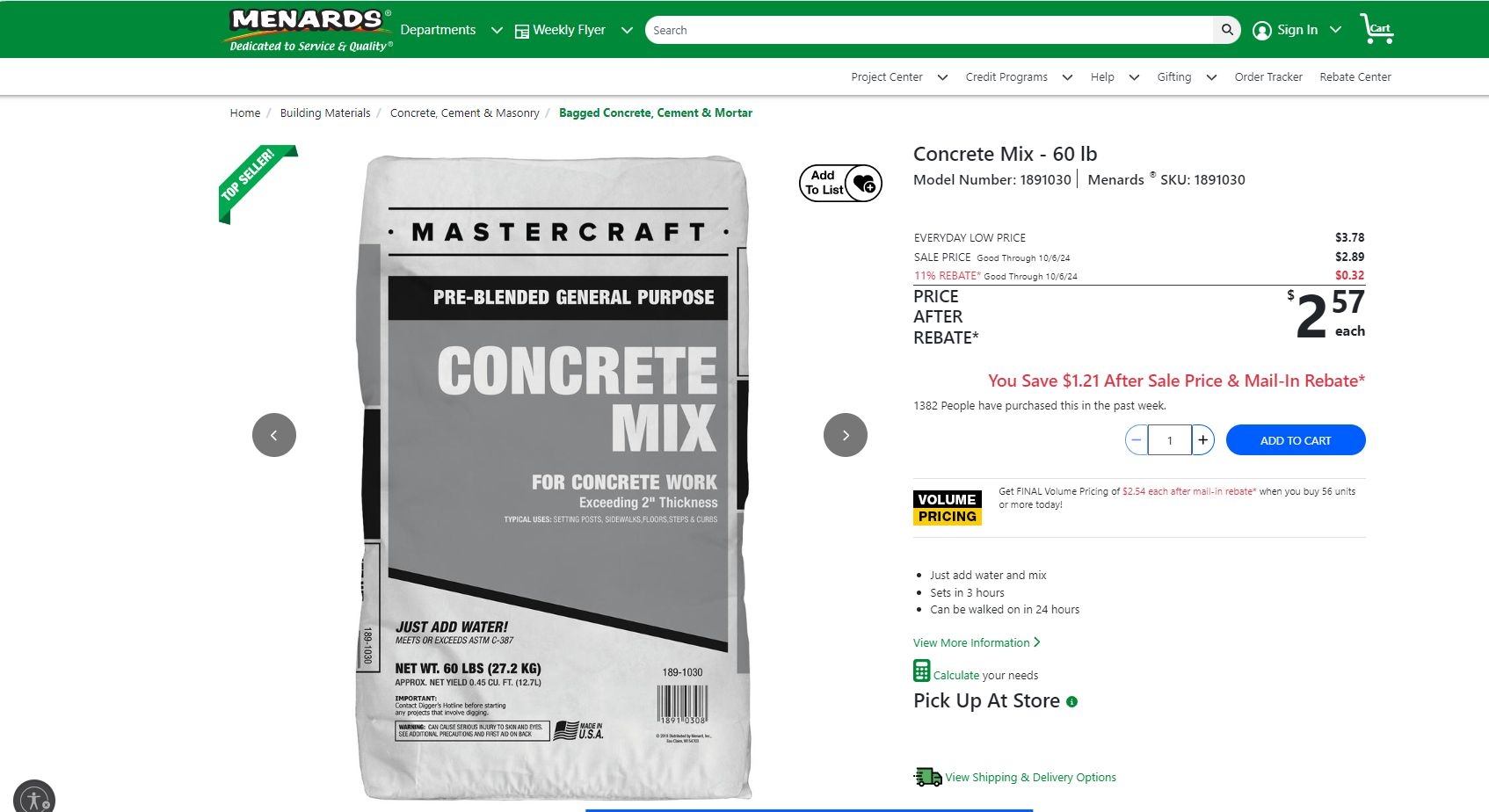

When I use that mixer I’ve always just used bagged concrete but it’s went up to like $7 a bag.
$2.57/60lb here.
Comes out to $150/yd

A couple months ago price was almost $6. I checked today and thought if it's under $4 time to move on it. $2.57 even better so picked up 40 bags.
I just read the fine print - Menards will knock off an additional $.03 for volume pricing. Huh.
That's really pretty good at $154.20/CY; but also a lot of work. Those new "Muddmixer" mixers look like they make it easier/faster, but there is no getting around it still being a lot of work.
