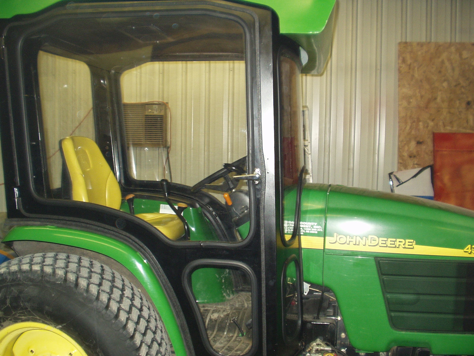

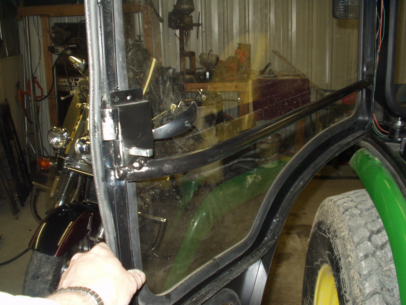

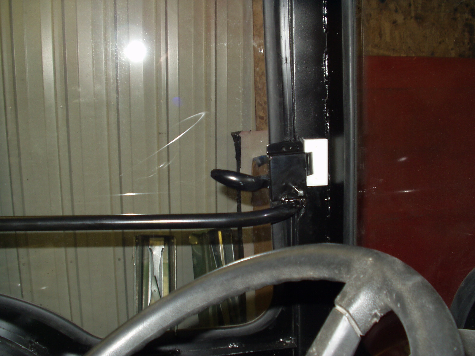

Not real good pics of my latches but here they are. I added a block of Polyethylene on the inside as a spacer for the striker to lock behind. The pipe you see was added for an inside grab handle as well as to stiffen up the door. It had a lot of twist due to the narrow area that I had to mount it on. I should have made a wider door handle area but didn't think far enough ahead. When I closed the door, you could flex the handle forward and back. The grab handle made it ridged and latches very secure now.
Where you are using square tube door frame, you should not have the same problem needing to add support.
Rick

Regal... thanks for the pics, I like the grab handle, you can get it different places as the door opens and shuts.

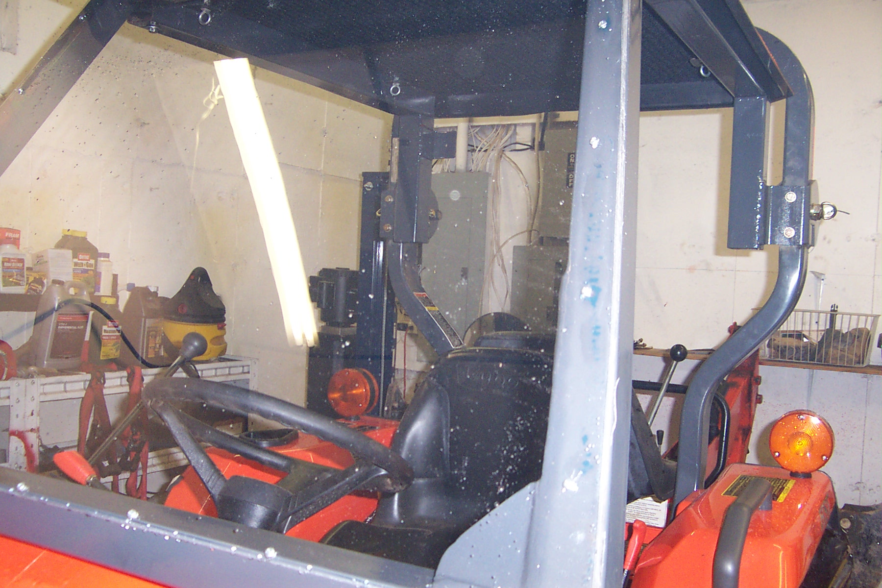

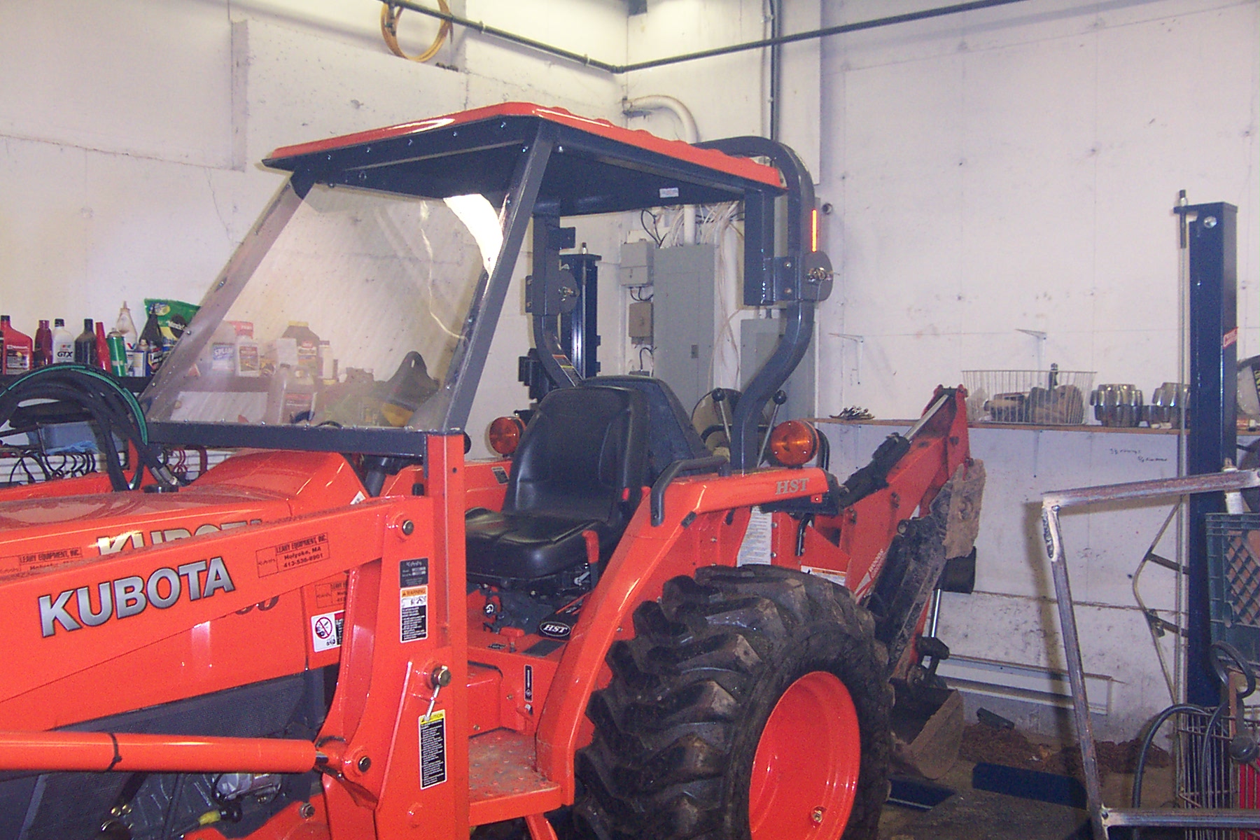

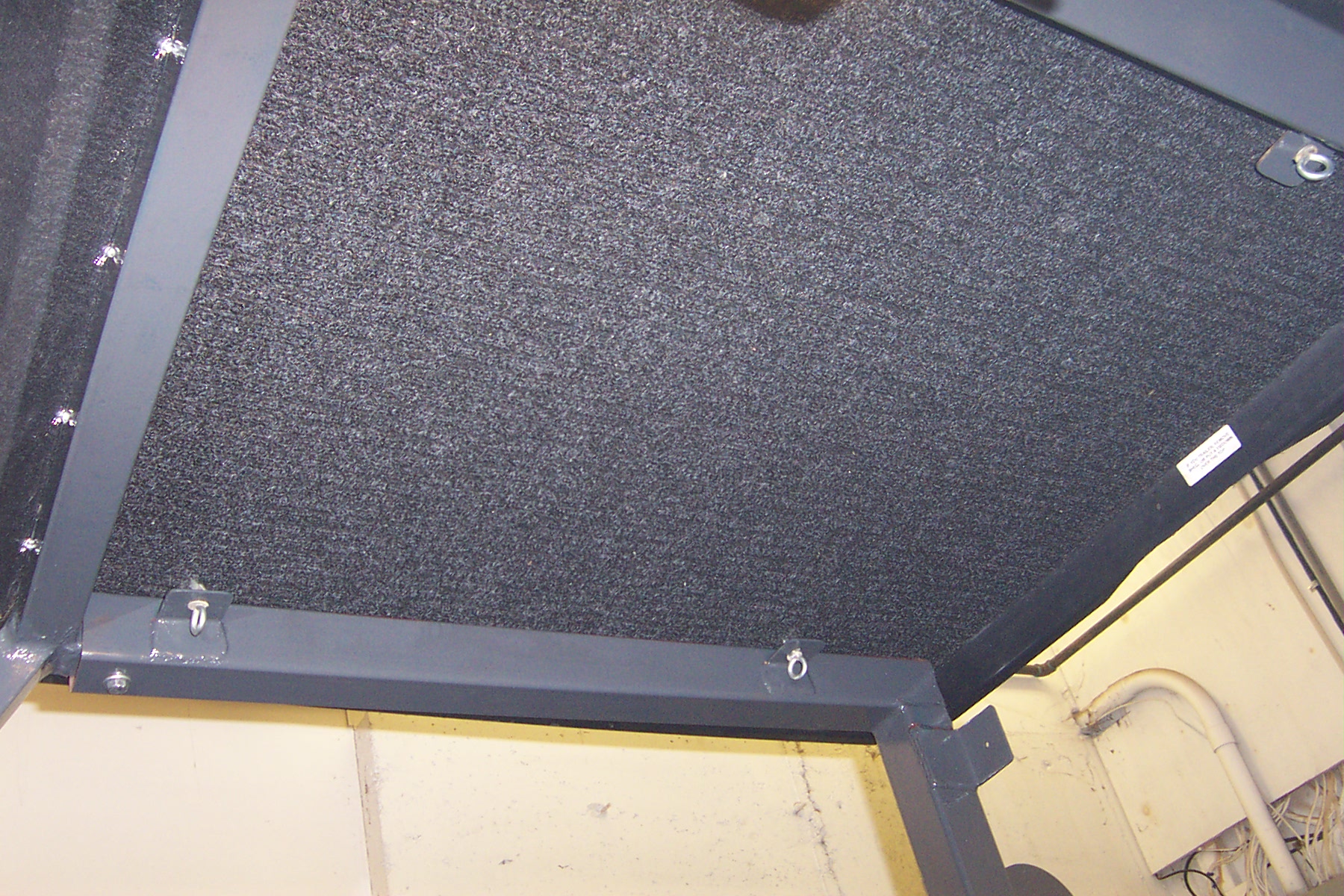

I bought a 3 x 4 carpet mat and glued the rubber backing to the inside of the top to lower the noise level in the cab. It seems to work well.
I have the frame painted up and installed the lexan glass.
I like my grab handle. You need something to hang onto as your climbing in anyhow. This just allows you to pull the door closed behind you as your getting in. Smooth.

I also like the carpet mat. Great color match too.

Carpet, $17 Home depot
Square tubing bending easier than 1/2" conduit. Just like bending conduit, keep good foot pressure.
Plans for the back keep changing. right now, I like the flexible lexan glass. I can bend right angles. I also see a soft back for a cab with plastic window for a $100 bucks. But I think I will use lexan.
Working on the garden right now. It started raining while I was tilling. The top and windshield worked great.

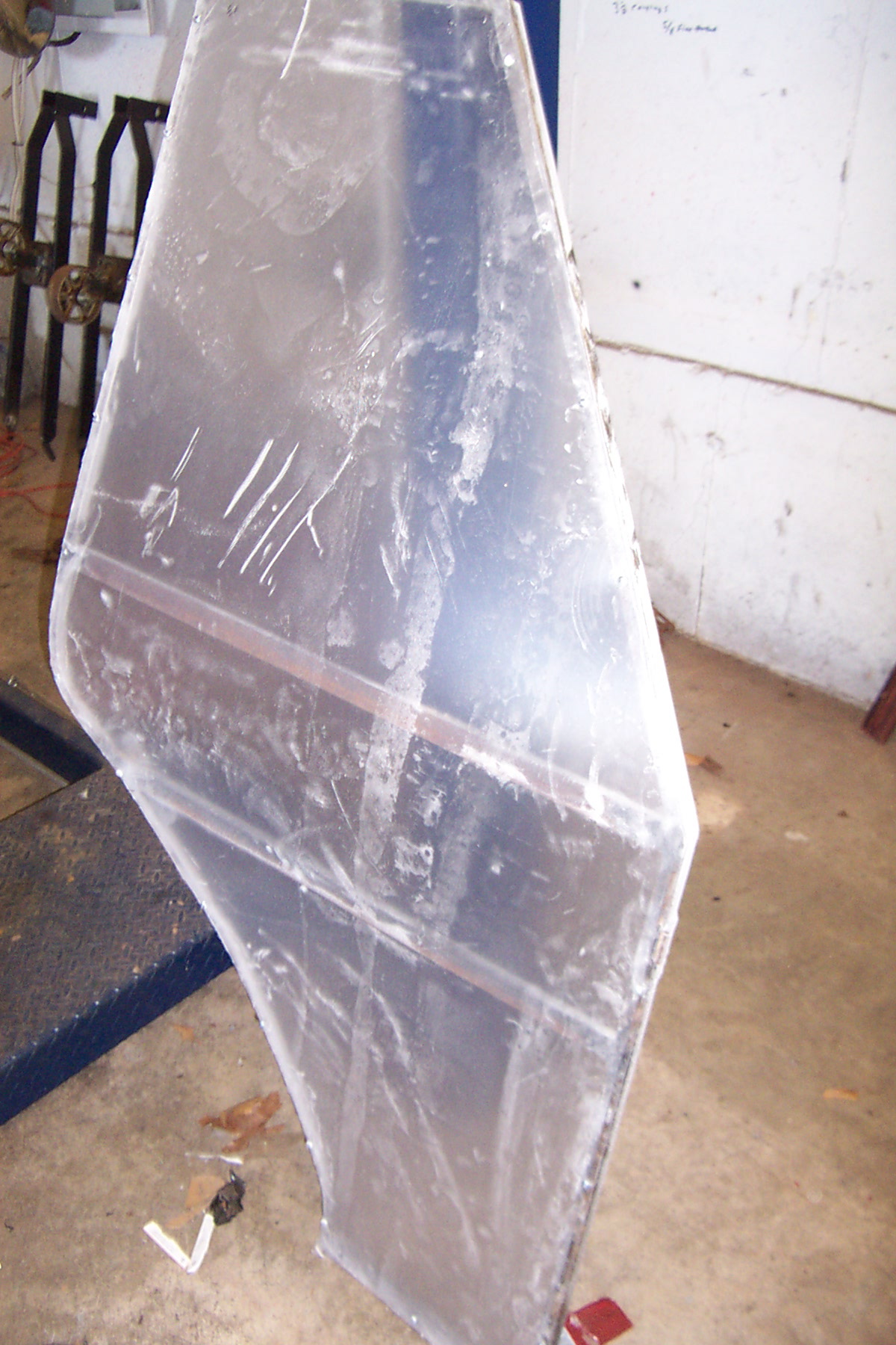

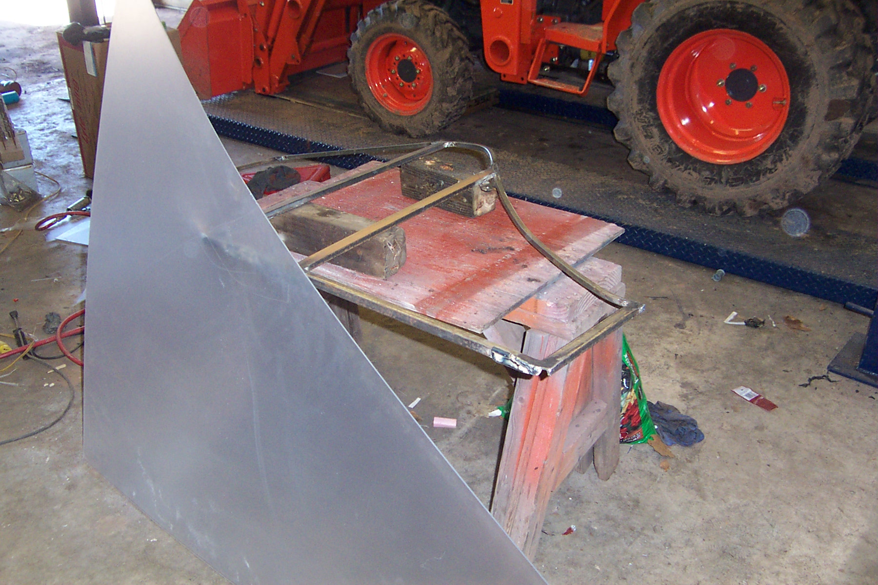

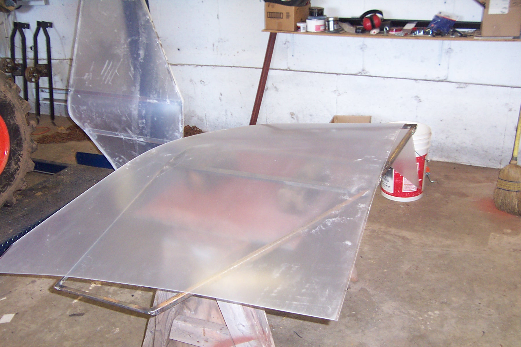

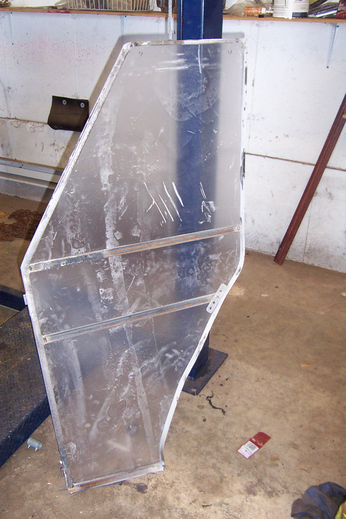

I used a 1/2" EMT bender on the 1/2" square stock used on the doors.
That is the only place I bent square stock.
I started skinning the doors today with lexan glass. It shapes to the contours easily.
