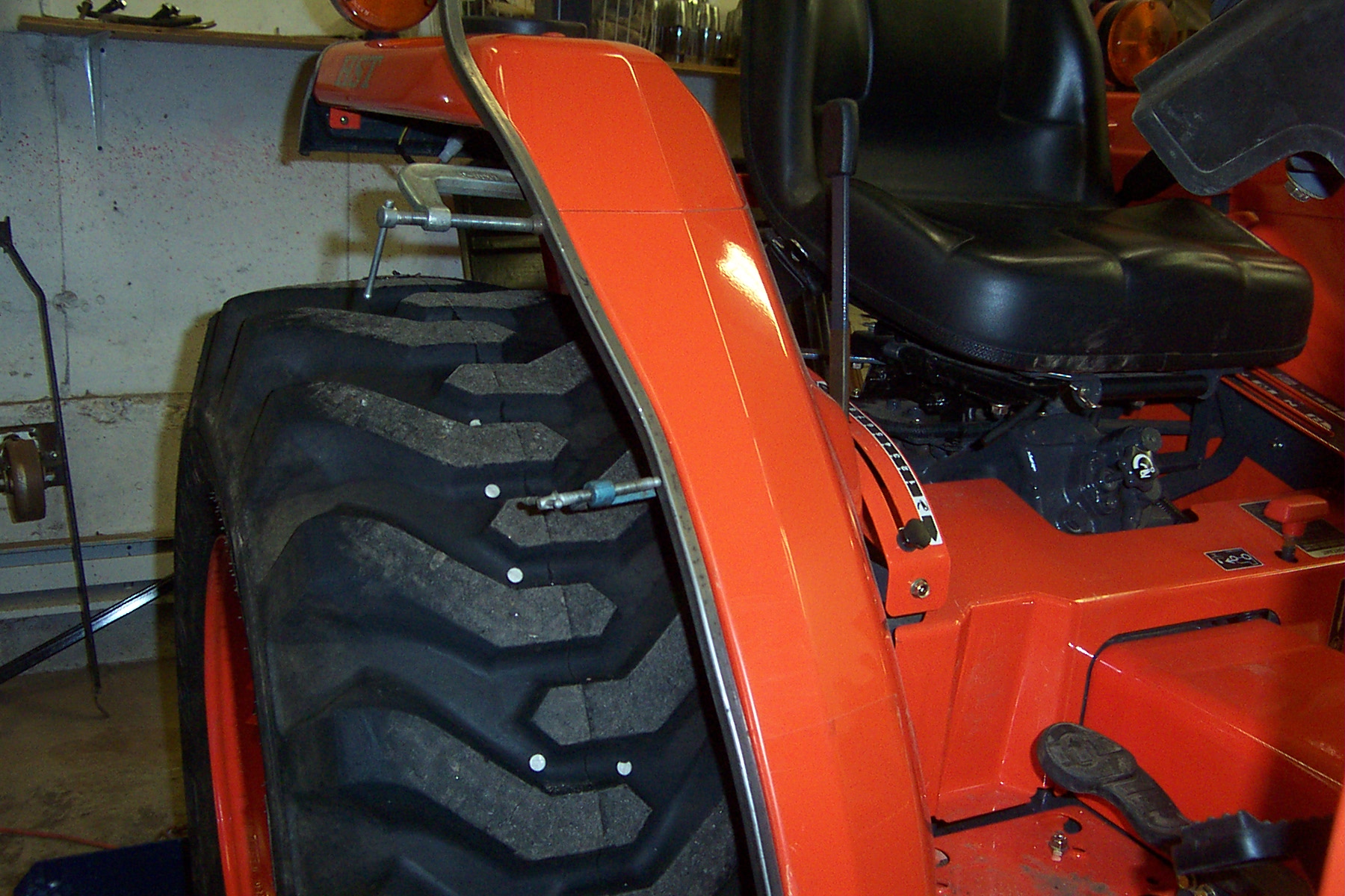

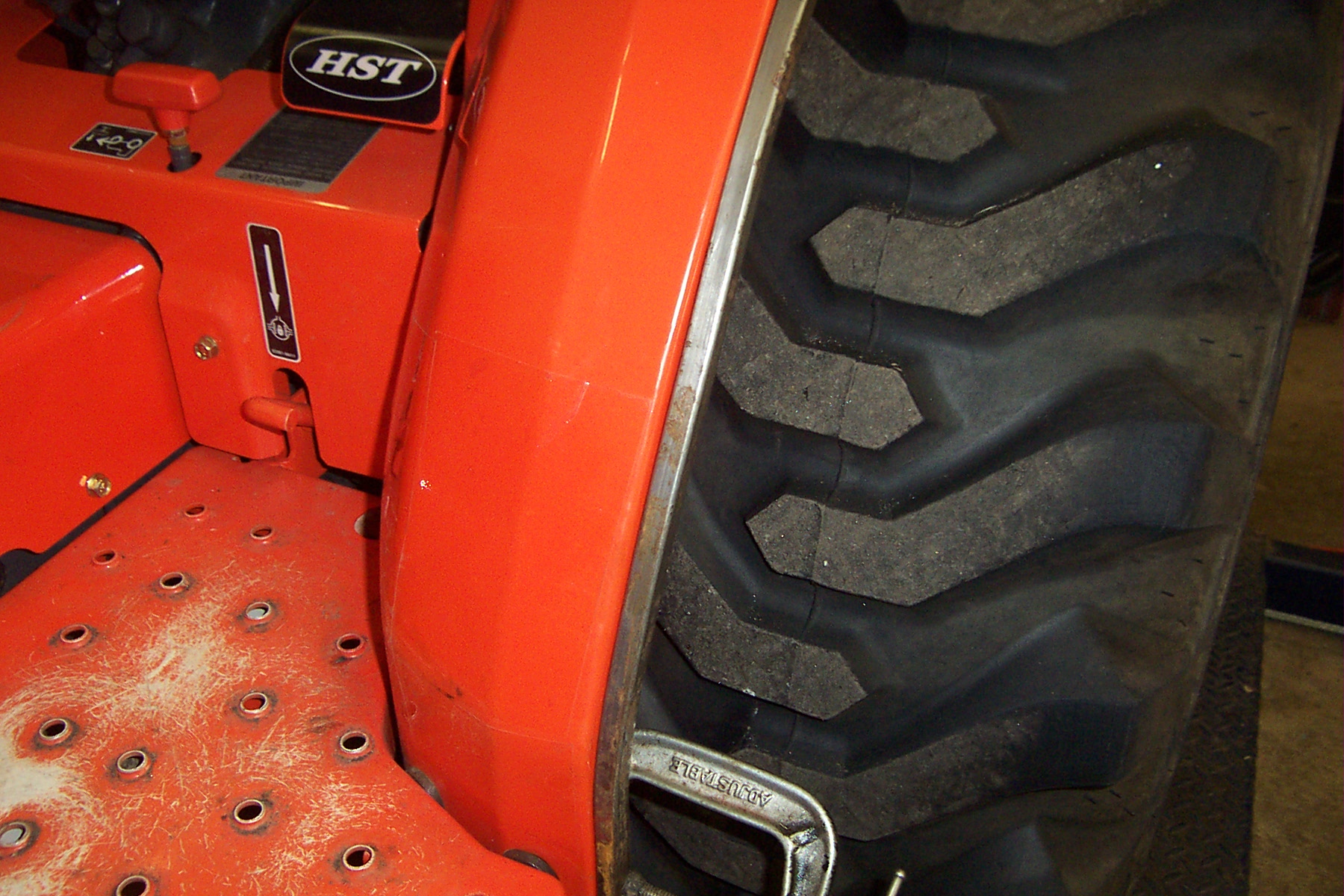

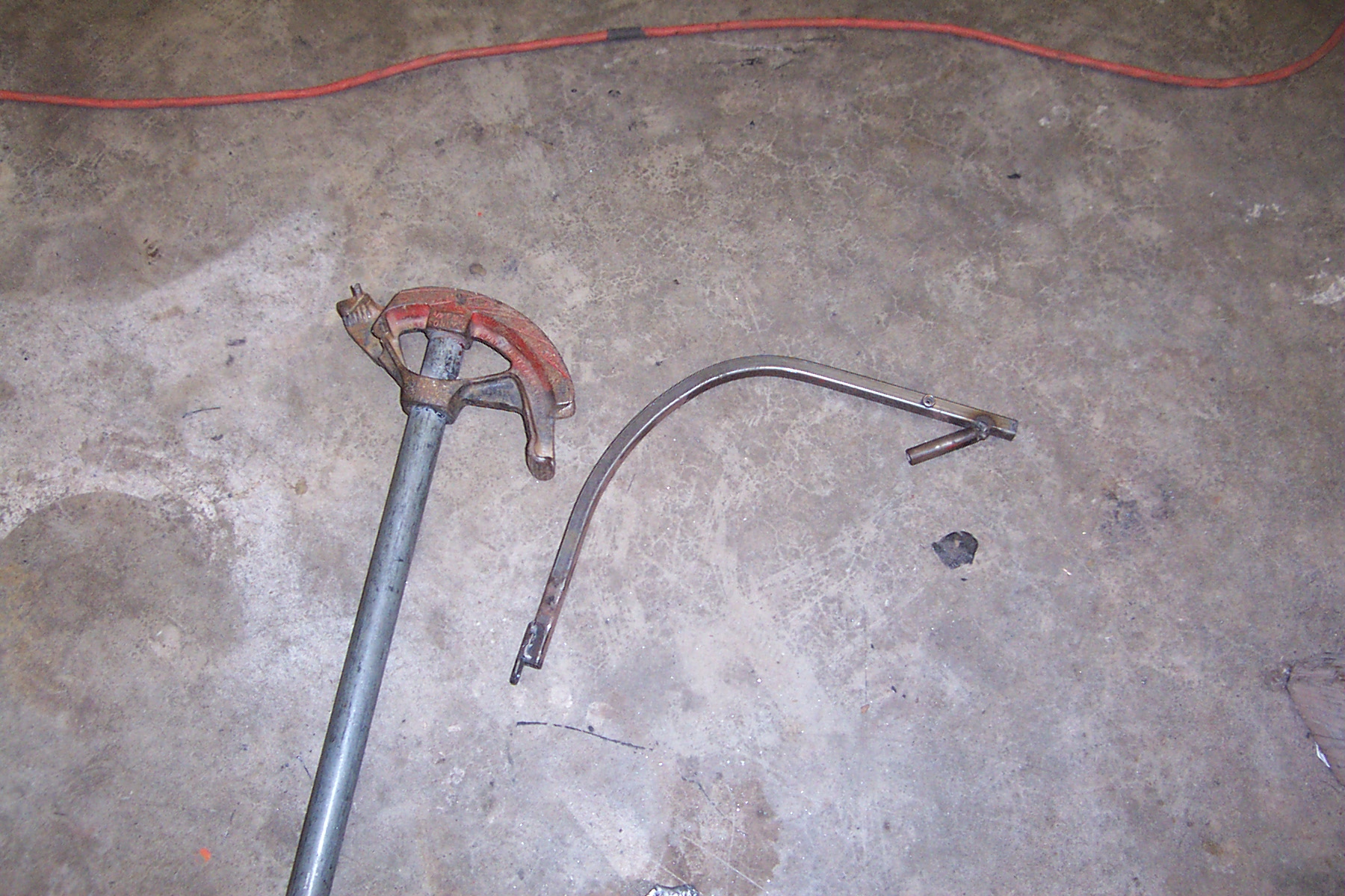

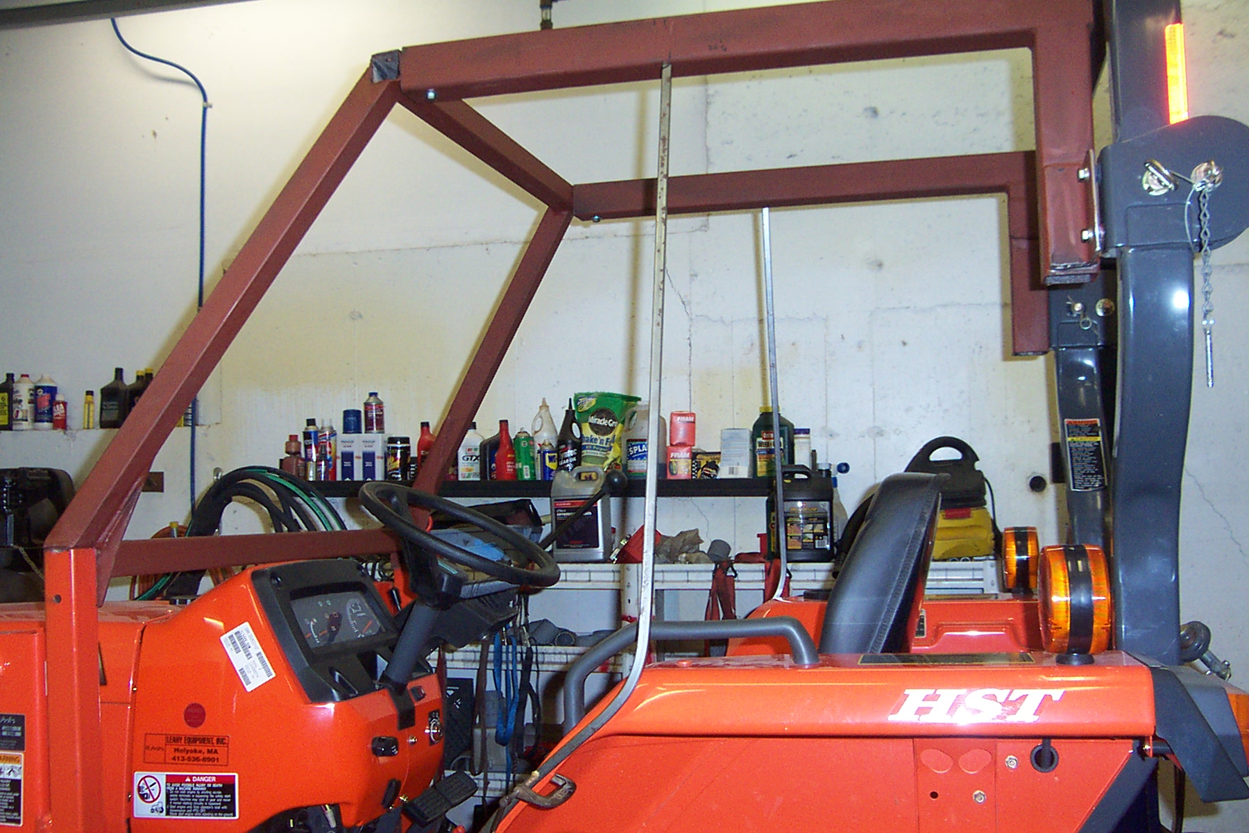

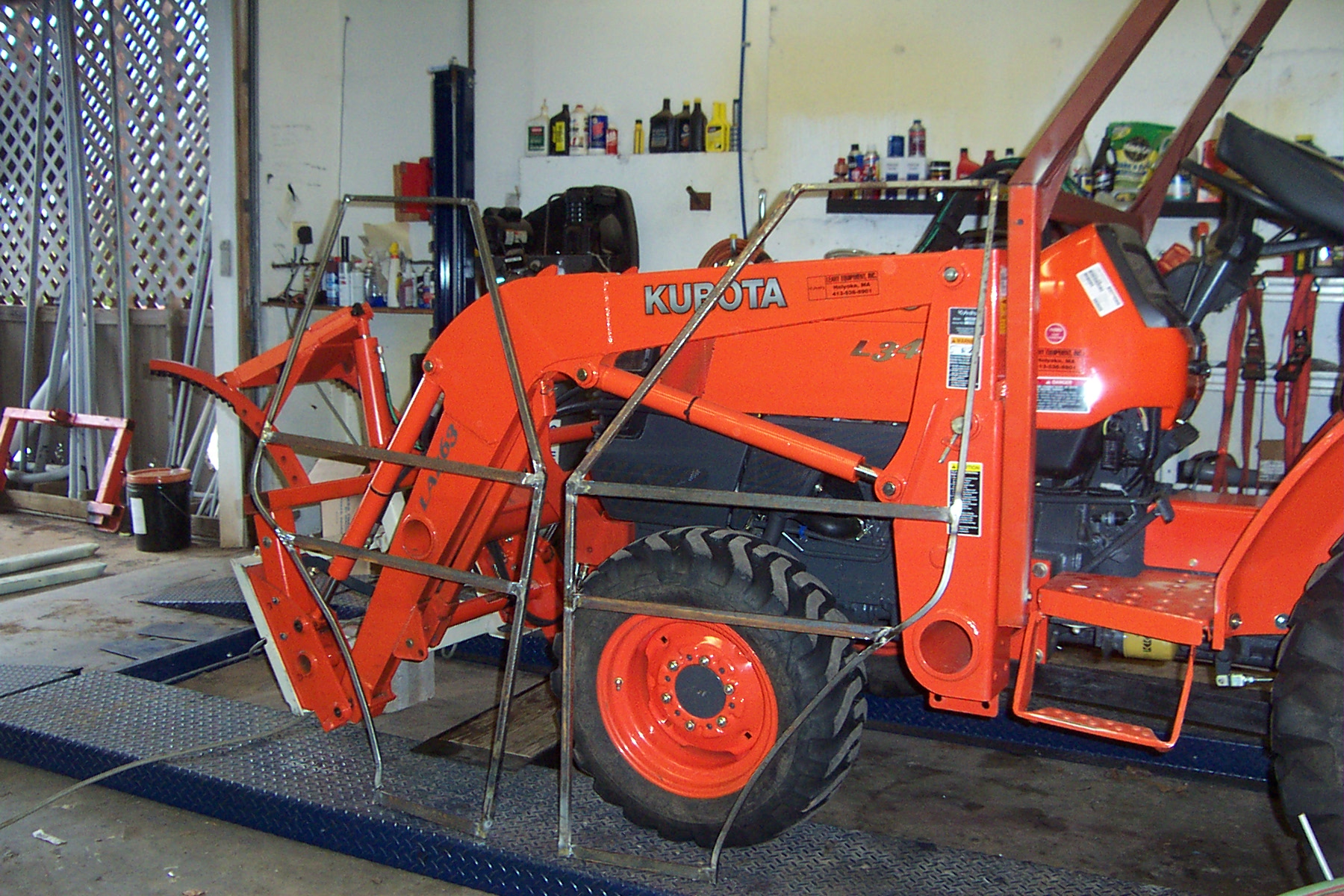

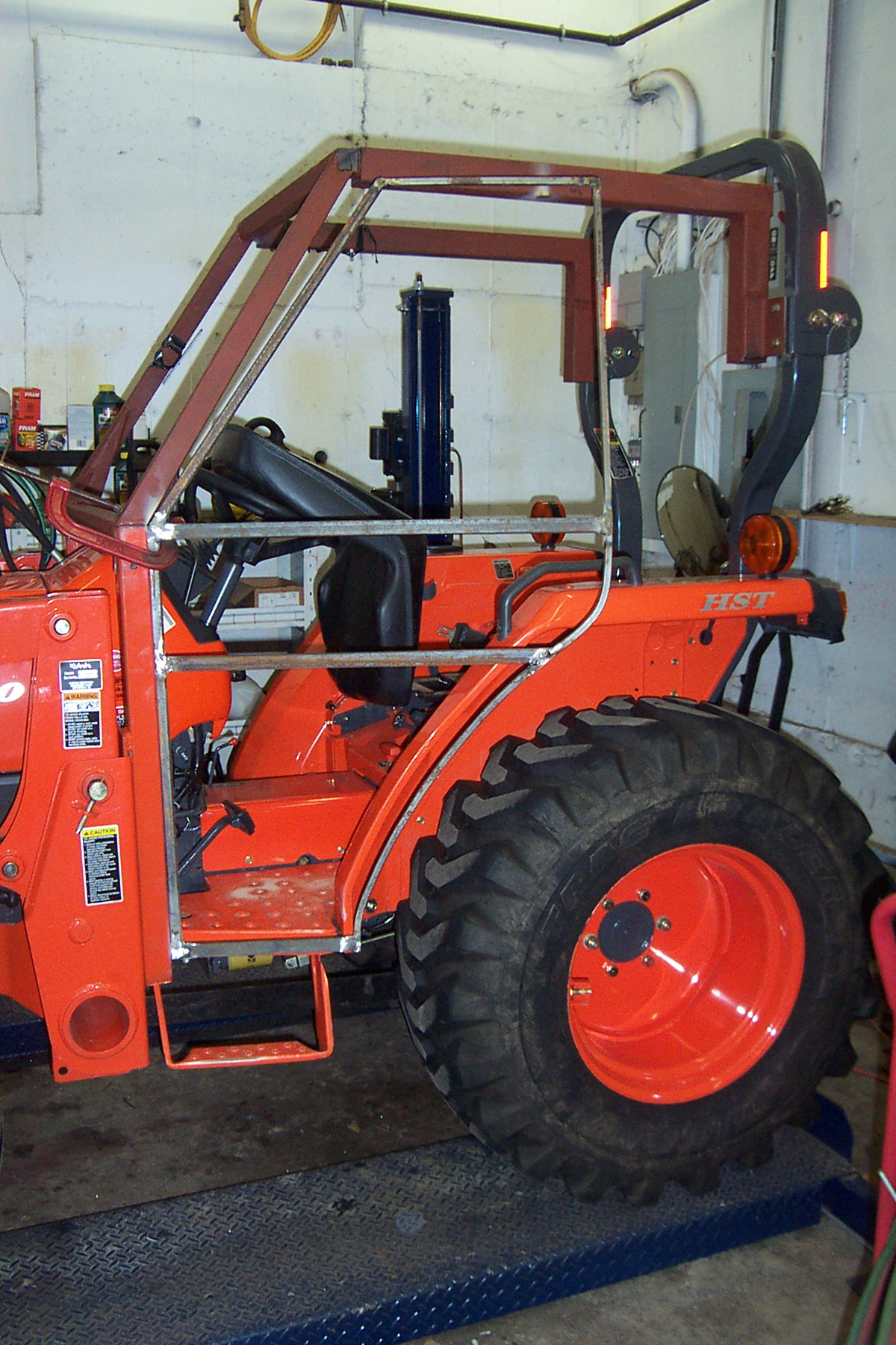

I am not fastening to the fenders, The 1/2" square tube is the door frame. It will stop against the side of the fender.
car is gone we have granite counter tops now :(
Great job on bending the 1/2" square tubing.
Hate to hear about the car...but granite tops are nice too.
Thanks for the pictures.....Keep posting:D
/ Making a cap w/ pics
#25
I'm up in the air about glass/acrylic and what to use. I really want glass, because that will make the cab look better in the long run.
Anyways, I have the doors framed. I am ordering lift off hinges from
McMaster Carr.
Oh, I forgot to mention.......I have bought no materials for this project. I used a squat rack for the cab top, and pieces of metal I had laying around.
I did buy a new bandsaw, The one in the last picture was replaced. I gave that saw to a friend.

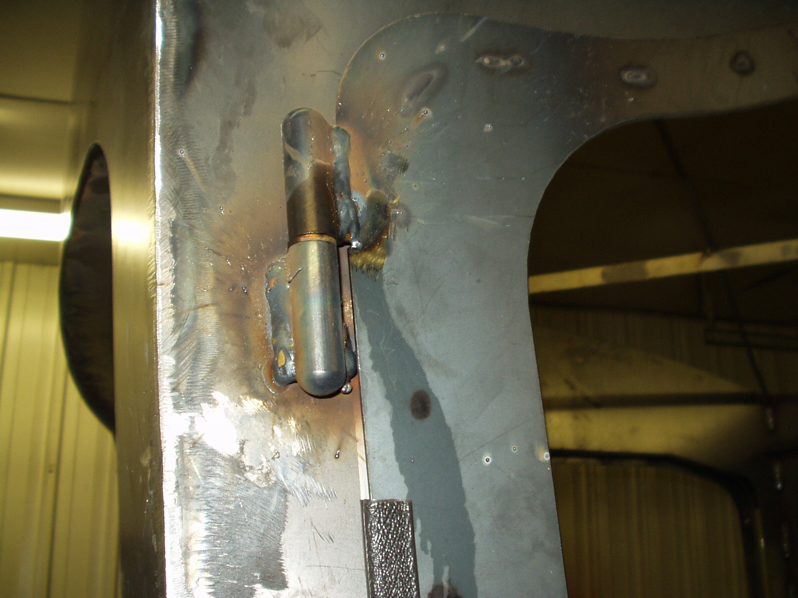

I have spent the winter building my cab too. Here Allegis Corporation is the "Slam Latch" I used. Be sure to order Right and Left. Go to the home page, click on PRODUCTS on the left side and select from all kinds of latches and hanles.
When my cab is complete, I will post the sources for all the hardware, rubber mounts, window and weather trim etc. I found the neatest hinges at Des Moines Iron. They look like a pice of shaft with rounded ends, cut in two and both halves drilled out from one end. One has a brass pin inserted that slips into the other one for the swivel. They both have a ridge running the length of them for welding so they stand off the surface. For $16.00 a pair, I couldn't see anything better. No web site, but they would know what your asking for.
Des Moines Iron & Supply Co Inc
123 SW 3rd St
Des Moines, IA 50309 (515) 243-0177
What mjncad said about plastic is exactly right. I used scratch resistant lexan 3/16" thick.
