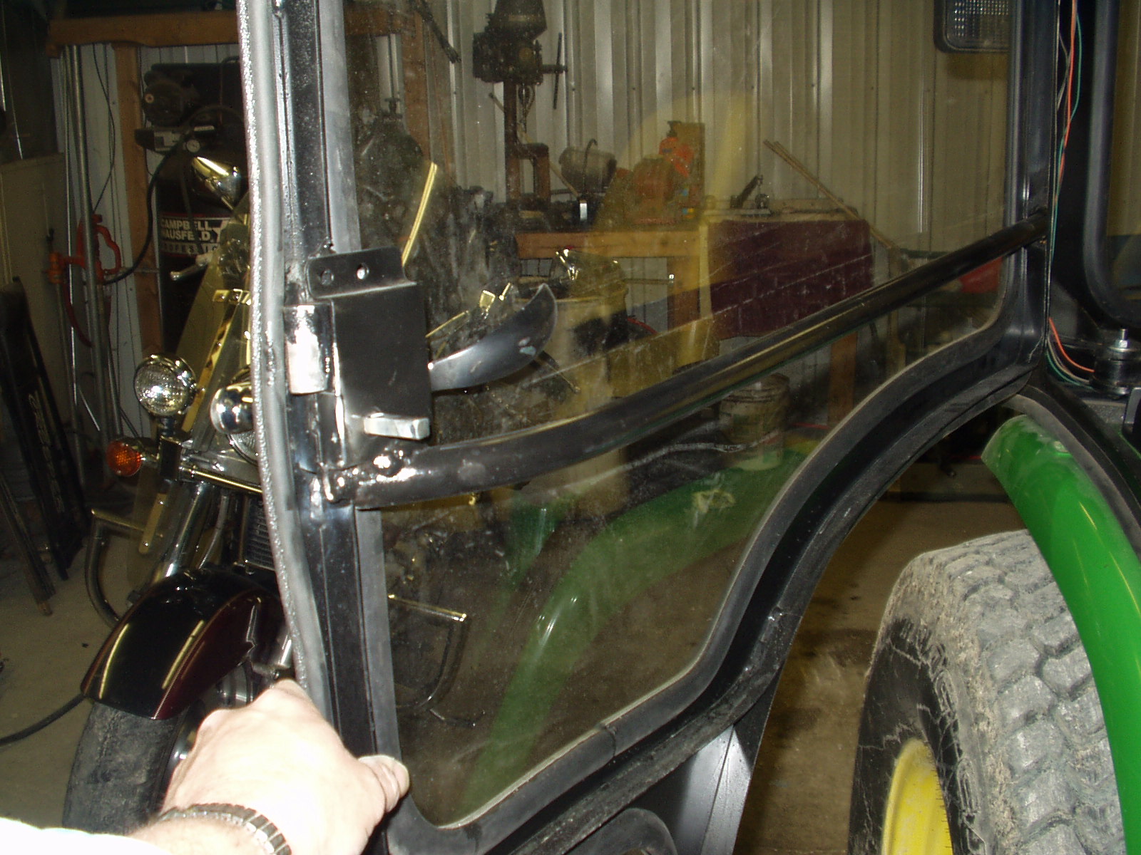

I don't understand the side or "c" which is called class clearance has to do with this install. The right side middle?

"C" in this case, means the space between the edge of glass and edge of sheet metal. This is how much smaller the glass needs to be than the opening in the sheet metal. 5/16" on all sides for this particular rubber. This rubber also comes as 1 piece, with the locking strip attached. You just zip it in. Other choices can have the locking strip come as a separate piece. This one was not too bad zipping it in. Just had to use lots of soapy water for lube.

OH! I get it now, the little piece sticking out is the attached zip piece.thanx

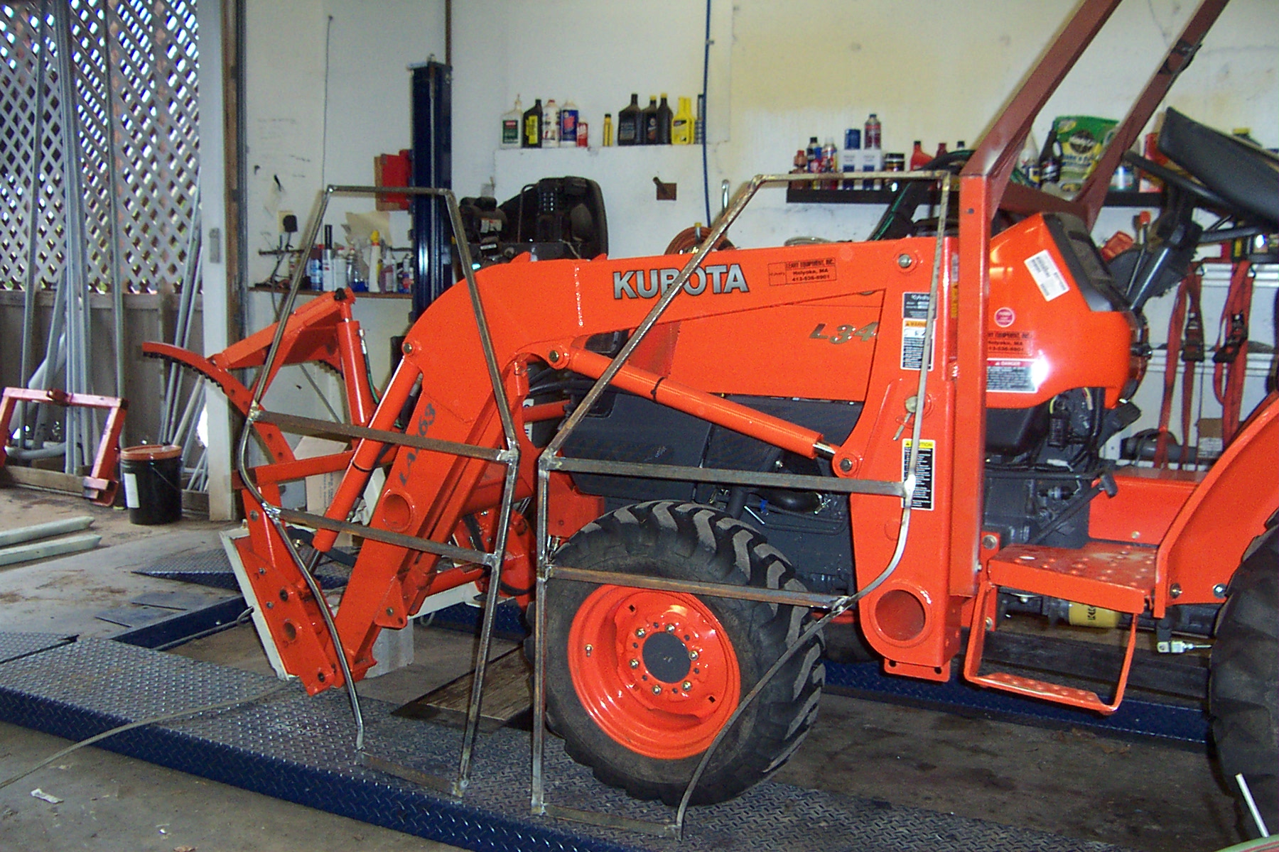

I checked out the cost of safety glass and it wasn't as much as I thought it would be.
I was quoted $60 for a 2x2 cut piece.
Windshield:
I need to make a 3/16" frame to hold the glass. At first I was using metal, but now I am considering using 3/16" lexan glass for the window border to frame.
This means I could cut a full windshield out of lexan and install it.(screw it right to the 2" window frame) Then later cut out my glass and install it into the lexan. It will plenty strong since it about only 1" wide around the sides. If I like it it stays, if not I put glass.
Lexan can be painted as well.

Work is picking up, so I have to get out there and do my electrical jobs.(Electrical contractor)
I have doors, and windshield lexan. I will post a pic as soon as a make a litle progress. Still looking at door handles. Stopped by to re-look at your previous post about latches.

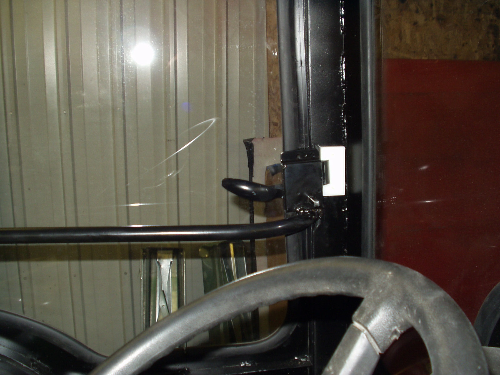

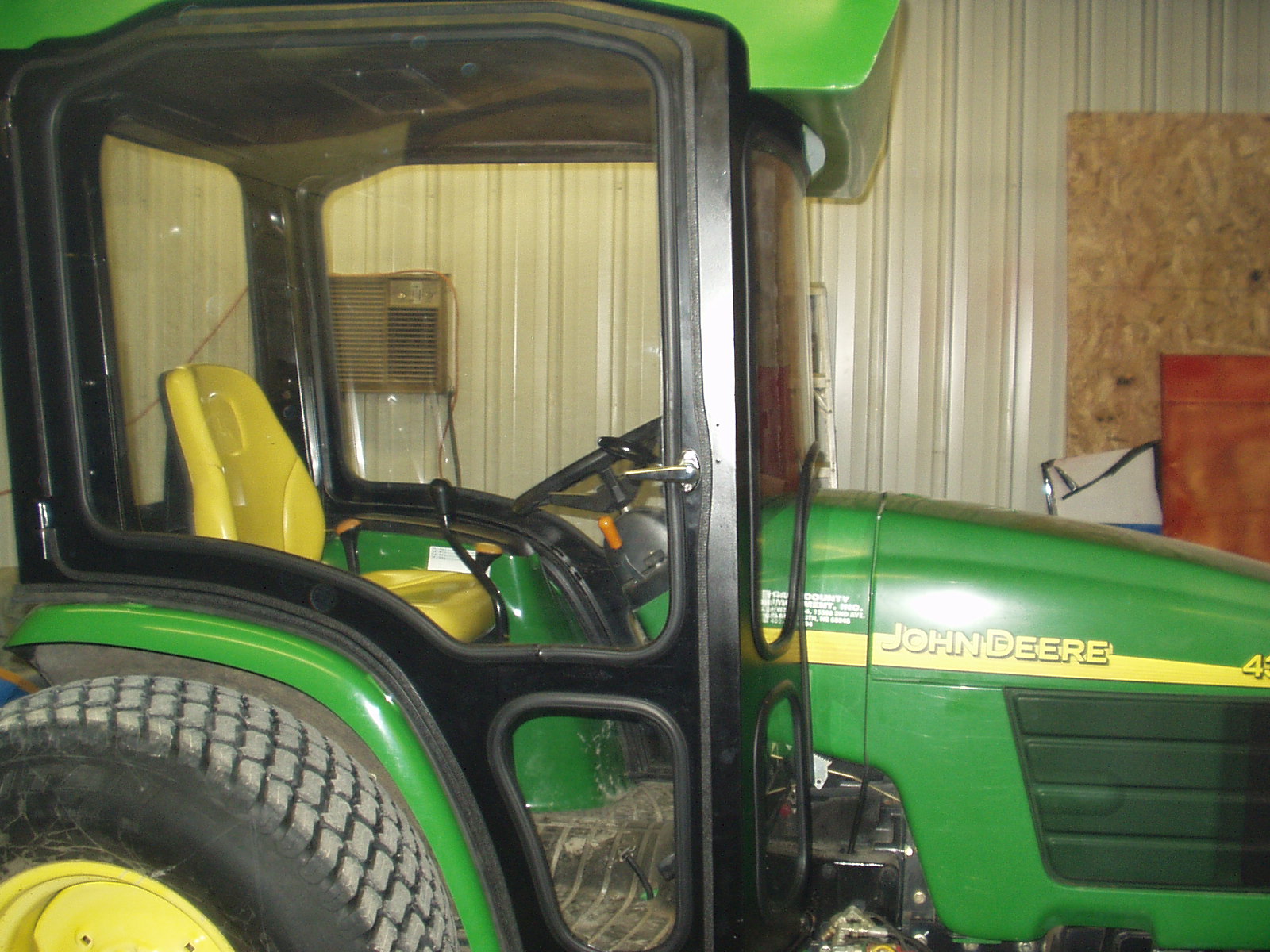

Do you have a good pic you can post of the latch inside and out? Thank You, Bill
/ Making a cap w/ pics #53
Not real good pics of my latches but here they are. I added a block of Polyethylene on the inside as a spacer for the striker to lock behind. The pipe you see was added for an inside grab handle as well as to stiffen up the door. It had a lot of twist due to the narrow area that I had to mount it on. I should have made a wider door handle area but didn't think far enough ahead. When I closed the door, you could flex the handle forward and back. The grab handle made it ridged and latches very secure now.
Where you are using square tube door frame, you should not have the same problem needing to add support.
Rick

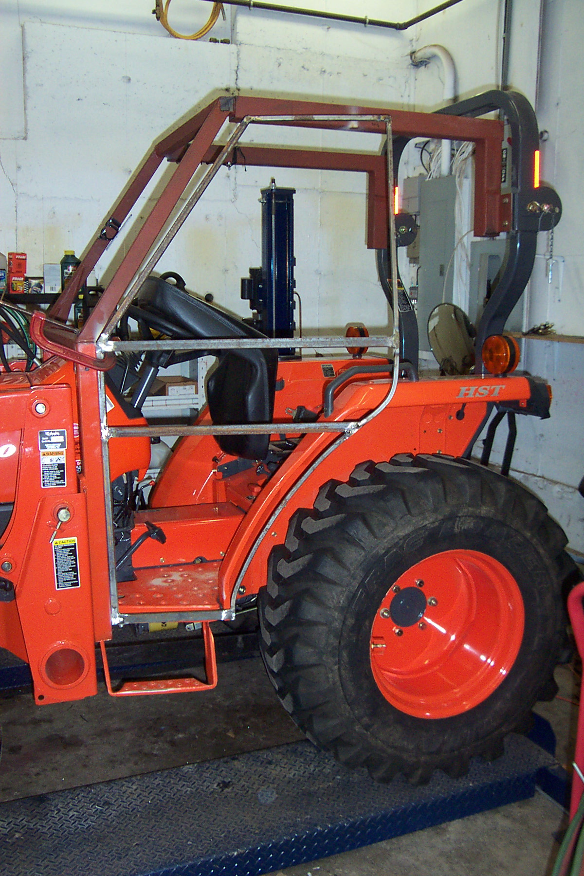

Regal... thanks for the pics, I like the grab handle, you can get it different places as the door opens and shuts.
I bought a 3 x 4 carpet mat and glued the rubber backing to the inside of the top to lower the noise level in the cab. It seems to work well.
I have the frame painted up and installed the lexan glass.

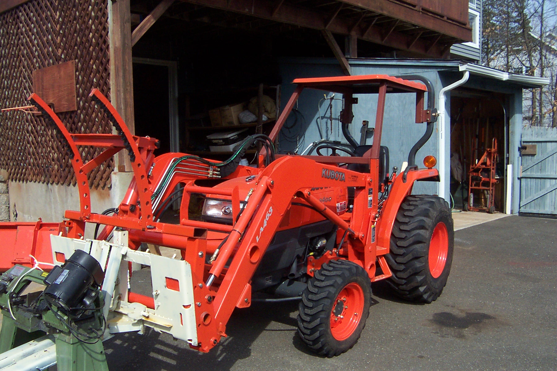

Carpet, $17 Home depot
Square tubing bending easier than 1/2" conduit. Just like bending conduit, keep good foot pressure.
Plans for the back keep changing. right now, I like the flexible lexan glass. I can bend right angles. I also see a soft back for a cab with plastic window for a $100 bucks. But I think I will use lexan.
Working on the garden right now. It started raining while I was tilling. The top and windshield worked great.

I used 2" square stock. The whole cab can be taken apart in minutes. For example, in the summer, I will use the top and windshield only. For snow plowing I will install the doors, and back side (back side is not started).
It was easier to work on in stages.

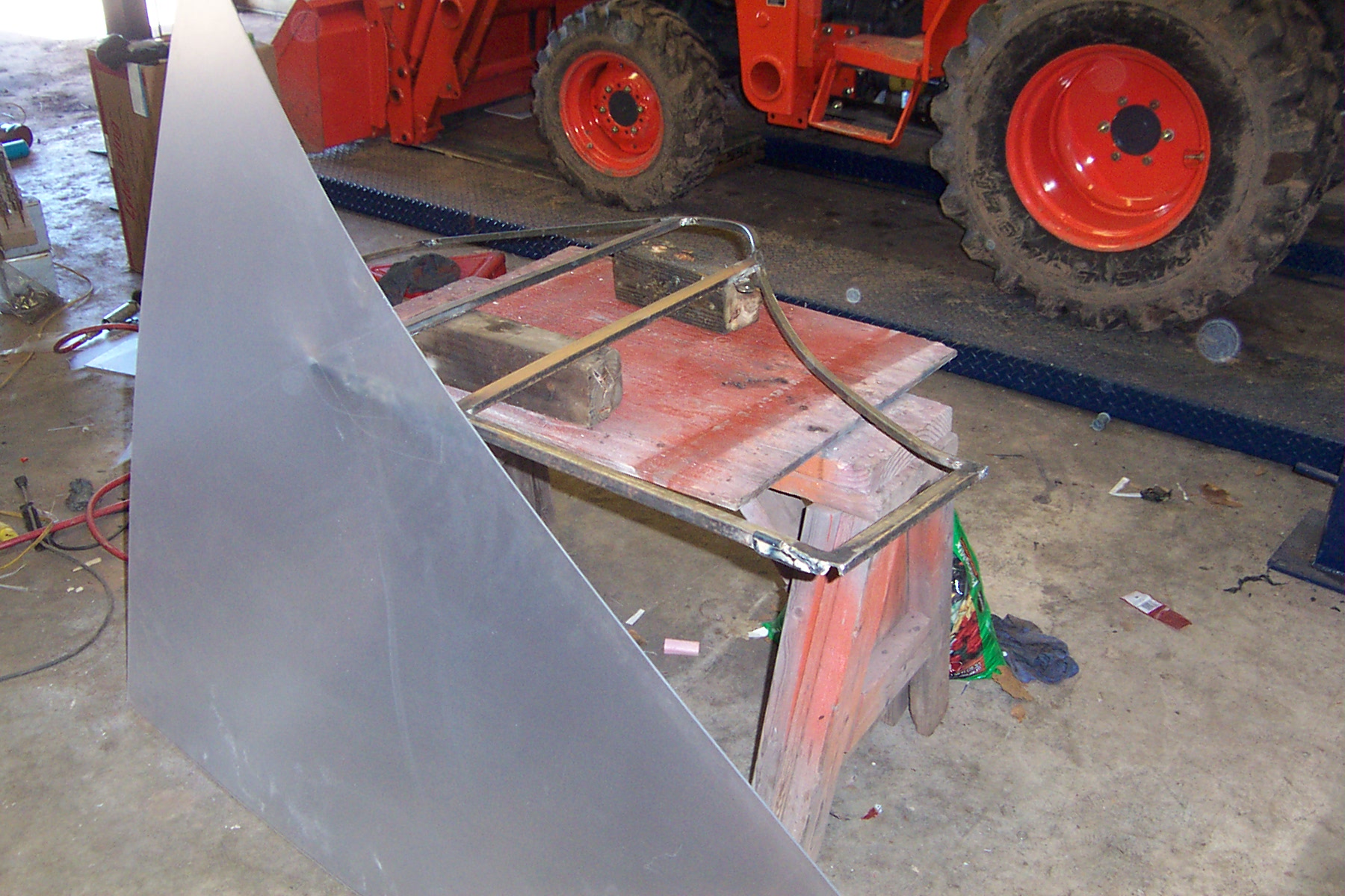

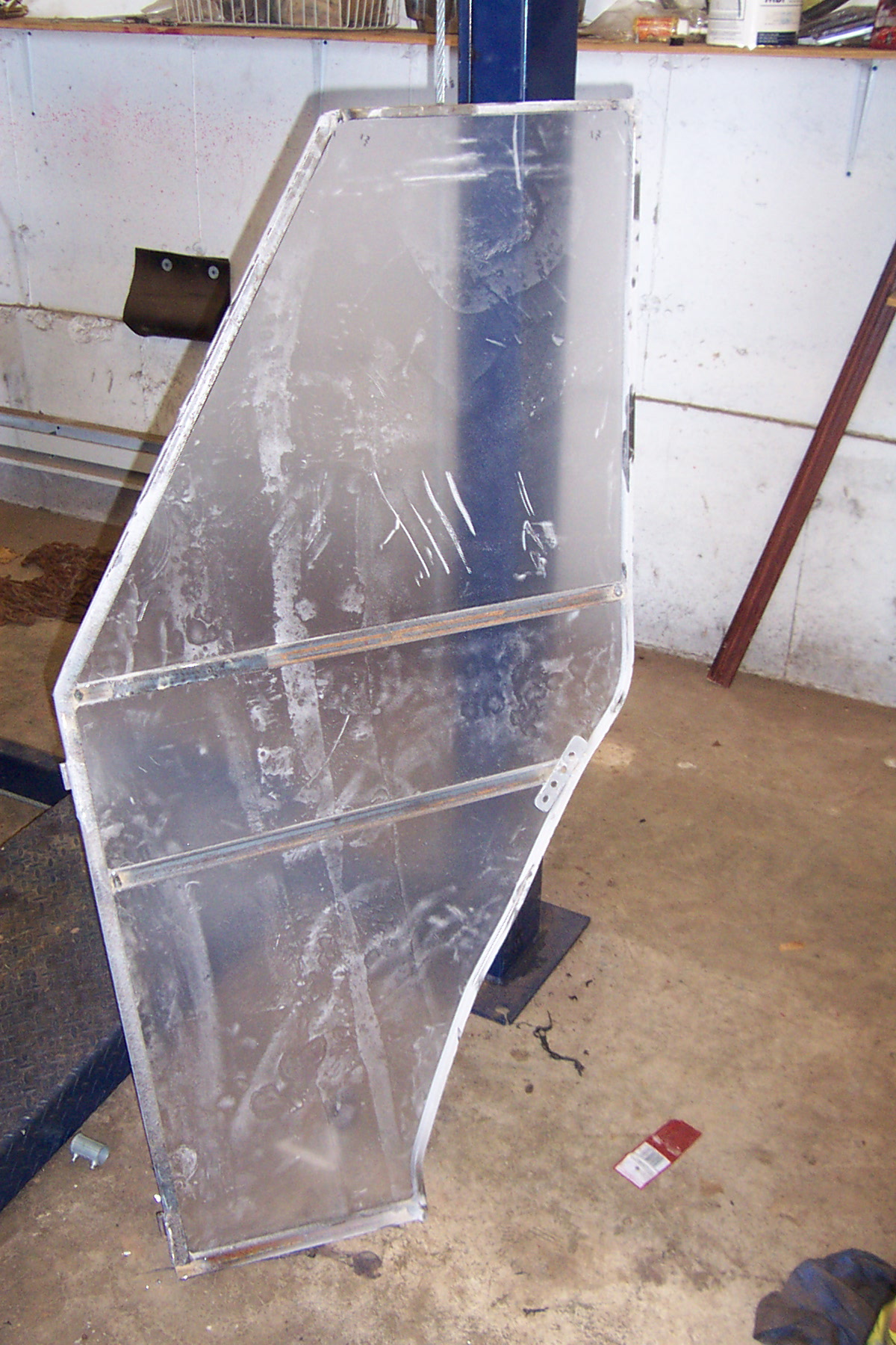

I used a 1/2" EMT bender on the 1/2" square stock used on the doors.
That is the only place I bent square stock.
I started skinning the doors today with lexan glass. It shapes to the contours easily.
