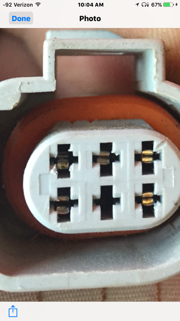

Dealer said they found this issue with EGR plug. Bad spread on pins causing a bad connection. Hope that does it. Dealer has been good to me through this.
