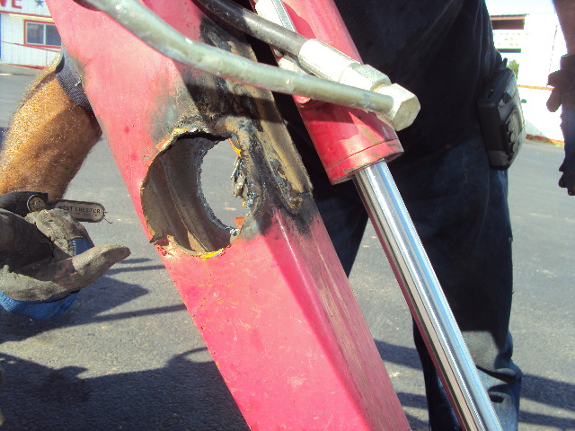

I have a 4500 with a great bend loader and have bent and or broken 4 of the upper bucket tilt cylinders. Mahindra says it is impossible to do. I say it isn't!
Last week when it happened I was backdragging a shallow creek, pulling the mud and weeds out during a dry spell, when I heard a big crack and one of the cylinders arms had bent and cracked in half.

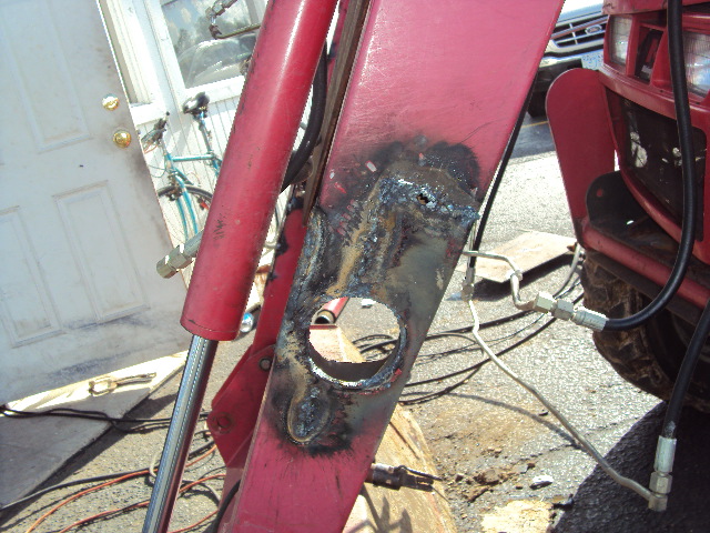

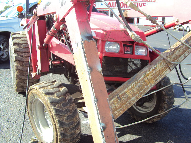

I have the same loader and the arm also broke at the same place back draging. I did away with the hollow pipe in the middle and welded plate all around the arm and replace the pipe that it welds on the inside of the arms and does not gop all the way thru. I have broken most of the front end loader parts and re frabricated every thing heavy duty. The metal is very pourous and cheap. Not like american steel.

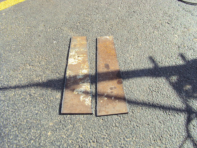

I guess all the metal is that recycled stuff. Because when you look at the metal it is pourus. The arms on the loader were not pourus just thin. The pipe they had going from one end to the other where the lines lay on top of had some very weird looking metal. I will put photos of the finished job in a few days. I am redoing all the lines now. I welded these plates all around the arm and it holds up good now. I also ran 2 pipes going across instead of one.
