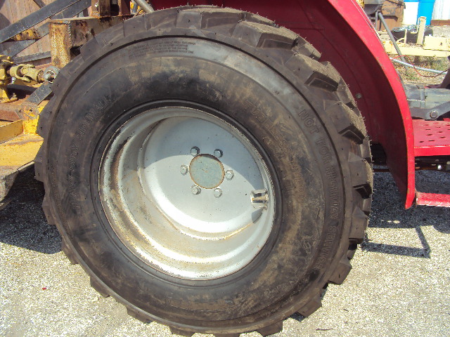

well I guess the dealer that put my FEL on did not use a torque wrench than and that is why it keeps coming loose. Torque wrenches are used to tighten bolts in a sequence all evenly like heads and main bolt bearings or aluminum. So a warping efect wont happen or over tighten on something that matters. Frame bolts are big strong bolts that can be tighten by any means possible. Torque wrench, Breaker bar, or impact. To keep from coming loose. By the way I have atb least 7500 hours on my machine right now and have put about 1000 in repair in it since I have had it including new 14 ply tires all around. So I think I am getting my moneys worth for a inexpensive machine. I paid 160.00 for these 14 ply tires new after extensive searching.
