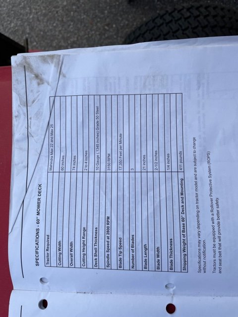

hows the quality of cut on these? is blade tip speed higher then residential lawn mowers?

Blade tip is 17,350. Don’t know how that compares to a residential mower. I think the cut is good and I mulch mainly because I hate raking leaves in the fall.
