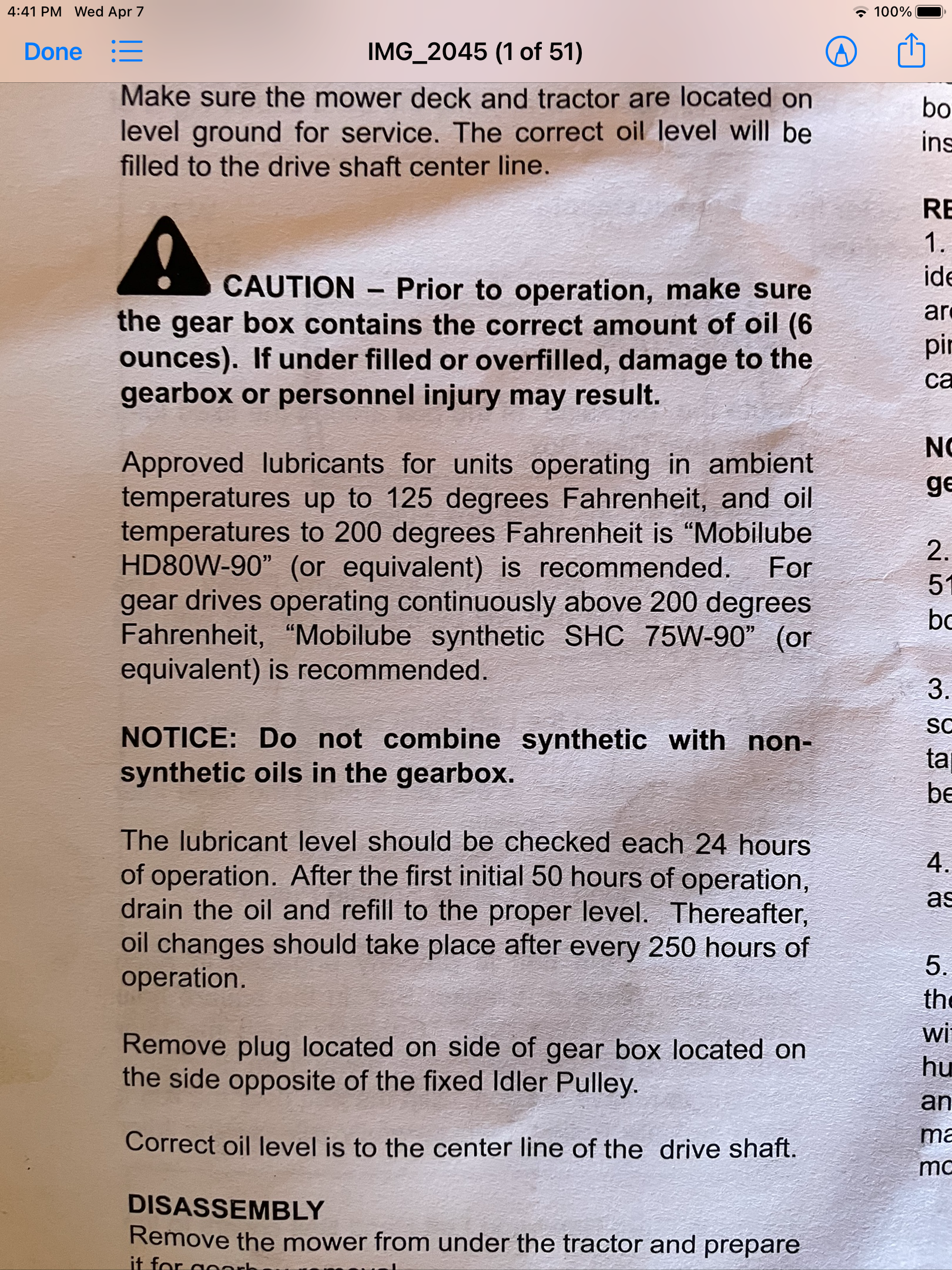

I flip mine over to remove the blades for sharpening. I have hooks on my bucket and use a couple nylon slings to lift it. Flipping it makes it easier to block the blades to torque the bolts. Think it’s like 150 ft/lbs.
I cheated when I pulled the gearbox and used a chainfall and put the deck on a couple of horses.
Same here. Takes 5 minutes to slide mine out from under my Kubota. Then I pick it up with the loader and leave it sitting on the ground but hanging vertical so I can access the blades and underneath. Piece of cake. I love the MMM for everything but tight trimming.

Here is some hard learned information on that there belly mower gearbox Little Bill...

Has anyone had a problem loosening the drain plugs or changing or adding fluid? I think I stripped the heads on those recessed bolts
/ Mahindra 60" belly mower #27
Yes. If you are talking about the fill plugs they can be a bugger... If they are stripped you may have to add a LITTLE heat from a torch and/or use an easy-out. You can get replacement plugs.
As for adding fluid- thats a trick to get the gearbox level in whichever means you can so that it is even with the middle of the shaft. I use a piece of nylon tubing on a large syringe type lube tool to squirt in the oil.
/ Mahindra 60" belly mower #28
Thanks for replying. I was able to work them free by pounding a star socket into the holes and after ALOT of force I managed to get t2 of them out. I was able to find replacements at a local hardware store. I did add the fluid and yes that was a challange as well.

/ Mahindra 60" belly mower #32
Thank You. disappointing to hear the gear box has to come off.
I realize these threads are a couple of years old, but I wanted to hear/see the directions for removing the gearbox. I have the same MMM on my Mahindra Max 24, along with the manual, which by the way does not show how to remove it, step by step. If anyone still needs the manual on this, I'd happily provide one. I can copy it into a PDF of same.
