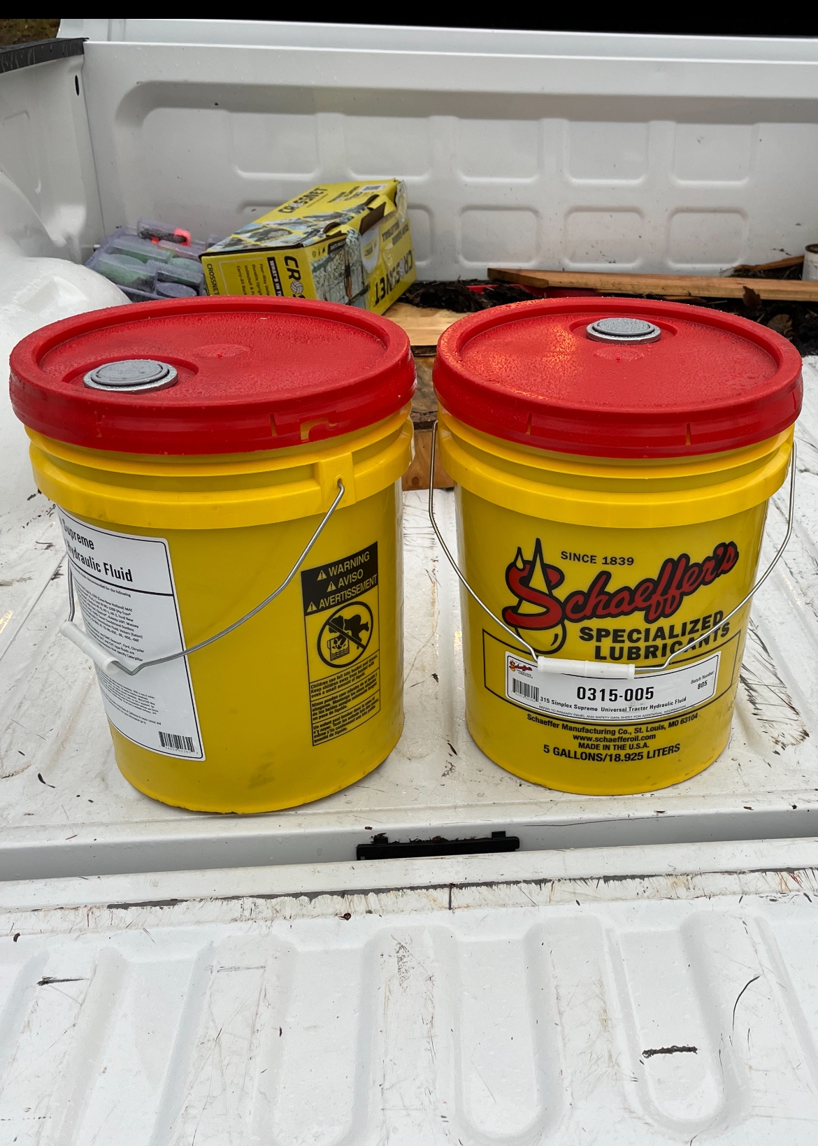

I’m in the process of changing mine now at 100 hours. They want you to change the filter and clean the strainer at 50 hours. And since the fluid has to come out to do that anyway, I figured I might just as well change it as opposed to trying to capture it all in a spotlessly clean drain pan, without having any dirt etc fall in it during the process. So while the tractor is basically inside for the winter, I’m just changing it and upgrading to a better fluid at the same time. I took the strainer to work and ran it in our ultrasonic cleaner today. So it’s all clean and ready to go back in on Saturday when I’m back at the property where the tractor is at. Just found a small amount of very fine iron dust on each of the (6) magnetic drain plugs and a few small particles on the strainer screen. So that’s encouraging.
what is the better fluid you are going to?
I went with Schaeffer’s Simplex Supreme. I use it in my little Yanmar and used it in my last Mahindra. It’s a synthetic blend so it’s easier on the hydraulic pump in cold weather and it makes it easier to shift when it’s cold too. IMG_8868.jpeg

I went with Schaeffer’s Simplex Supreme. I use it in my little Yanmar and used it in my last Mahindra. It’s a synthetic blend so it’s easier on the hydraulic pump in cold weather and it makes it easier to shift when it’s cold too. View attachment 839663
thanks Andy but cold is not my issue, i make it a point not to be lol

I don’t blame you. I avoid it if I can but where I’m at it’s inevitable. I also use it because it’s an upgraded oil from the factory oil just in terms of lubrication and additive package. But the fact that the 5100 series are gear drive and not hydrostatic, means the transmission fluid lives a little easier life anyway. I just finished the change last weekend and had no issues. Just be sure that if you do it yourself, it has (6) drain plugs on the transmission. And I got oil out of each one. Another thing I’ll say is that every plug was extremely tight from the factory. So do yourself a favor and buy a good 9/16” (8) point socket for the plugs. It will keep you from saying bad words trying to use a Crescent Wrench. Several of them are tucked up in and aren’t easily accessible with a Crescent Wrench. And as tight as mine were, I’m afraid you might round them over without that 9/16” (8) point.
