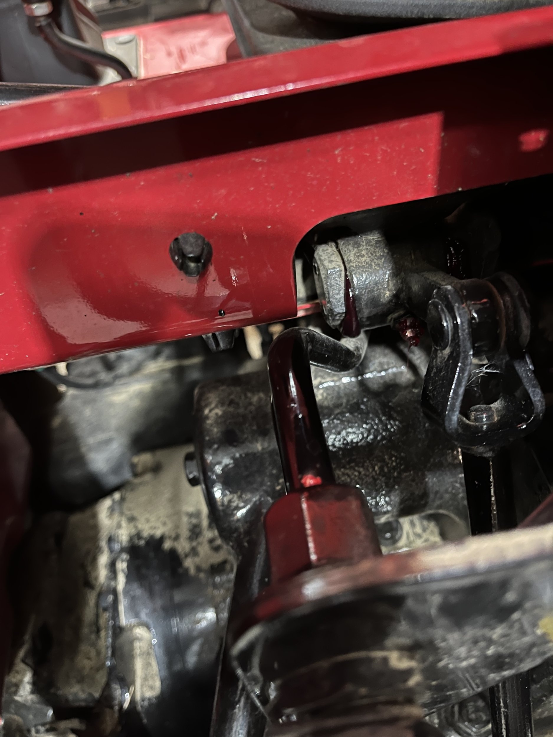

Hey everyone. I am working on adding a second rear remote and in the process of working on the measurements for hoses to go to the back, I found another grease fitting that I hadn’t seen before and that isn’t in the manual. It’s on the pivot point for the PTO selector lever. Not the PTO clutch, but the lever that lets you select standard PTO, E-PTO, or neutral. Here’s the best picture I could get of it. It’s tucked in right above the factory rear remote quick connectors on the left side of the tractor. Probably not a big wear item, but I thought I’d pass it on to the community. They certainly didn’t skimp on Zerk fittings, which I see as a good thing.

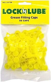

Thanks for the find. Yes, they aren't all in the manual. I have put yellow plastic caps on the zerks so I don't need to look for them as much when greasing - got on Amazon. See pic.

Thanks Andy. I believe that brings the total to 26 now. That is just the tractor! Never mind the 12 or so on the FEL.
I wonder if there’s any more of them that we haven’t discovered yet? At any rate, I think it’s great that they went old school and put a ton of grease fittings on it. So much stuff today is just designed to be throw away and everything is “sealed”. I think being able to push new grease in, and push out old grease and dirt and water is a great thing. I’m just glad I have a pneumatic grease gun!
