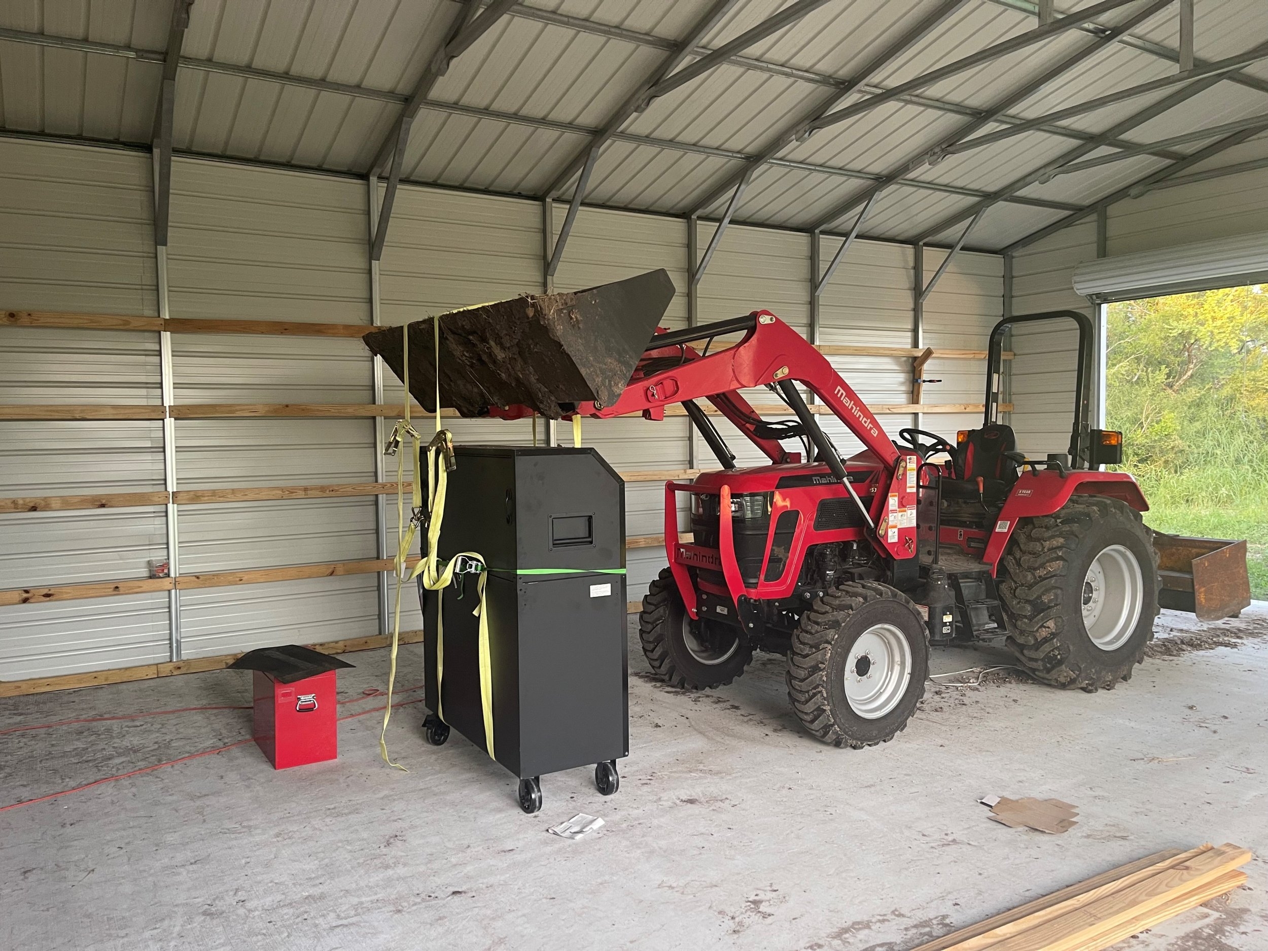

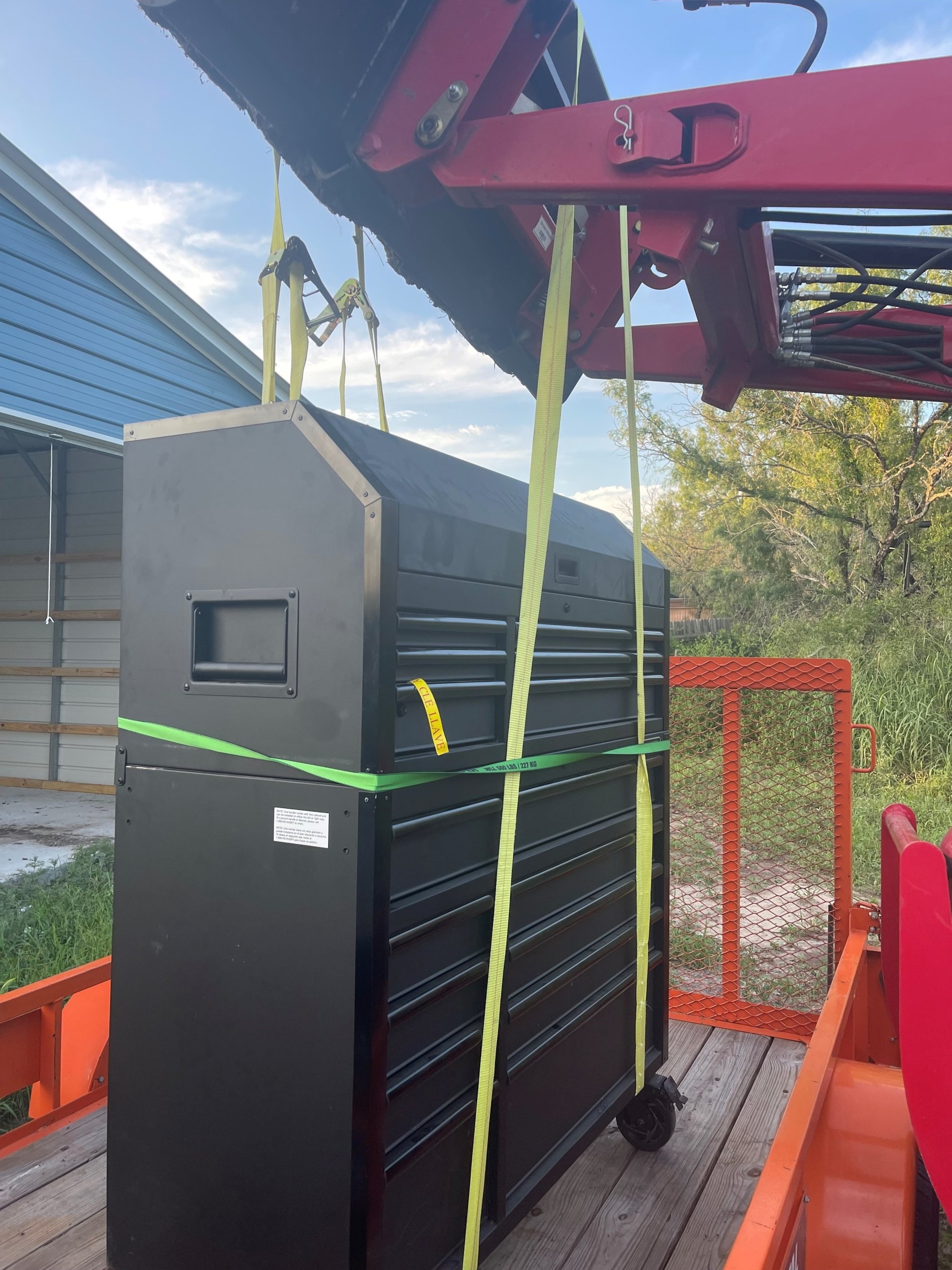

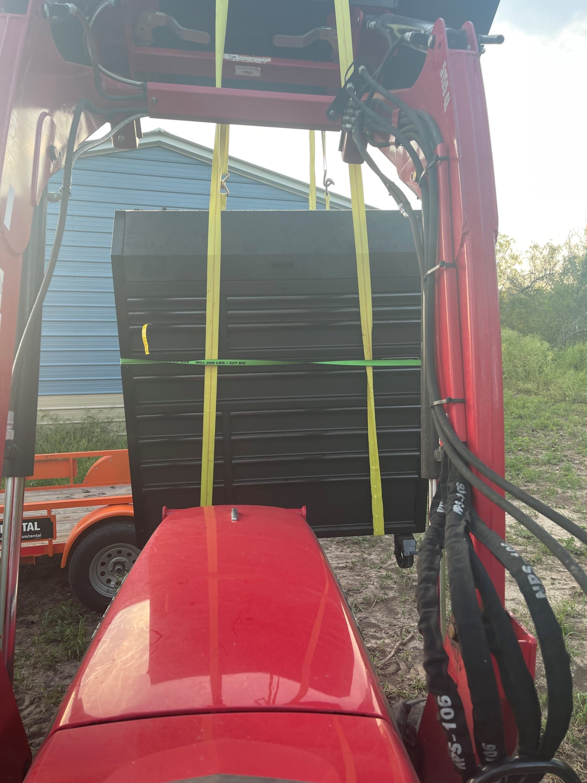

I love my tractor even more today, 600 lbs and just me getting it out of the trailer.

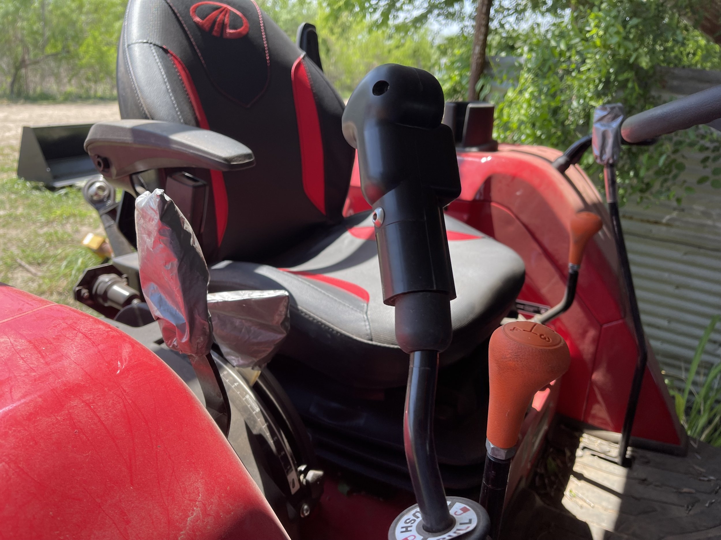

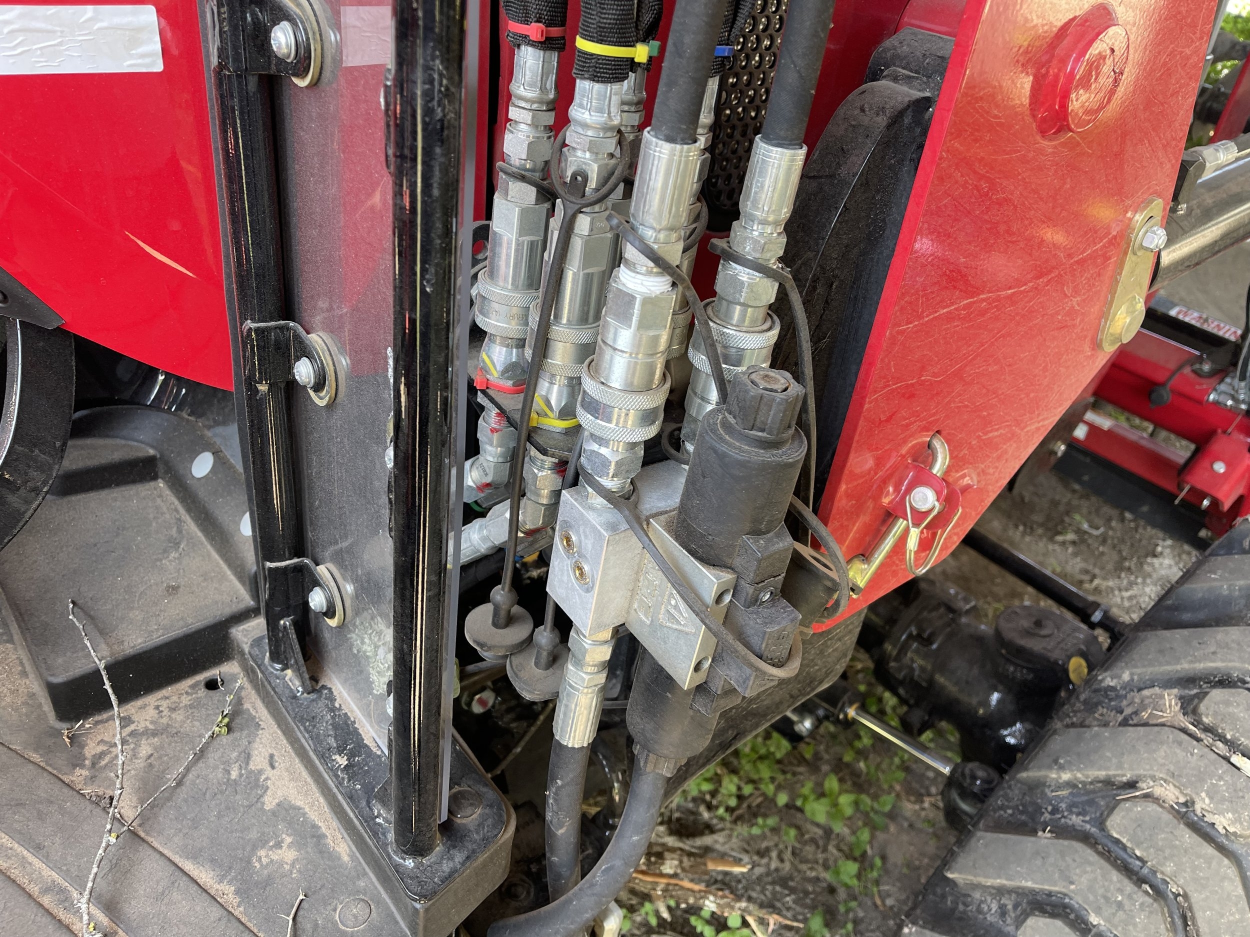

the tractor comes with a button setup on the joystick for a diverter valve but not a true 3rd function. The mahindra 3rd function kit (diverter valve) was not available when i bought mine and was much more expensive than installing the WR long kit.
in order to install the WR long kit the joystick handle is removed and the new 2 pair wiring is fished down the shaft with a new handle installed.
the small black cylinder in the last photo is the WR long 3rd function valve, it attaches via the power beyond port on the FEL valve.
diverter has pros and cons with it you select the 3rd output and then use the joystick to send fluid to the 3rd function instead of the curl (or lift) on the FEL, with that arrangement you can feather the amount of flow to the 3rd function but you cannot curl (or lift) at the same time. with the 3rd function you turn it on or off no feathering but you can still control the lift and curl at the same time.
i like the true 3rd function but i can see where some would like the diverter valve option.
you can somewhat feather the 3rd function by lifting or curling as you engage the 3rd but it is difficult to coordinate, bottom line is that gently grabbing something with the 3rd function grapel is very hard.
the closest i have come is to get everything positioned and then lower the rpms to slow down the flow.

That is fantastic information. I have a call in with my Dealer to discuss. Most likely, it will be the WR Long kit. This is my first tractor, but I grew up running equipment. There will be a learning curve, I'm sure. Thank you for this post. Definitely helps me understand the difference. I think being able to move the grapple while curling or raising / lowering is a win. I have a lot of downed trees and underbrush to clear, so the root grapple will be my most used attachment right off the bat.
