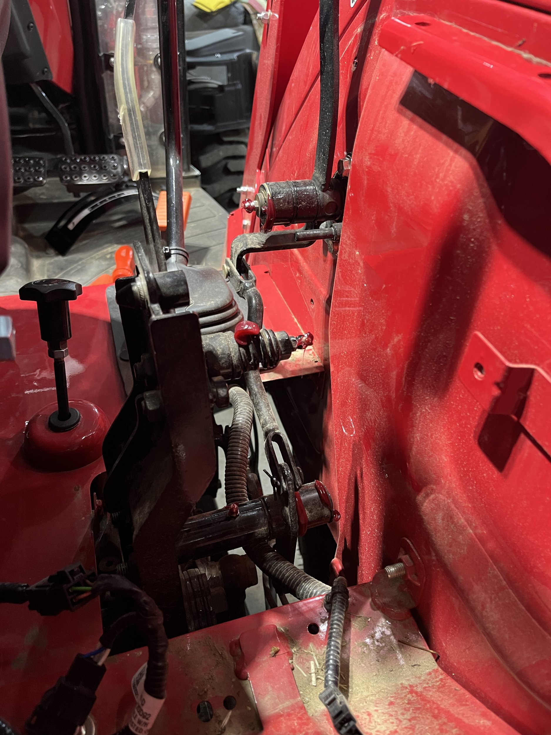

I must thank you all, I didn't realize those grease zerks we're there, I have notice my clutch being just a bit crunchy feeling, I also noticed that there are two on the brake side as well, it's good to go now...thanks again! On a side note , most of you may already know this, but I make sure to scratch the factory paint off the grease zerks before greasing, little micro paint chips could clog the zerks down the road 😁😎
John
You say there are two zerks on the brake side as well. Are those both under the floor mat as well?
