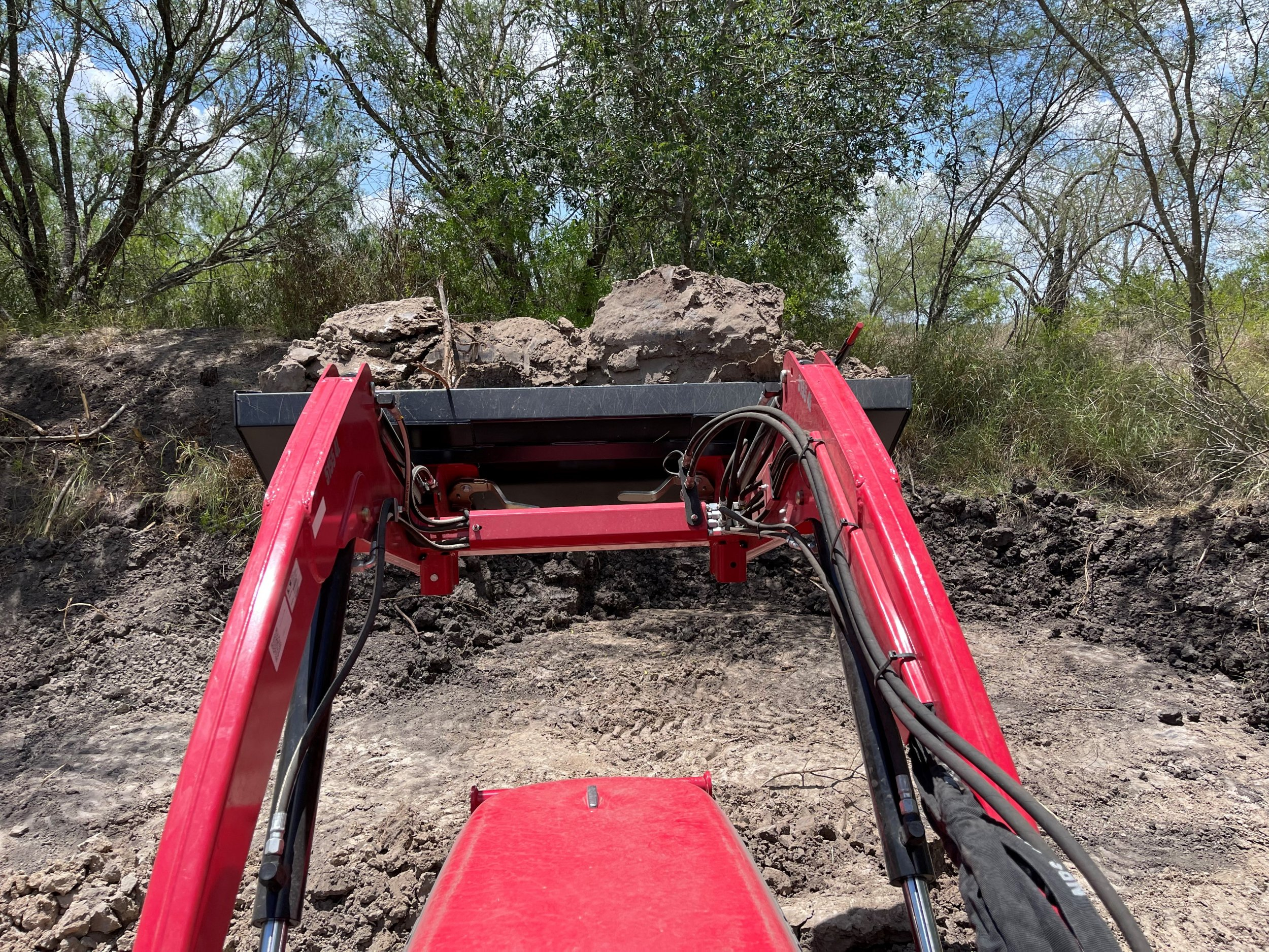

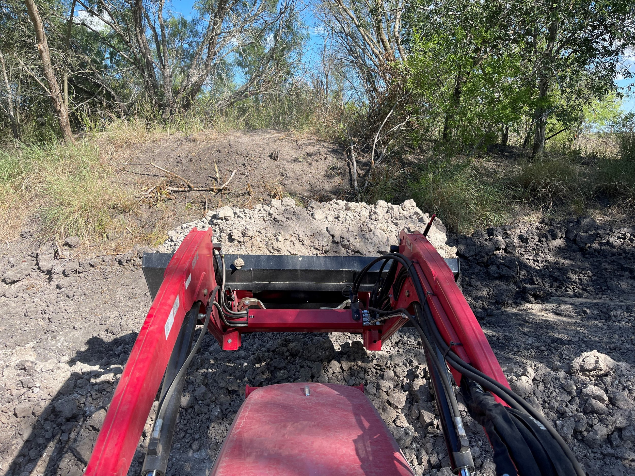

also with how well this thing digs without the tooth bar i do not think i need it, these photos are undisturbed packed soil or clay without loaded tires just a box blade on the rear.

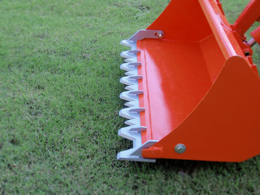

Nope, it does not match the hole pattern of the bucket. The way it is designed, it basically clamps itself to the cutting edge with wedges, then is secured with one bolt on each end through the side of the bucket. So, drilling one hole on each end of the bucket is required to mount it. By the looks of it, the toothbar should extend under the bucket's cutting edge enough to cover the bolt holes, so if someone wanted to drill additional holes in the toothbar, they could add those bolts. I may do that for peace of mind, even though it'll likely be a lot of work drilling those holes... I'll know for sure once I try it on the bucket.

Thanks Walt. That’s pretty cool looking. Send some pics when you get it installed and let us know how it works for you. My 5155 digs well without the tooth bar, but I agree that a tooth bar would reduce how hard you have to push in order to dig. And this should reduce stresses on the loader and tractor over time.

just do 1 or 2 inthe center
