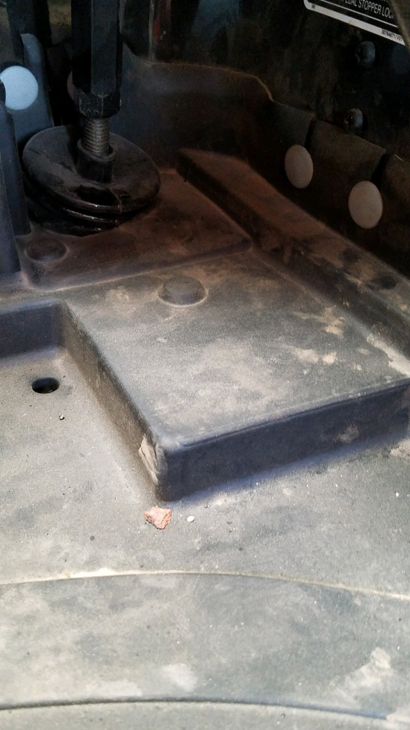

Finding yaupon holly to be a royal pain while bush hogging, they pull pins. Luckily found this one lying on the pto cover, the little spring was nearby.
Anyone want to guess where it goes?
ROPS. Ask me how I know?
roll over bar
