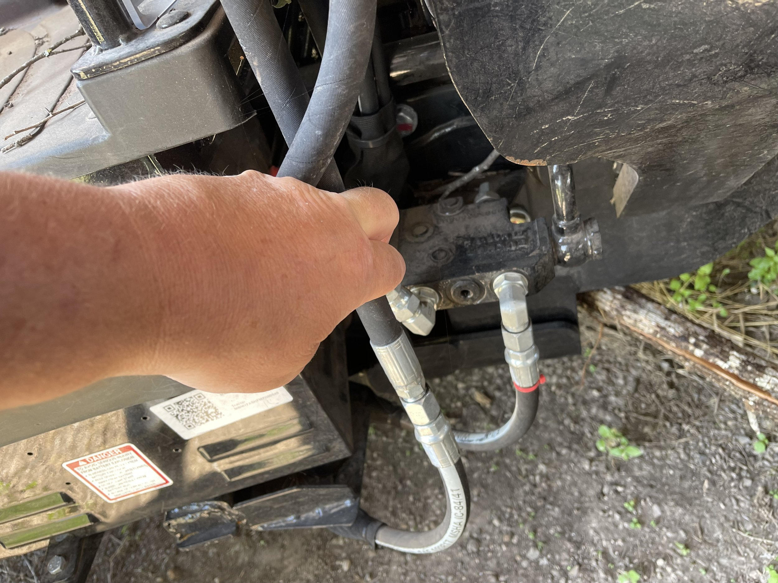

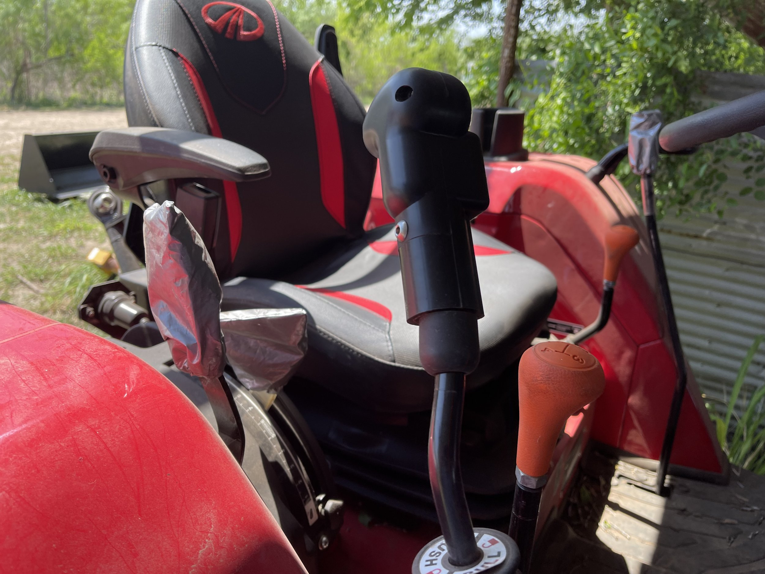

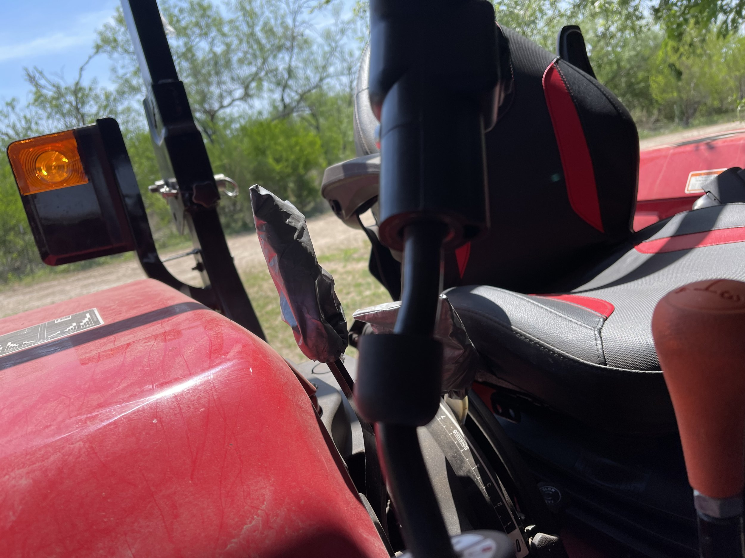

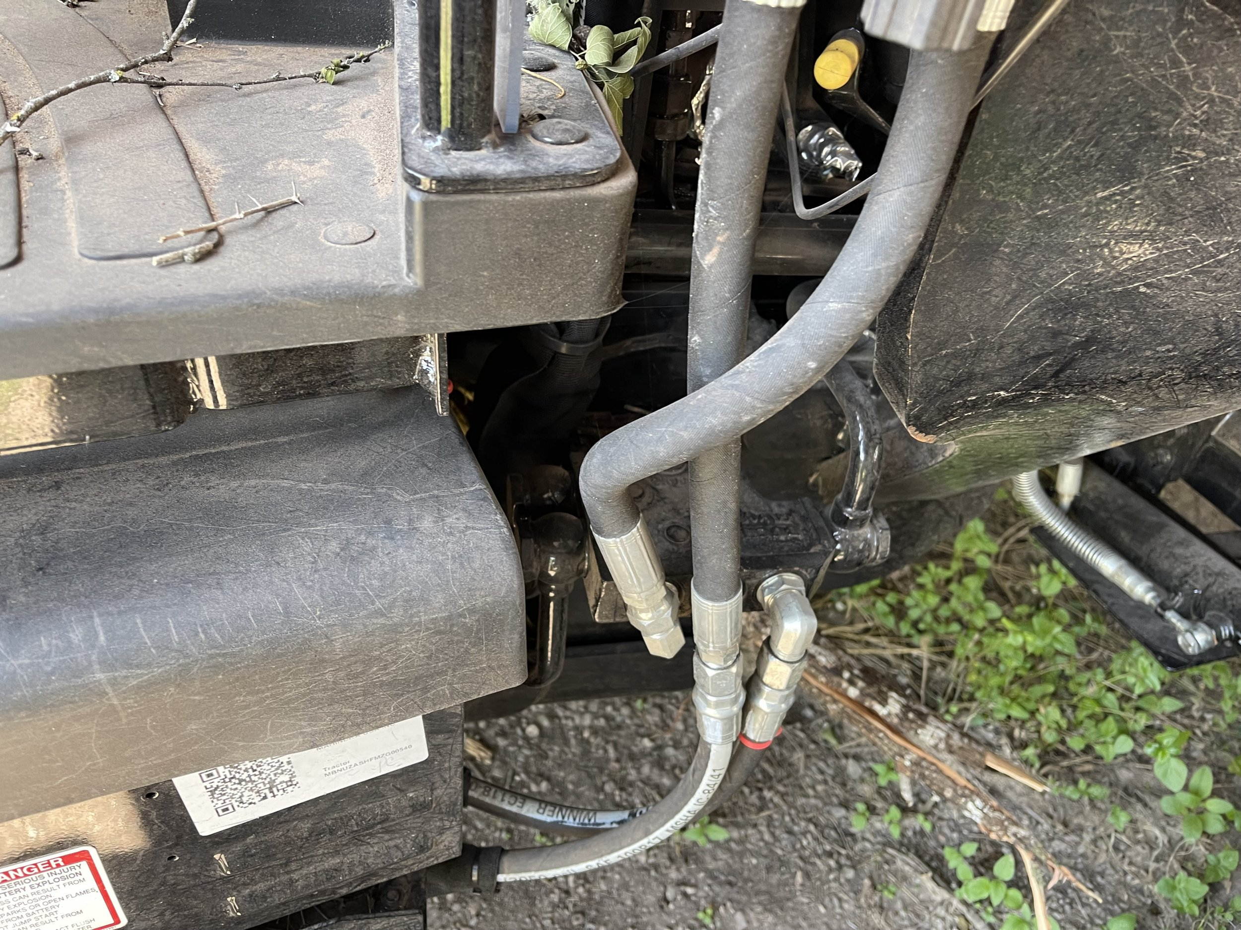

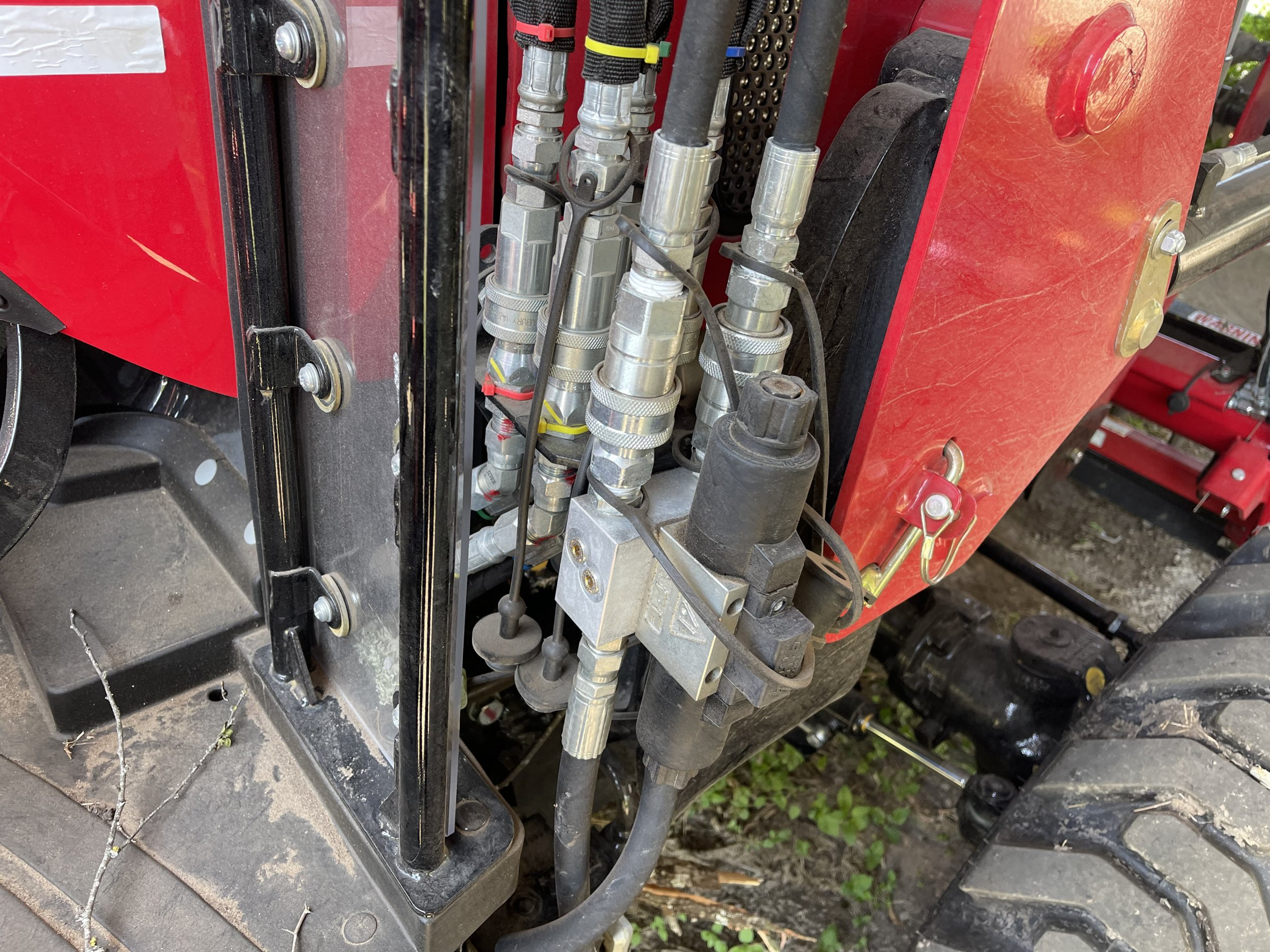

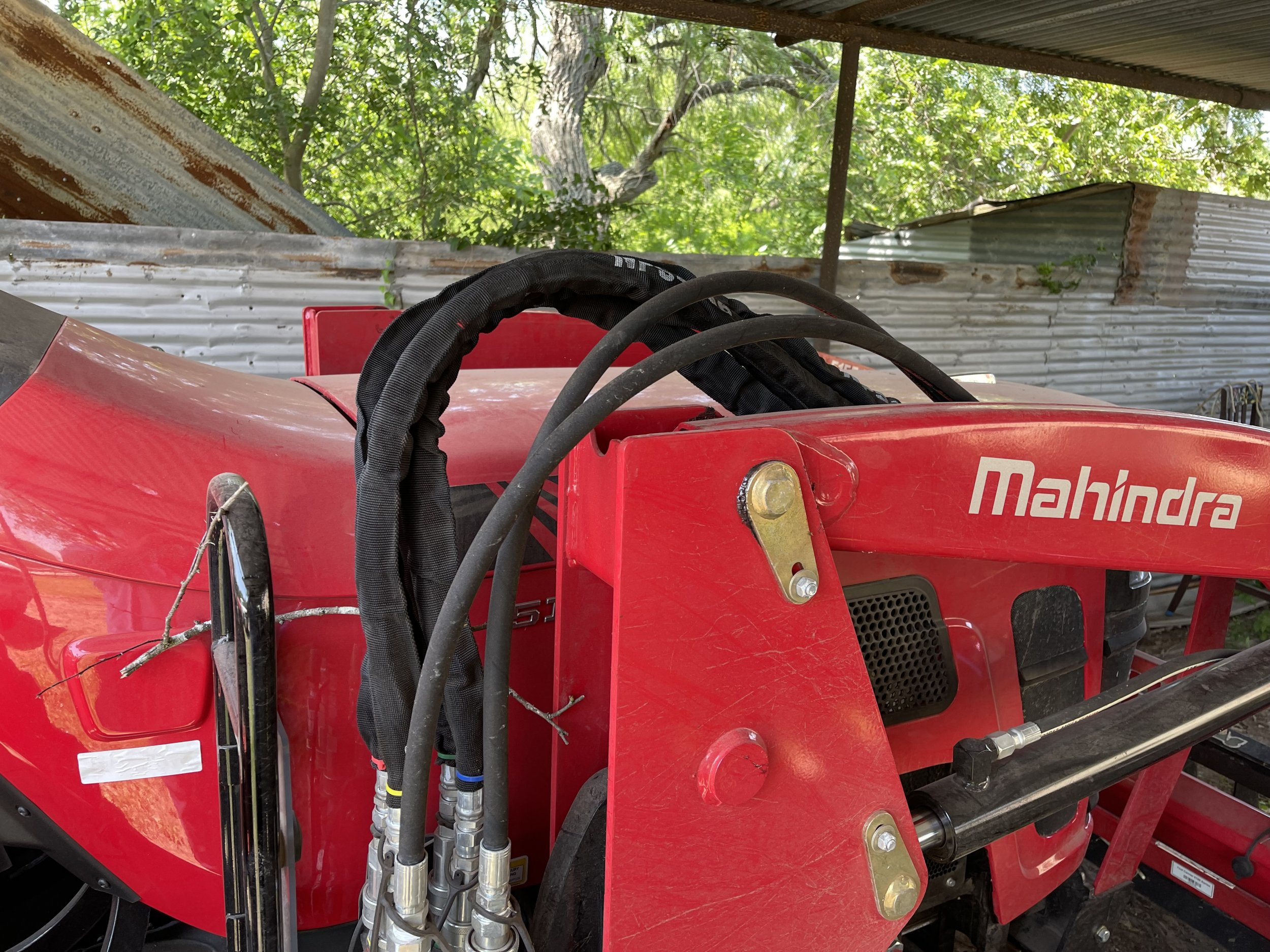

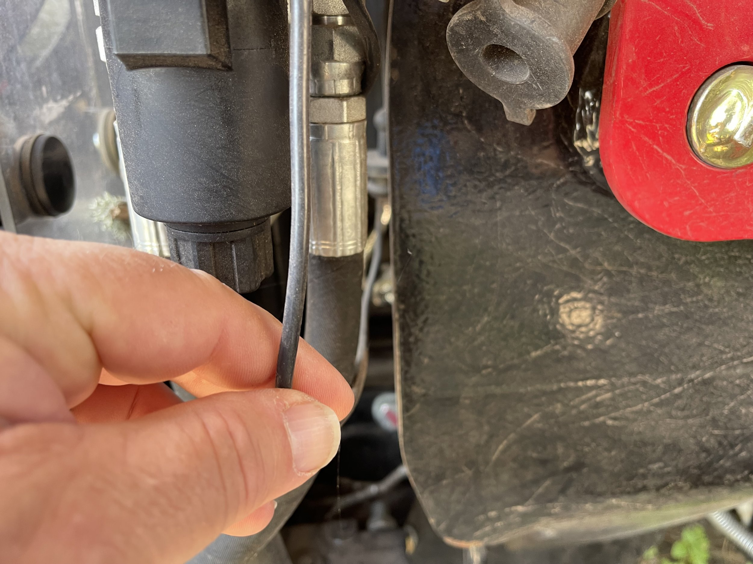

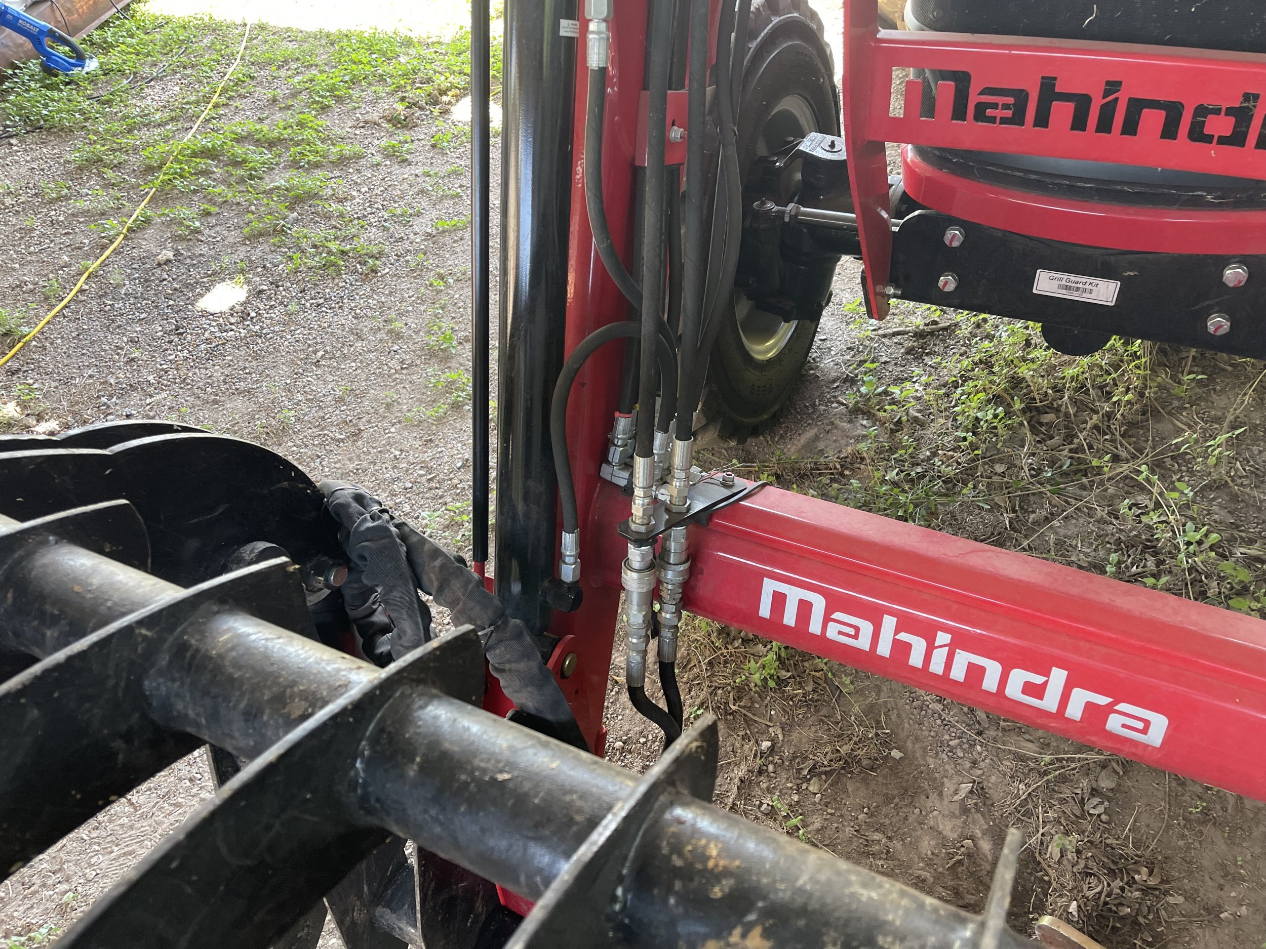

Is that a W.R. Long third function. If you installed it yourself, any tricks to share? The instructions are somewhat brief. Especially where is the loader valve hydraulic block under the tractor. A pic of how it looks after the installation would be helpful. Thank you.+
My 5155 arrives this evening - finally! So excited!
W.R. long, installed by dealer. i will zip tie that hydraulic line that i show pulled away from the stock valve. the hose plumbing is fairly straightforward.
Excellent. Thank you! Received my 5155 last Wed and had to leave for grand kids birthdays in Seattle on Thurs so have not been able to do anything. But first thing when I return is the third function so I can use my grapple. The photos help greatly. Thank you.

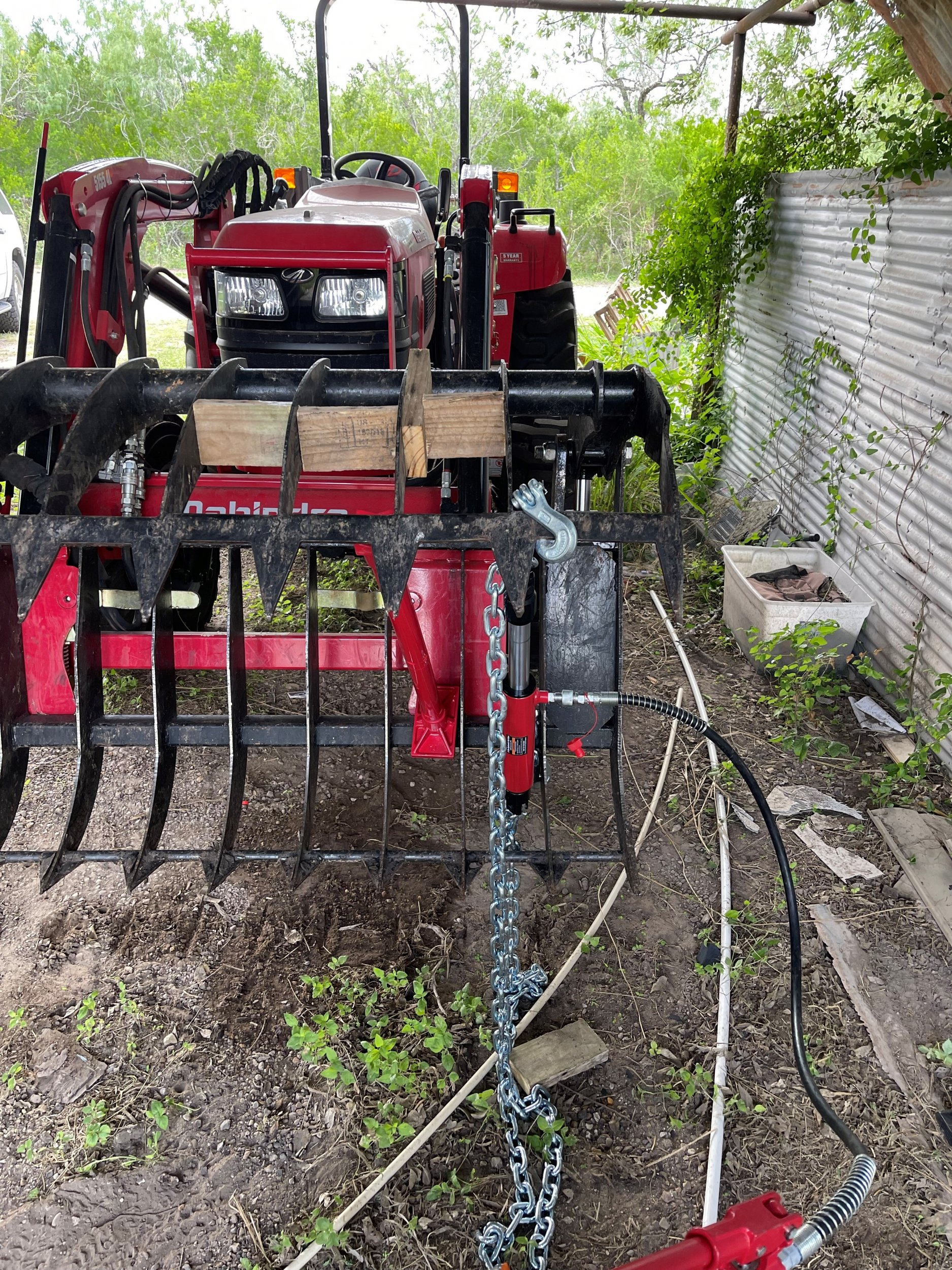

I hope this photo helps also, what not to do lol
8" huesach and too much force, But there is a method to my madness. I purchased a light duty grapple expressly for the purpose of it being the weak link until I gain some experience with the FEL/Grapple, this is the second time I have pushed too hard and each time it is the grapple that has bent not the FEL. in this case i forgot to roll the fel down before pulling back so instead of putting force on the hinge part i put it on the end of the cover, which is the weakest point on the grapple.

i looked at the electrical a little more closely, the tech tied the hot to the starter hot terminal (with inline fuse) i did not find where he grounded it.

I fixed the grapple, 10 ton porta power a pull back ram, 1 smashed finger, not perfect but chicks dig scars right.View attachment 748325
Lol. Yeah the chicks dig it. Grapples are awesome tools. Glad you’re using the tractor. The more hours I put on mine the more I like it. Over the past two weekends I placed and graded about 46 tons of limestone gravel in my driveway. Tractor and loader working good.
