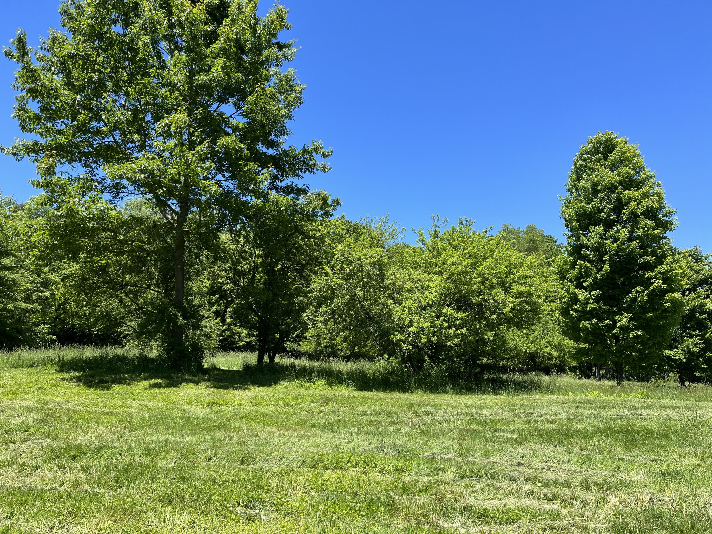

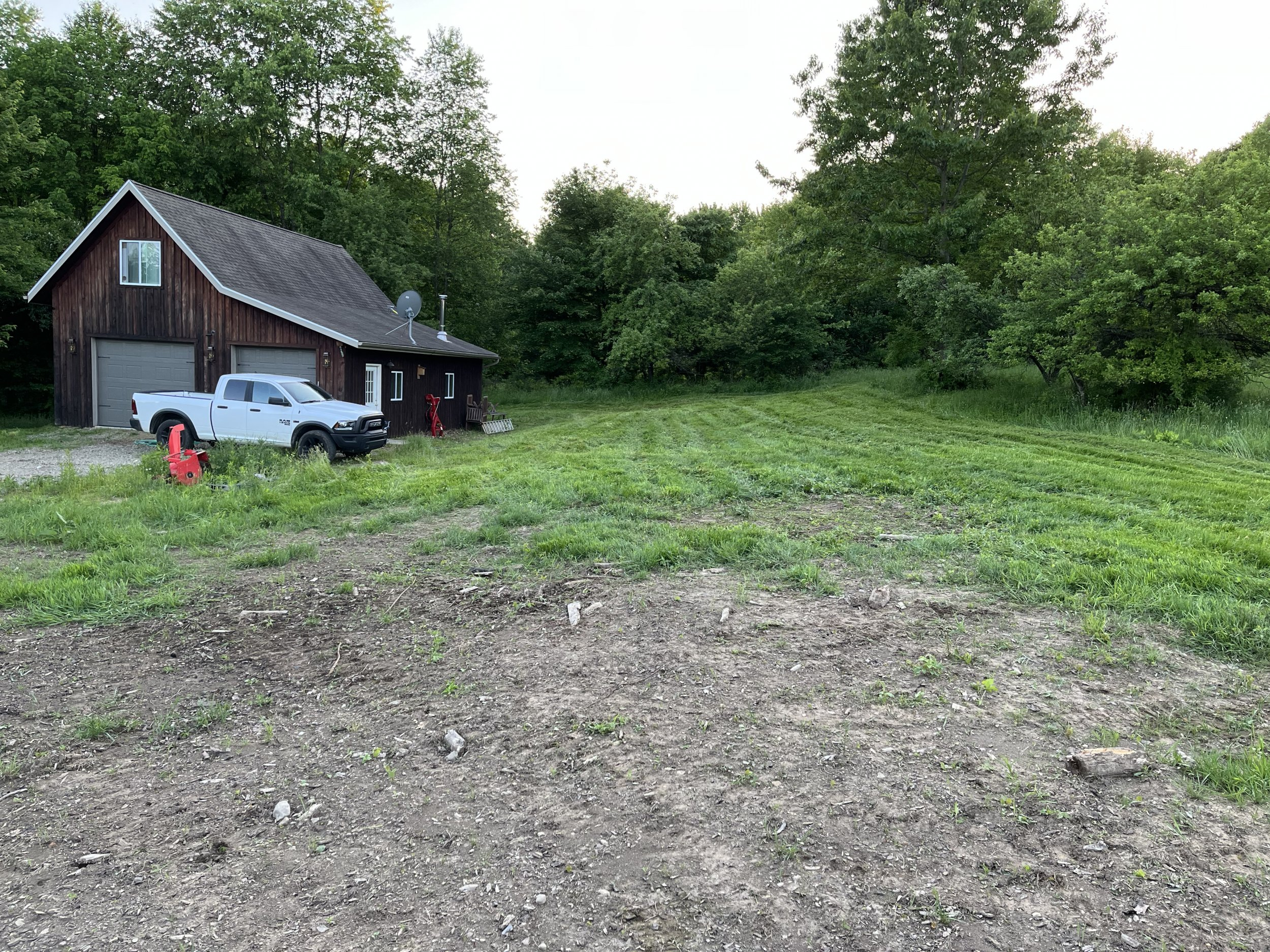

Hopefully DaBear’s issue is simple and easily repaired and explained. That will ease our collective minds. I’ve been using mine a lot more on weekends now that good weather has finally set in. I placed and graded two triaxle loads of 2A limestone in my driveway a couple weeks ago. And this past Saturday I finally hooked something to the PTO! Normally I mow with my little Yanmar 2210D but it’s at my house still. So I had to mount my life 4’ brush mower on the 5155. Looks a little out of place to say the least :rolleyes: So anyway I got a couple acres mowed around my place. Up to 35 hours now and not a hitch. Hopefully it stays that way.
