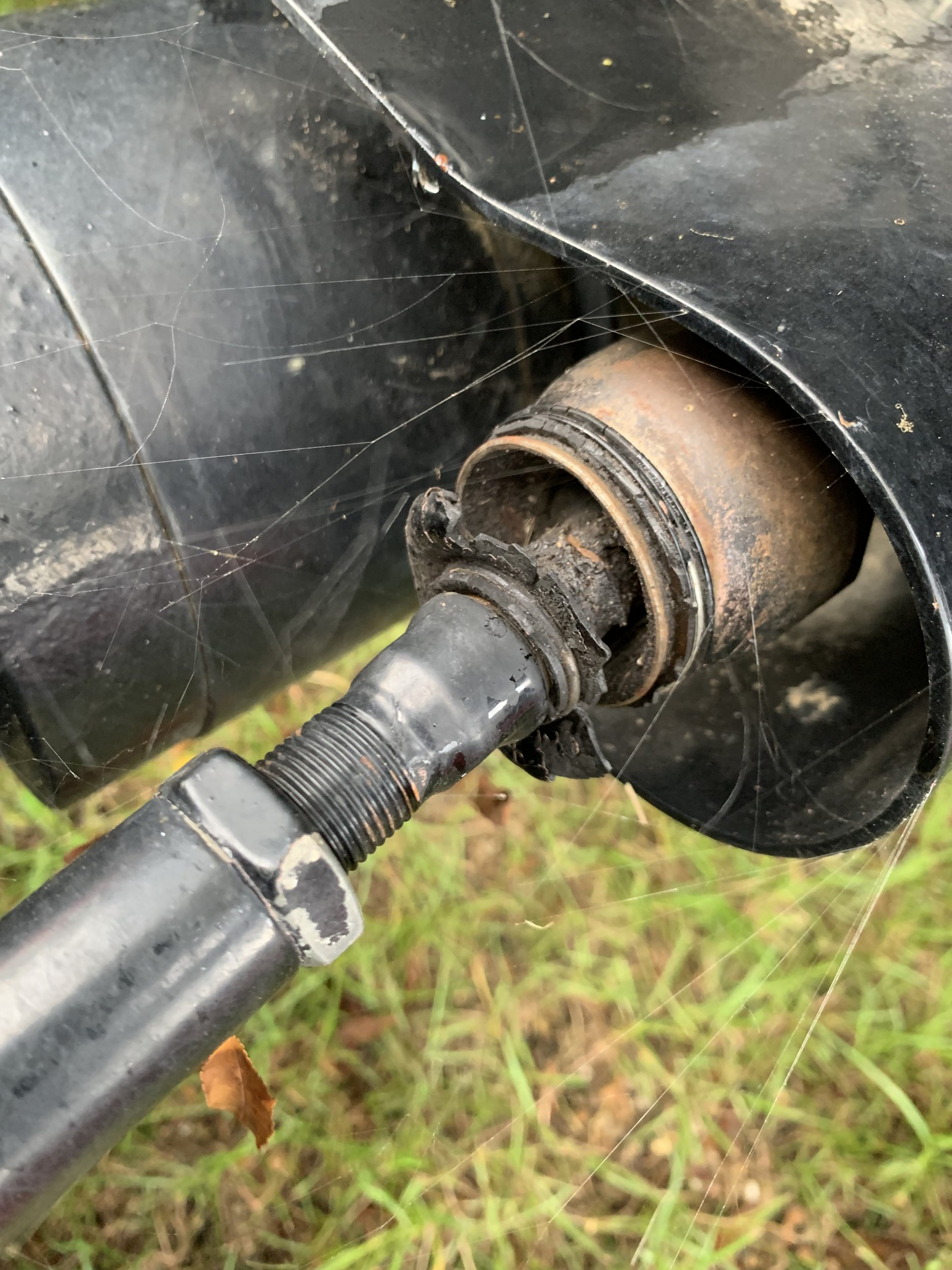

This was the only thing I noticed on both sides. I’ll watch the video again to review. Thanks

What are you showing the readership in Post #5 ? ? ?
I guess the dry-rotted missing rubber isn’t a big deal. Admittedly I have a lot to learn.
I am clueless. What part of the tractor or implement is in the photo?

I have this exact same tractor, Mahindra 4035 PST (2015), and use it frequently. I do all of what you are wanting to do with the tractor, and it has never let me down. I've brush hogged grass that was taller than me, but I did have to drop down a gear, to Low 3. I use it to clear snow in the winter on a 600 ft driveway, something you won't run into. As to the torn boots on the front steering, mine are the same way, I intend to replace them with a CV joint repair kit that you can buy online. Overall its been a very good tractor, that has dragged trees much larger than I would have imagined.
