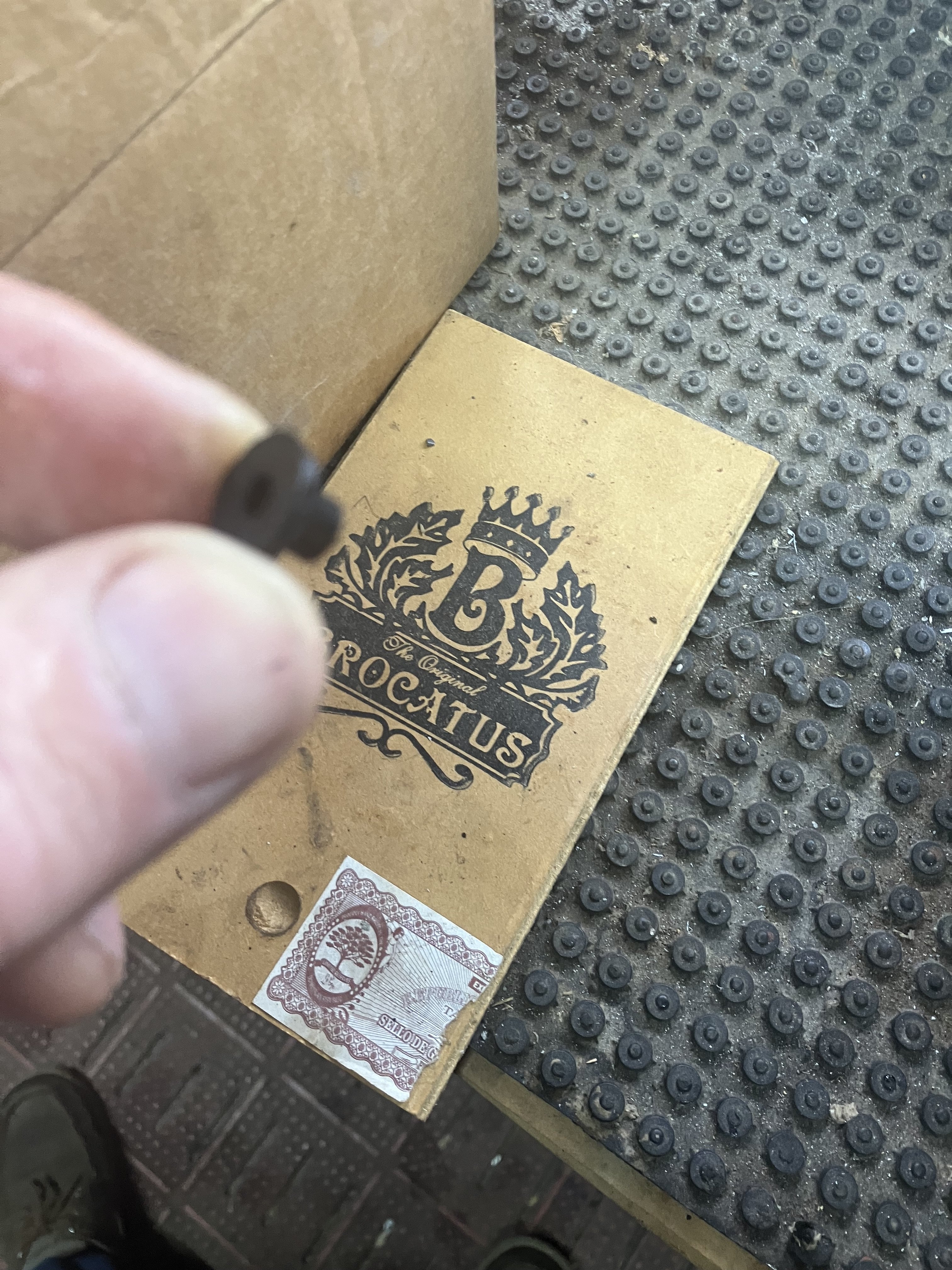

Have a 2015 Mahindra, has 630 hours, clutch stuck but got it freed up. Checking into this further, found the plug in trans for condensation still in place. Hope this will help others to check that there’s was removed when tractor was sold. About a cup of water came out when removed

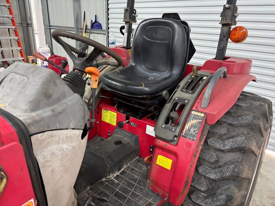

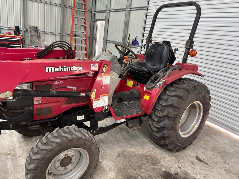

How about this one? 3616 Shuttle 700hrs no def just DOC.
Has ur been ok? 12,500
