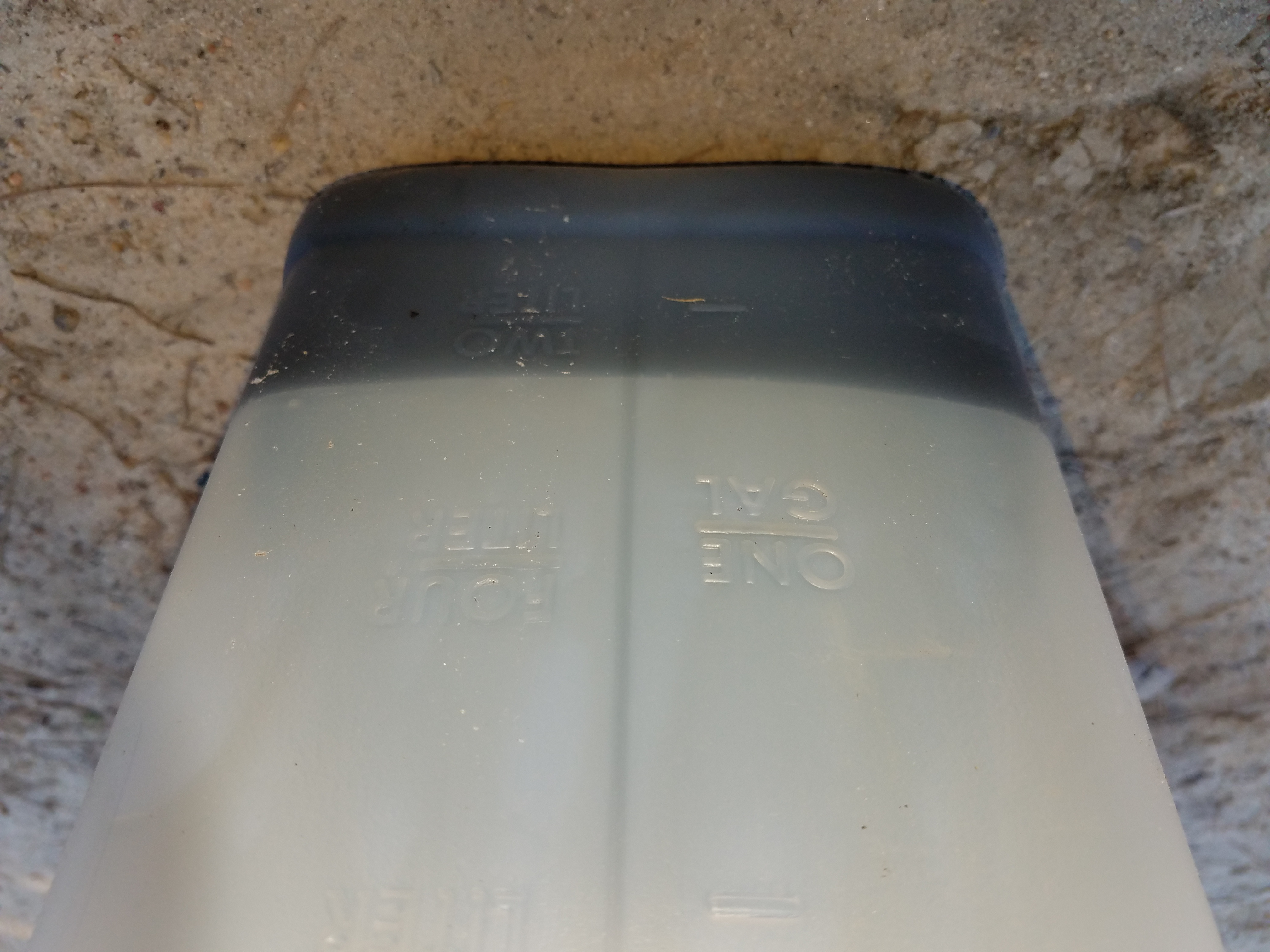

Transmission dipstick:
I too, had a problem determining hydraulic fluid level in the tranny. I never could determine if the fluid was under the view glass, or over it, mainly because the clean fluid is so clear. So I made my own dip-stick. Is it perfect? No, but it get's me within 1/4 inch of the level of the fluid. Close enough for gov't work.
   / Mahindra 2545 on sand #173
The mahindra oil is purple so it is fairly easy to see in the sight glass but the factory fluid was difficult to see. I have heard of guys adding food coloring to the fluid to make it easier to see.

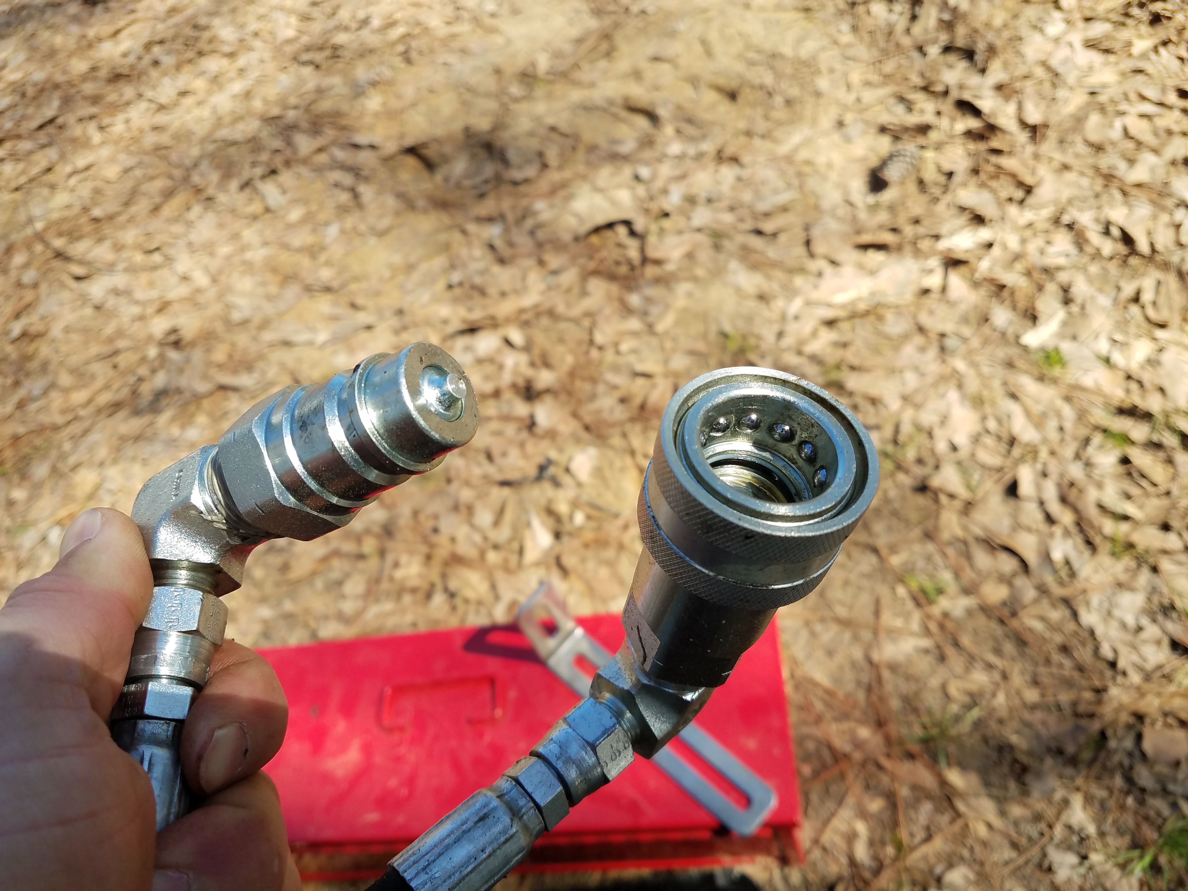

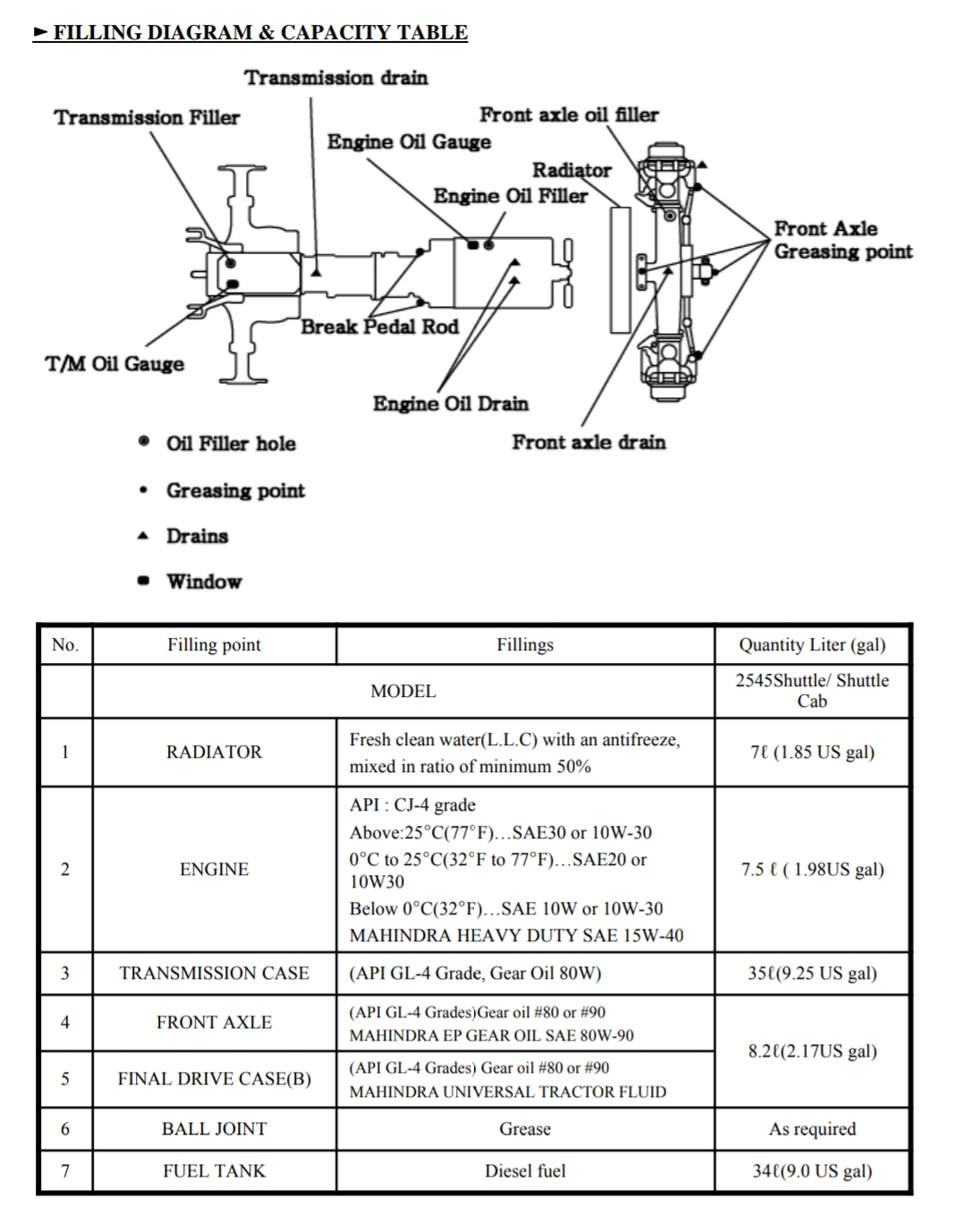

How much 80w does the front axle take?
Also - are these 1/2" SAE flat face couplings?

So that question about the front axle oil was a trick question. As per the manual I would expect it to take 2.17gal. I bought 3 gallons of gear oil and drained it.
Less than a gallon came out. I poured most of a gallon in and it was overfilled. Not to mention the diagram in the manual shows the fill location on the wrong side of the tractor.

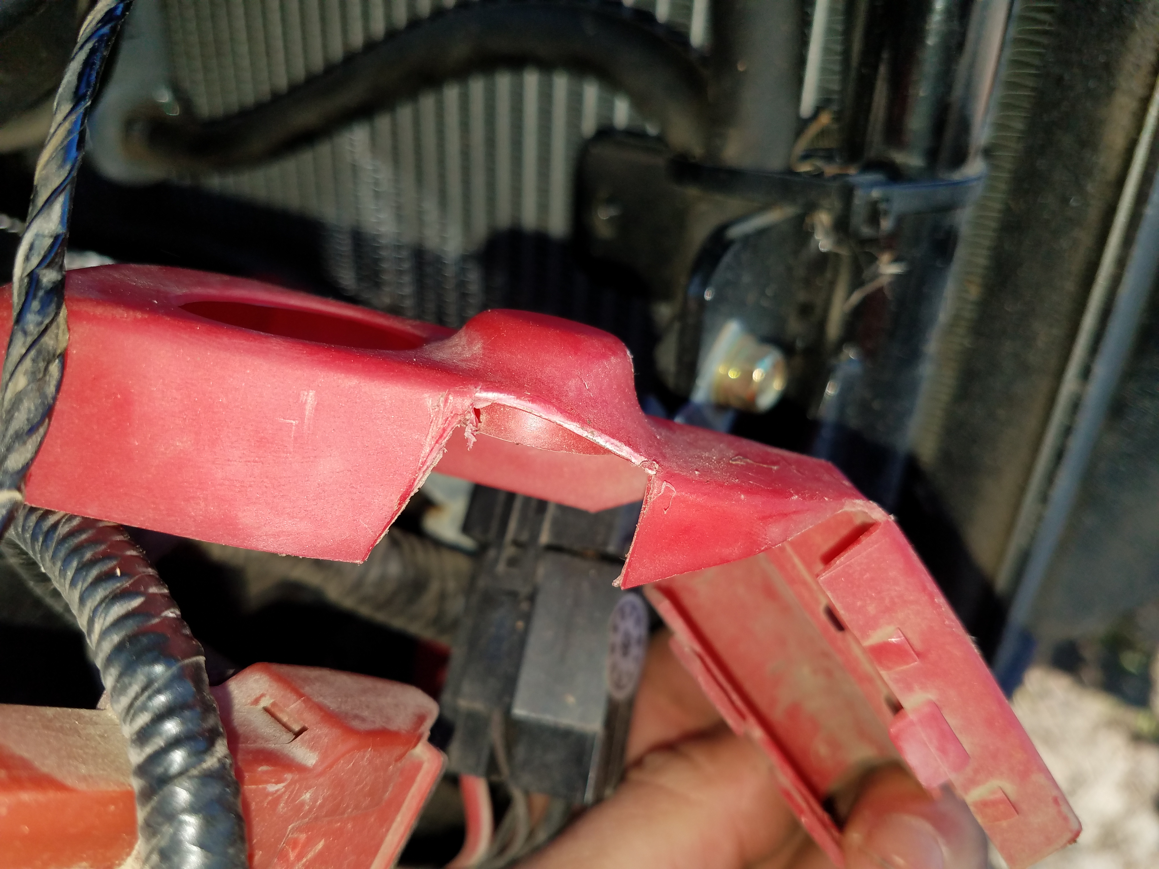

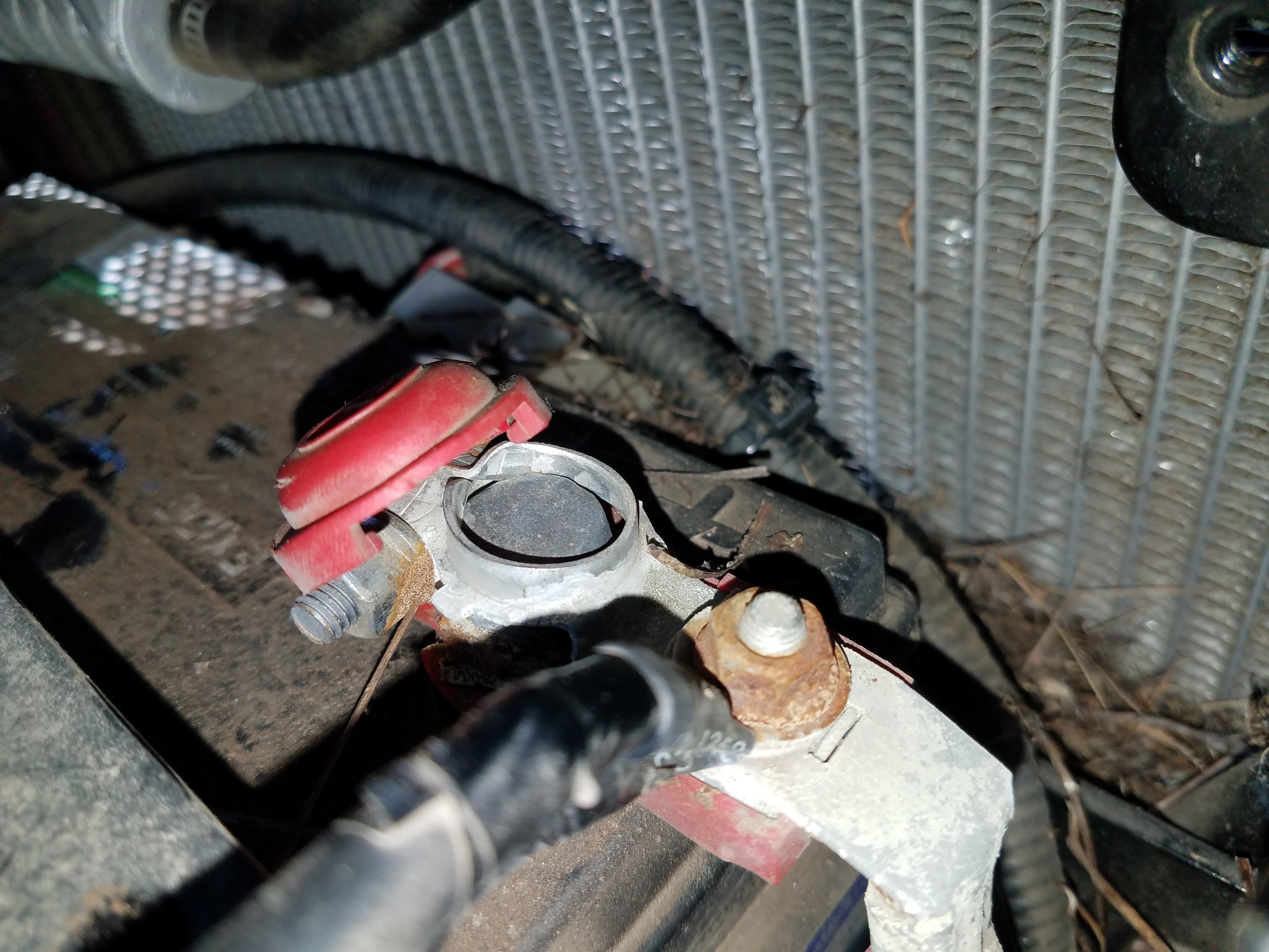

Lastly, I was cleaning the rad screen and this was loose, just bouncing around.
Not sure what happened here..
Lastly, the listing for the grapple said it used 1/2" flat face couplings. What I bought as flat face couplings is not what is pictured. I think those are AG couplings? Help would be appreciated.
   / Mahindra 2545 on sand #179
Those in the picture are ag couplers and they should have letters and numbers on them to identify the maker and size.

I really appreciate the reply.
The ad says the RK5 comes with flat face couplings so that is what I bought. You confirm what I thought (I'm just learning about the different coupling types). I'm going to call MTL and see if they will make it right. I actually called them when I was at NAPA to ensure I got the right male/female parts to go with the attachment. I ended up having to text as they were closed but I got a reply that I needed male and female.
From the ebay ad:
Fortunately I've already had two fitting debacles already and am not even aggravated about the fitting mixup. A couple more days waiting to play with my grapple won't kill me..
