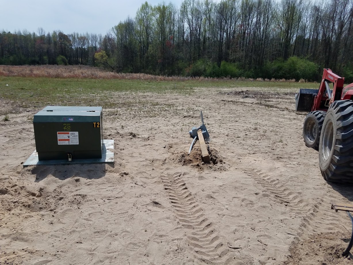

We finally have power at the house! Wait.. We had temporary power at the house..
I've been working on this land a couple times a week since I got the tractor. I got way too accustomed to being in an open field with absolutely no obstacles. I'm still embarrassed about the pole. It stood right back up due to the sand it was originally placed in. I was looking over my shoulder at the rake and didn't even slow down until after I had already made contact. Glad I hit the pole and not the transformer. Death by electrocution, while tractoring.. Sigh.

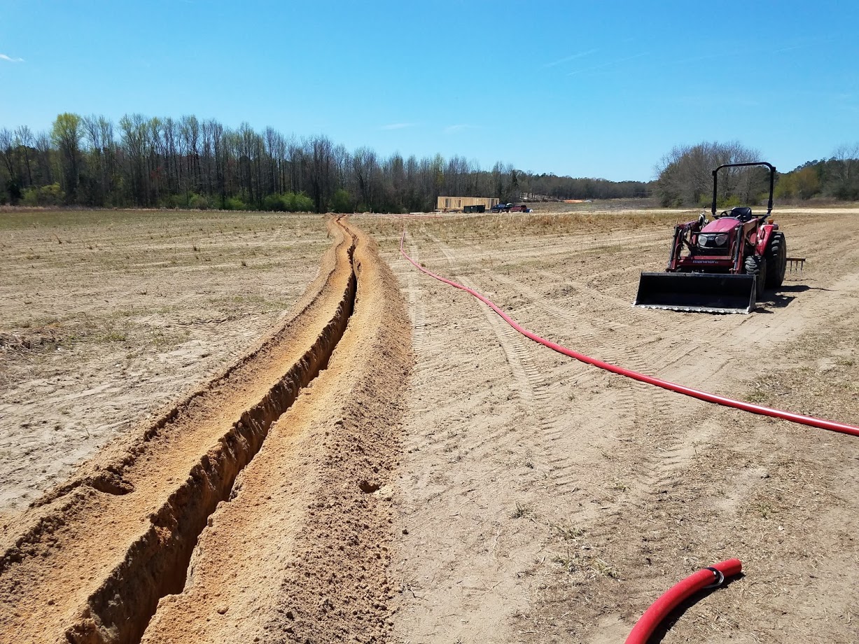

I mentioned there was a lot of sand on the property. The power company had to actually get a different piece of equipment out to trench the power line due to the trench continually caving in.

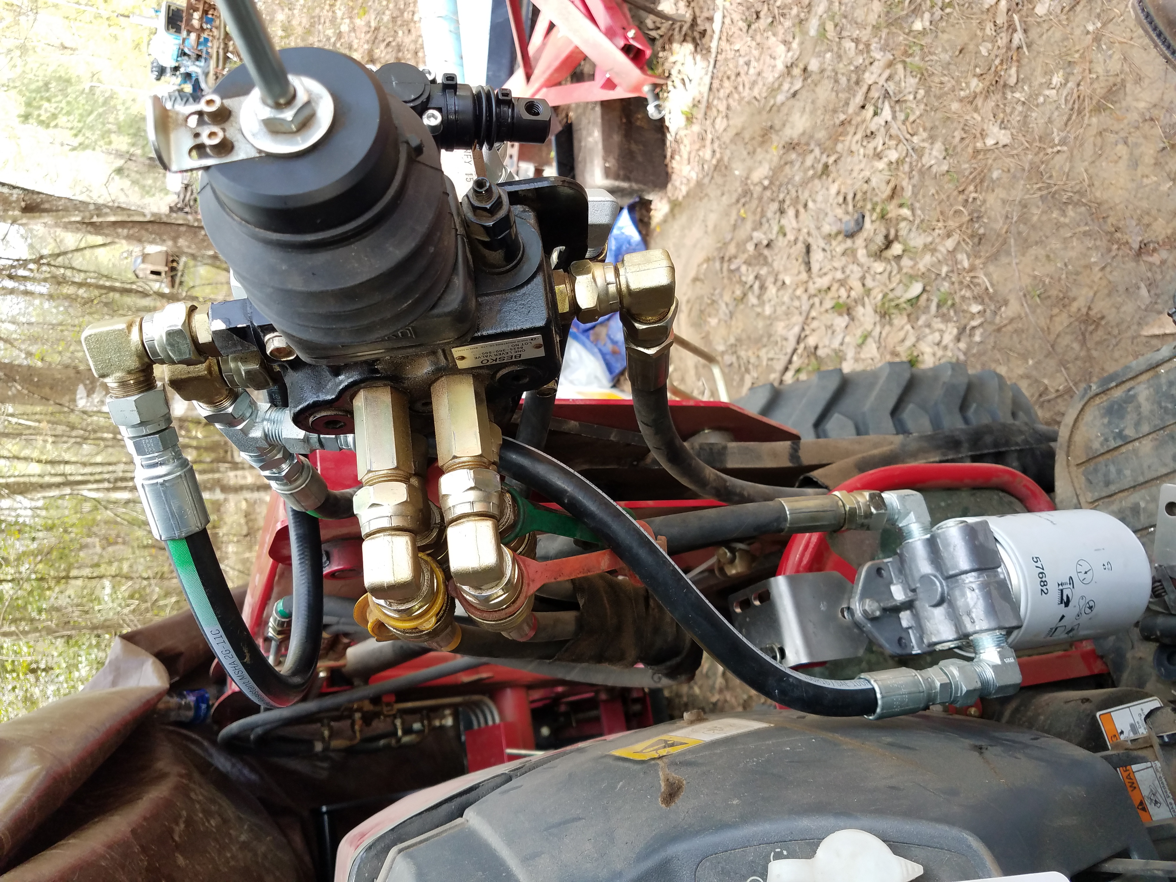

This isnt the final bracket for the filter but I did finally get the 3rd function plumbed and functional. The final solution will have it almost flush with the plexiglass, further out the way. Valve handle isn't attached here but I did test the grapple and everything looks good. I wish I'd gotten some of the hyd cables 1" shorter, I measured to the base of the threads and obviously none of them bottomed out as they are tapered threads.
The filter is microglass element, 12-15gpm. Not sure of the micron rating, it isn't listed. This filter is used on a bunch of john deere zero turn mowers.

Only issue with the new valve so far is that the ag fittings leak under pressure. Im tempted to get a threaded coupling and be done with it. Grapple is cool, though. Moved some cement they spilled when doing the foundation and moved a bunch of Brush into what is going to be a massive fire in the near future..
[edit]
I'll post up a parts list for the valve addition at some point. FYI, the filter I am currently using (WIX 57682) doesn't have a micron spec on the sheet but after some research on the beta system of rating filters here are the filtration specs -
Captures 50% of particles at 2micron
Captures 91.7% of particles at 12micron
Captures 92.9% of particles at 75micron
