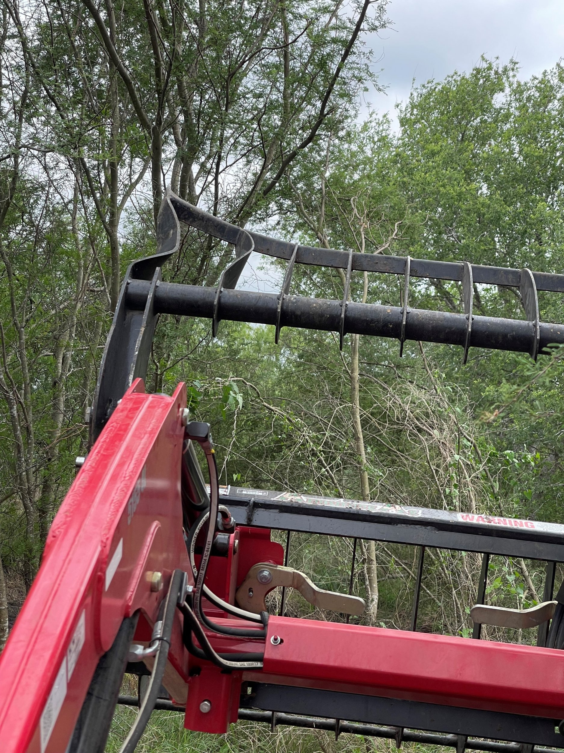

I was looking at a universal one but wasn’t sure how they’re sized, thank you for the answer. My brother in law borrowed the tractor and used it to try and up root a large tree. Lesson learned to not loan out equipment.

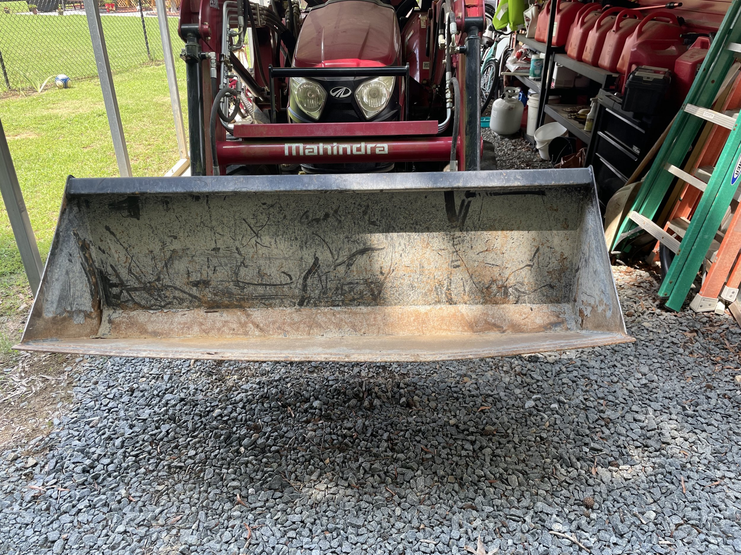

/ Mahindra 2538 loader bucket
It hits bent at the bottom

A good welding shop that’s used to working on farm equipment could fix that
I have a very slight bend in my bucket from a stump years ago but not that bad
The cutting edge is replaceable, needs to be torched off, then the bucket straightened out and new cutting edge welded back on
May cost half of a whole new bucket

What happens when you use a light duty material bucket for prying with. I've repaired many of them but it entails cutting the side sheets loose and then heating the floor sheet and bending the floor sheet back straight and then rewelding the side sheets. What happens is the floor sheet pulls the side sheets inward when you bend it. People aren't aware but with most tractors you can get an excavation bucket (which has a double floor sheet and bolt on cutting edge) or a light duty material bucket and most tractors come with the light duty bucket standard. I have both for my Kubota's, but you have to specify when you order the tractor. That can be a painful and somewhat expensive fix.

Really! That can't be "massaged" back into place with a sledge hammer.... ;)
I would ask him to pay for the repair or a new one, family or not.
+1 on a metal fab/shop, any good place should be able to get it back in shape, but check pricing either way

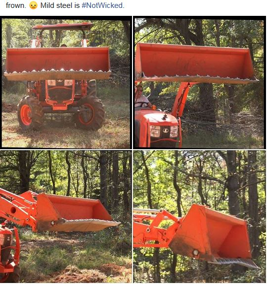

I think it could be straightened, and then add a Wicked Toothbar to make sure it doesn't happen again!
We know first hand that a piranha isn't up to much punishment..

I have bent them far worse than that. Straighten it the best you can and get a 4" wide by 1/2" plate welded across it. I would have to go back in my pics to see the worst one I did :). Yours looks good.
Travis
Really , my pirahna has been used pretty hard and itis still like new, Im sure your product is good but to trash someone elses whrn there are lots of people on here with pirahnas and love them is wrong

Beat it out with a 13# sledgehammer and put at tooth bar on in it, call it done!
