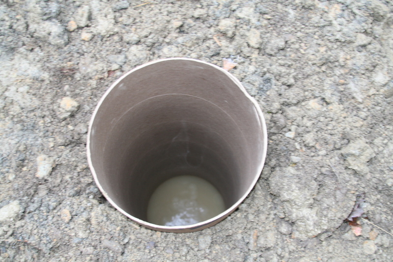

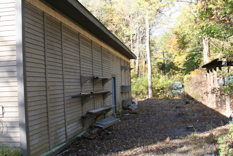

This shed roof was in the plan 20 years ago when I built the barn. 12' out and 64' long. I am just getting to it. As always water in the hole. Wet vac it out, muck out the bottom with a hand post hole digger if the building inspector is around. We drilled all the holes (5) first, then put the mixer on. The mixer worked well , limited to 6 80 # bags due to drive shaft limits, also had to hoe out , but that is nothing compared to mixing by hand. We could have gotten a metered truck but it was 1/2 yd and they have a minimum. Probably could not have reached anyway. 12" x 48" tubes 42" in the ground. Planned 6 80# bags per hole. It was slightly less had one bag left . One hole got away from us, 3" out but it is still ok. Problem is putting a 12 inch tube in a 12 inch hole. But it was either drill or backhoe. Rather drill. The TC34 worked great, we rolled back and forth a bit and used hyd tilt for side to side, to open up the holes a little bit.
The tractor never even shook. Took 5 hours to drill and place the concrete, broke for lunch and then laid out and put up the ledger board just under the soffit on the barn wall. Used 3 5/8 girder lock screws, every 2 feet . Drilled the ledger and drove them with a cordless hammer drill. 6 x6 posts on site , post caps came in wrong. Have to wait for a week on concrete cure anyway. Next Thursday is the plan for posts , girder and rafters. Ordered the steel roof yesterday. Rafters and purlins on 30" centers. Rafters had to be 2 x 8 Doug fir . Girder was interesting 16' between posts 3.5 x16 LVL.

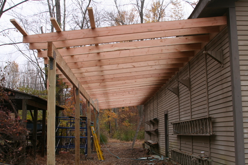

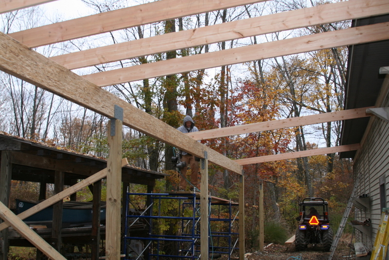

Update. Posts are in, beams are up, rafters are up ,perlons are up. ends are not trimmed yet waiting for the steel panels so we can see how to end it exactly. Facia board all around I think. Galvanized drip edge on the gable end and just an inch of roof deck overhang on the soffit. I hate gutters. I think a trench with a textile wrapped pipe at the drip line, going off someplace. I will put down geotextile and 4-5 inches of 3/4 gravel under the roof. The post anchor and cap hardware is some rigid system. When we plumbed the posts after they were anchored we were pulling the 400# 12" diameter x 48" concrete slugs . The Simpson screws are really nice , don't have to line up bolt holes. Li Ion batteries on the impact drives lasted the hole row.

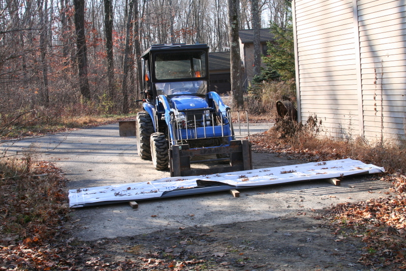

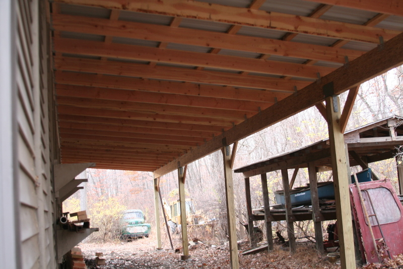

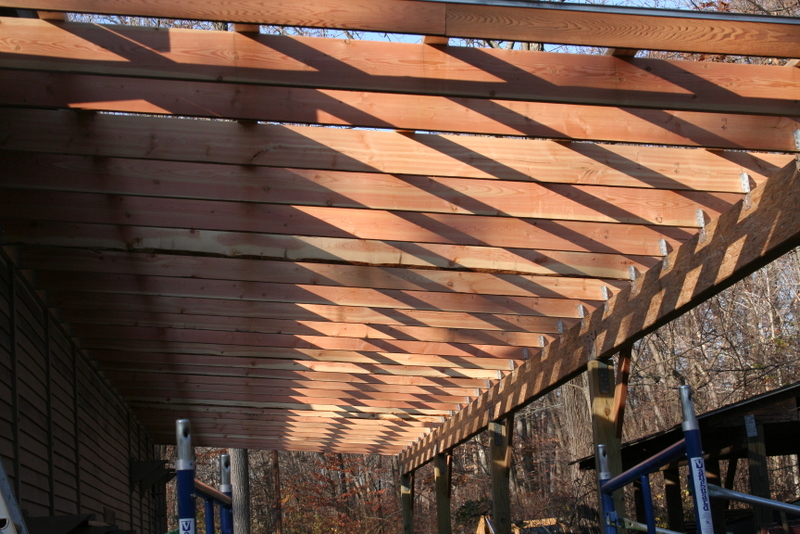

Update. Carpenters never showed up. Guess they have enough work. A friend and I started and finished the roof panels. 22 panels in 5 hours. Need to put in more screws but it will hold for now. Fel would not lift high enough and my MF hoe quit running again. Fuel delivery. It was a nice day and I worked on top and my friend handed them up. We had a scafold so we had a landing half way up. 14' long panels. 66' long roof so it was a long carry after half way.
Next time I will get a picture from up on top.
