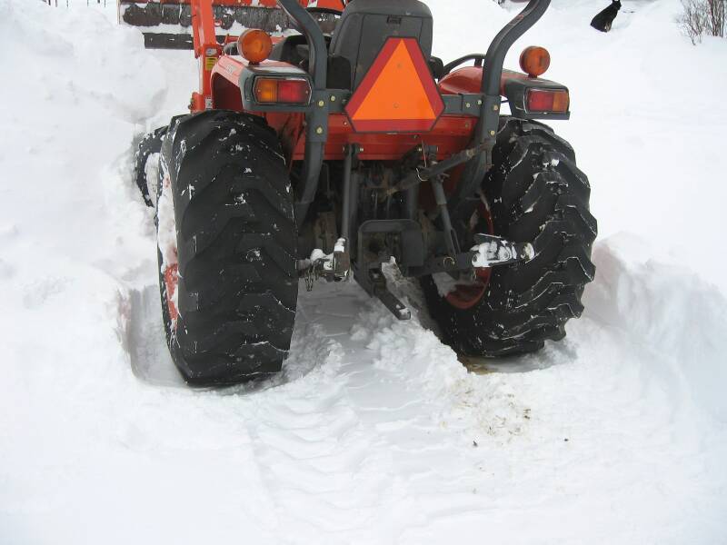

Got stuck on flat land with R4 tires. Had to push out with the bucket. 20100206_MD_Blizzard%2020%2B18_6113.jpeg
