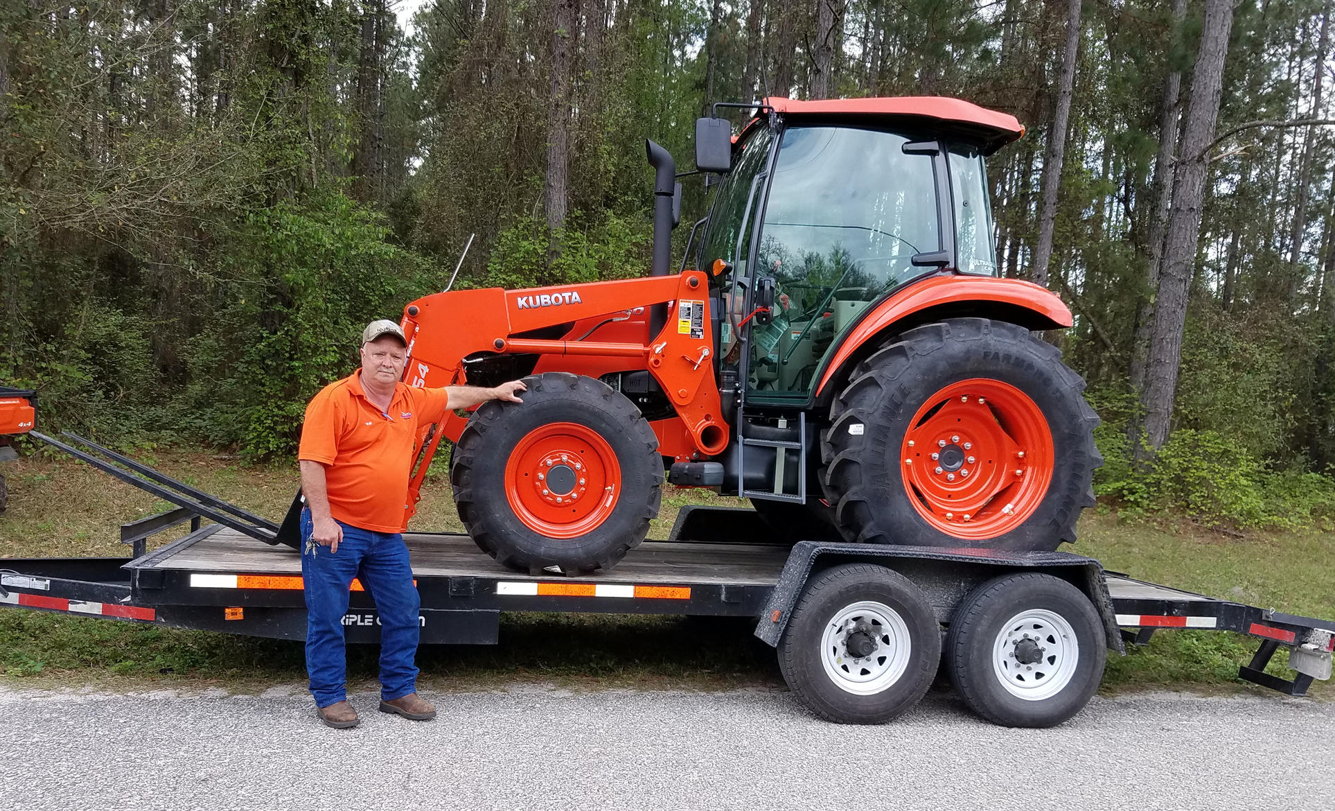

Help, rocking horse ride, I've got the radials and rears filled with water up to valve stem, at 10 12 mph it rocks for and aft any cures? Do you the rpm control? when I used shuttle shift with fixed throttle position the computer ramps up the rpm quickly and it takes off with lung?
At certain speeds my 9540 does that. Only cure I know is don't drive that speed.
I've never experienced the shuttle issue you describe.
I've can compare two M7040's. One has Firestone "DT" radials that have lots of rubber in the center of the tread and ride like a car at higher speeds. This is with cast centers and two rear weights on each side. Zero rocking and I think that's because of that tire.
The second tractor is a cab M7040 with cast rears centers and a lower dollar Firestone tire with a more open tread pattern. This tire is more intended for field work and not really for road comfort and rocks to and fro. Neither tire is loaded so my guess is it's the tread pattern that does the rocking. Ovrszd had the right idea to not drive at that speed or under those conditions and that's what I do.
I've had similar results with bigger tractors and different brands where I had a rocking with one tire, got different tires and no rocking.

The rocking horse went away, guess the tires broke in?
   / M7060HSC12 bought #70
It's a frequency issue. The slightest change could make it go away or start. You got lucky. :)
