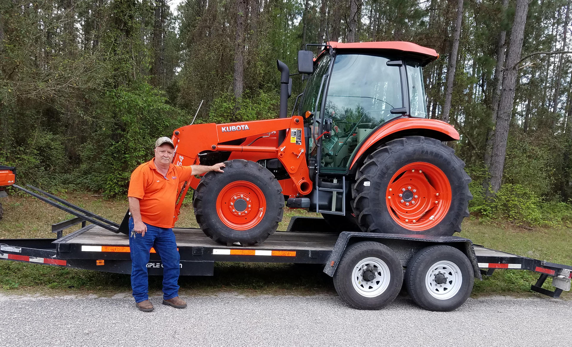

My 7060HSC-12 arrived at the dealer, however the creeper gears, and FEL third port, front grill guard, were not install arrived at the dealer a day later, dealer comment we have no idea why it wasn't installed at factory, two float/detent rear valves were installed, got the radials very happy with them nice fat tall tire with healthy lugs, should shed mud well. Order the T&T from fit-rite a month ago, Monday I'll order the 66" wicked grapple, and toothbar for bucket, front and rear cameras is here along with messicks radio. Should I spend $50 to get the grapple orange? Dealer will water my tires dropped off 4 gallons of antifreeze, told him I want a pressure test front and rear valves, manual says 2750# we'll how close. Getting supplies out to 500 hours and I've already got the WSM For tractor and FEL.
Any suggestions? Now I'll be able to unload the 800# Mep-802a 5kw used mil surplus genset I got two weeks. ago. I believe we are in for many years of bad weather here in Florida, we just had the wettest year since my arrival in 1971, ponds and bogs are filled water tables are up, roads are rutted. I'm not a believer in global warming just long weather cycles, there is evidence on the farms lands around here of water managed going back more than 40 years and talks with old farmers confirm it used to be much wetter.

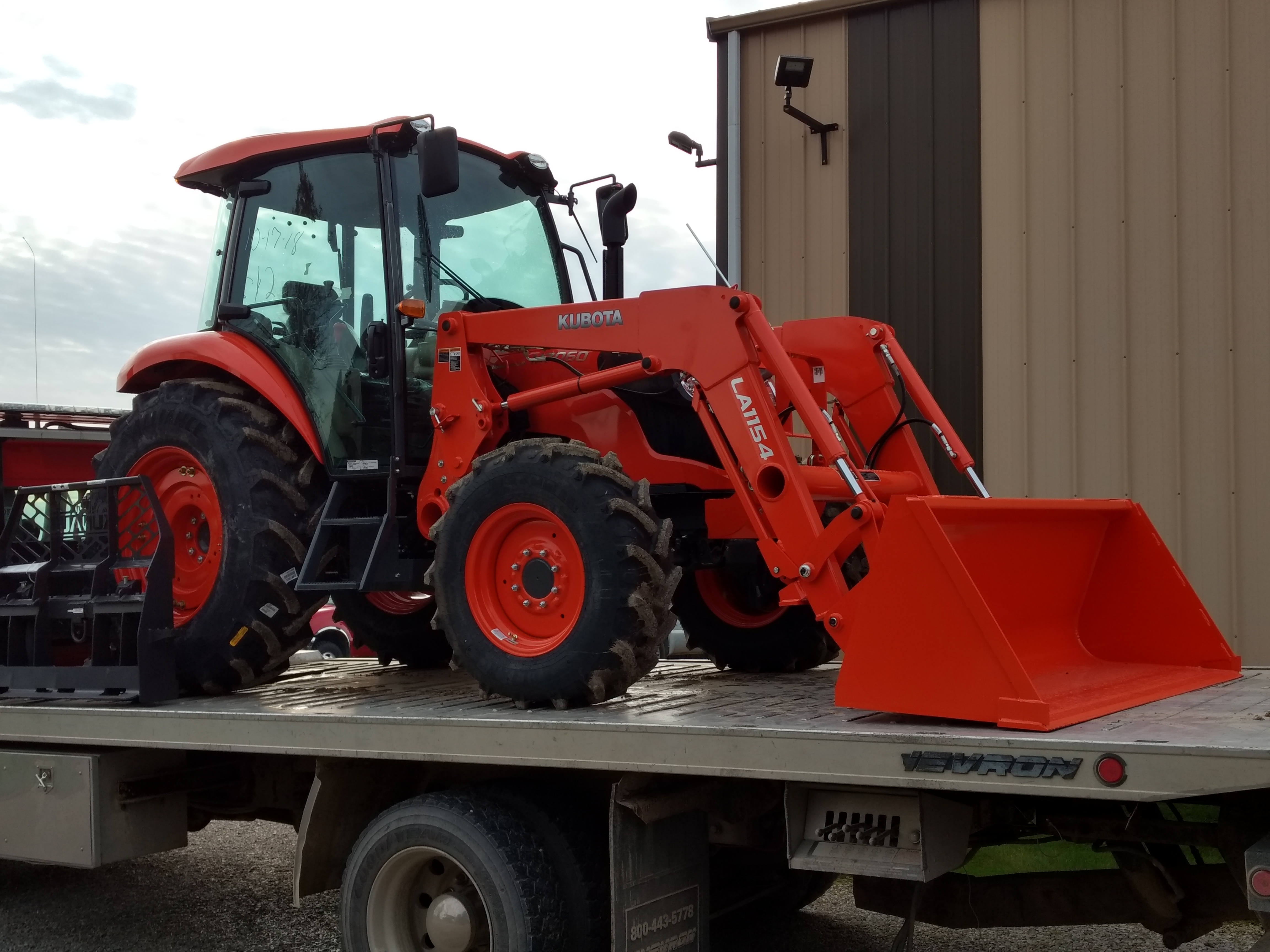

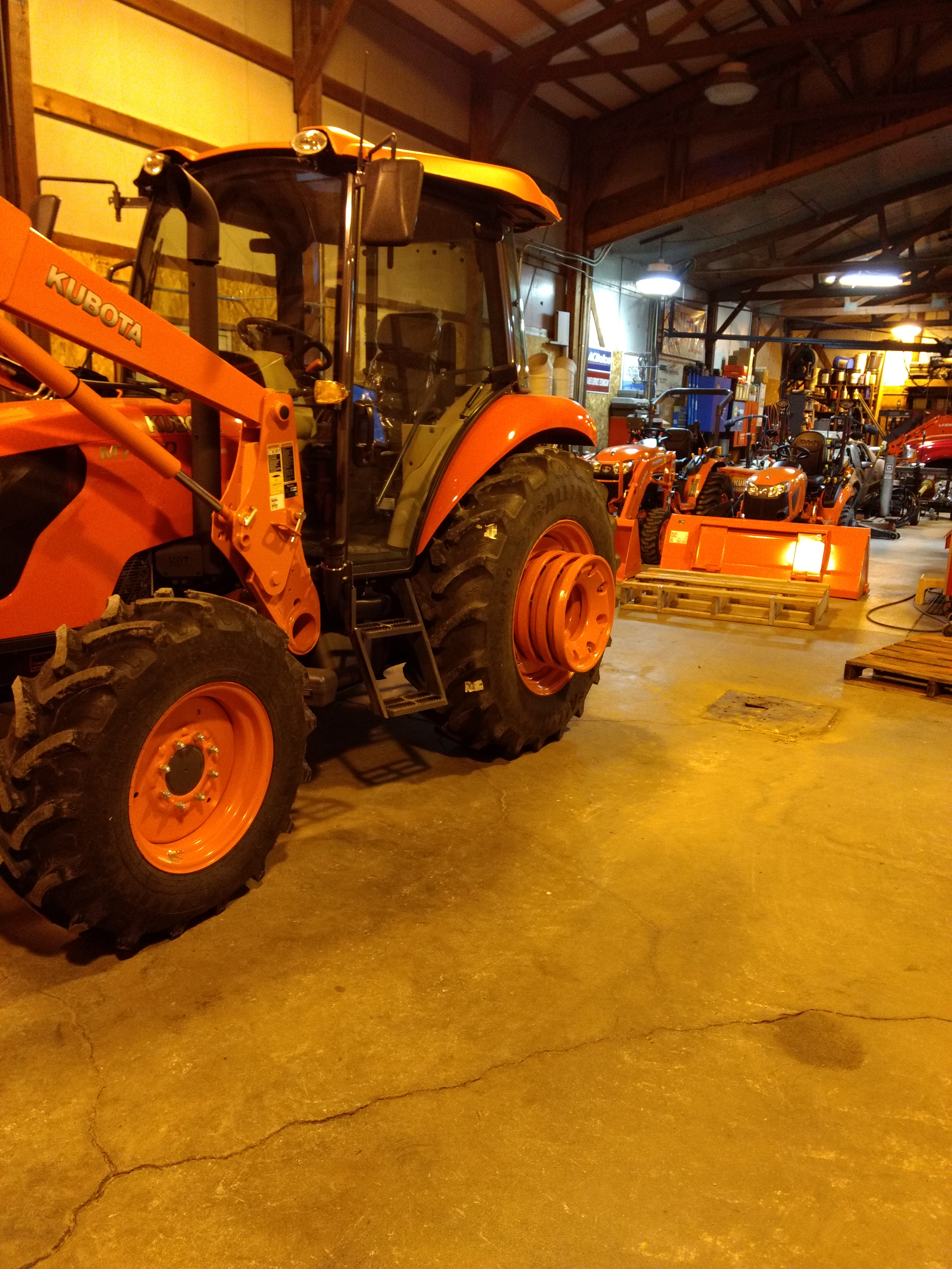

Nice tractor I am sure you will like it. A couple of pics of mine, as delivered then after she put on weight.Phone pics 058.jpgPhone pics 080.jpg
