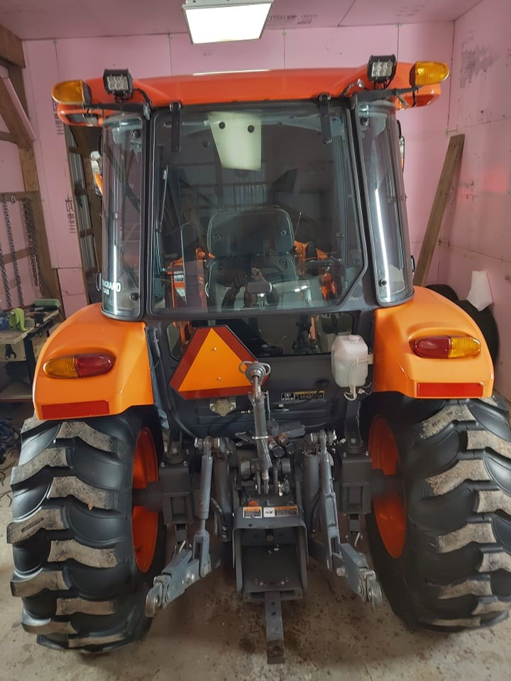

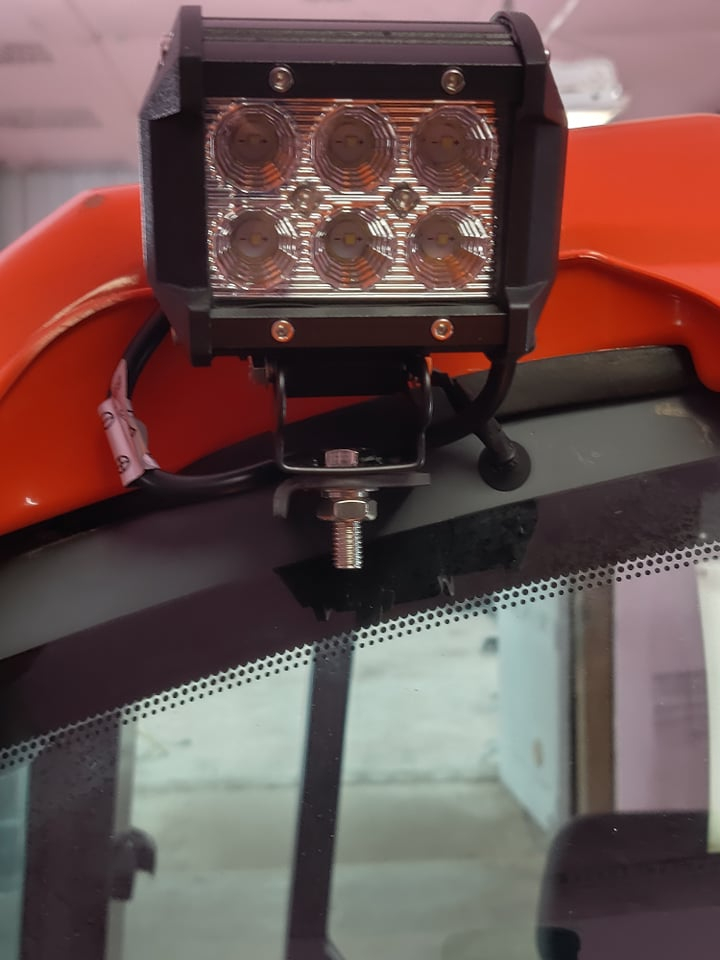

Probably covered a million times but I thought I'd share what worked for me. I changed out the headlights to plug and play LED units. They seem to be very well made are a simple installation and much, much brighter than the OEM.
I also changed out all four of the work lights with these. Also a direct fit to the original mount and of course, far brighter than the originals.
In a couple days the hazard and all other LED indicator lights will arrive and they are also and easy plug and play affair:
Amber https://www.amazon.com/dp/B08W4WQ6QH?ref=ppx_yo2_dt_b_product_details&th=1
Red https://www.amazon.com/dp/B08W4X91YK?ref=ppx_yo2_dt_b_product_details&th=1
Below are a few pics of the lights. All shop lights were turned off for the demo pics.

Hows the RFI with them? I've I need to add some work lights to L but trying to find some that don't kill my radio signal.
The LED's I've used on other tractors were pretty bad, with the lights on I would lose all radio.

I don't know. I haven't installed a radio in my cab. How bad is the RFI. Would it be noticeable if it's bad if I bring my truck next to it?

If your truck radio is next to it I would imagine that would be close enough, I don't have a cab but do use 3M hearing protection with a built in radio. I have my lights mounted on my ROPS and it would complete kill the radio signal when the lights are turned on most of the time.

I'll pull the tractor out of the barn today and put my truck right next to it and see if it makes a difference.

The lights look very bright. Might have to see what model of that headlight would work in my L, could always use more light.

Double check this but I think the same bulbs will fit the L series too. Do you have a rubber boot behind your bulb assemblies? If so, unplug the three prong electrical connector (almost like a regular plug) fold it back the rubber boot, and on the right side of the bulb base there is a little hinged spring you push forward and then up to move it out of the way. You should then be able to simply remove the "three tabbed" bulb/base completely. If this is the case for you the bulbs I listed in my first post should work.

I haven't changed the headlights as they are always blocked by the loader but I did add essentially the same LED units for front and rear work lights as Rob did. I have 4 forward, 4 rear and I did put a basic car radio in the cab with no interference issues whatsoever. Just one data point for you...

I also did not get interference on my radio when right next to the tractor.

My(4) 55w led work lights interfere with the FM radio, but I almost always stream Pandora through my phone.
I agree that the headlights are poor, more so with a loader. I switched my headlights over to led anyway to reduce the electrical load and allow me to have the running lights on for safety on the road.

Rob, the ambers you linked mention needing a resistor if being used as flashers, have you tried those yet?

I only got around to one of them so far. These flasher assemblies are a pita.
Right now I've been working on getting heat in my shop. As soon as I have it I'll get back to the flashers and see if it needs the resister.....and what resistor will work.
