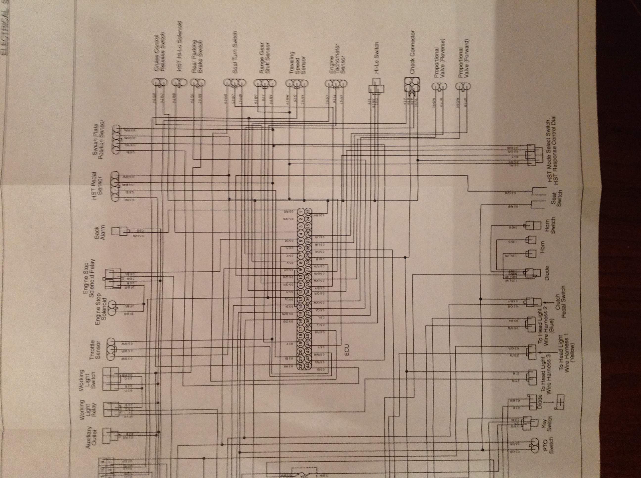

Wow! Got to remove wheel and fender to get to ECU huh? Thanks for the pics

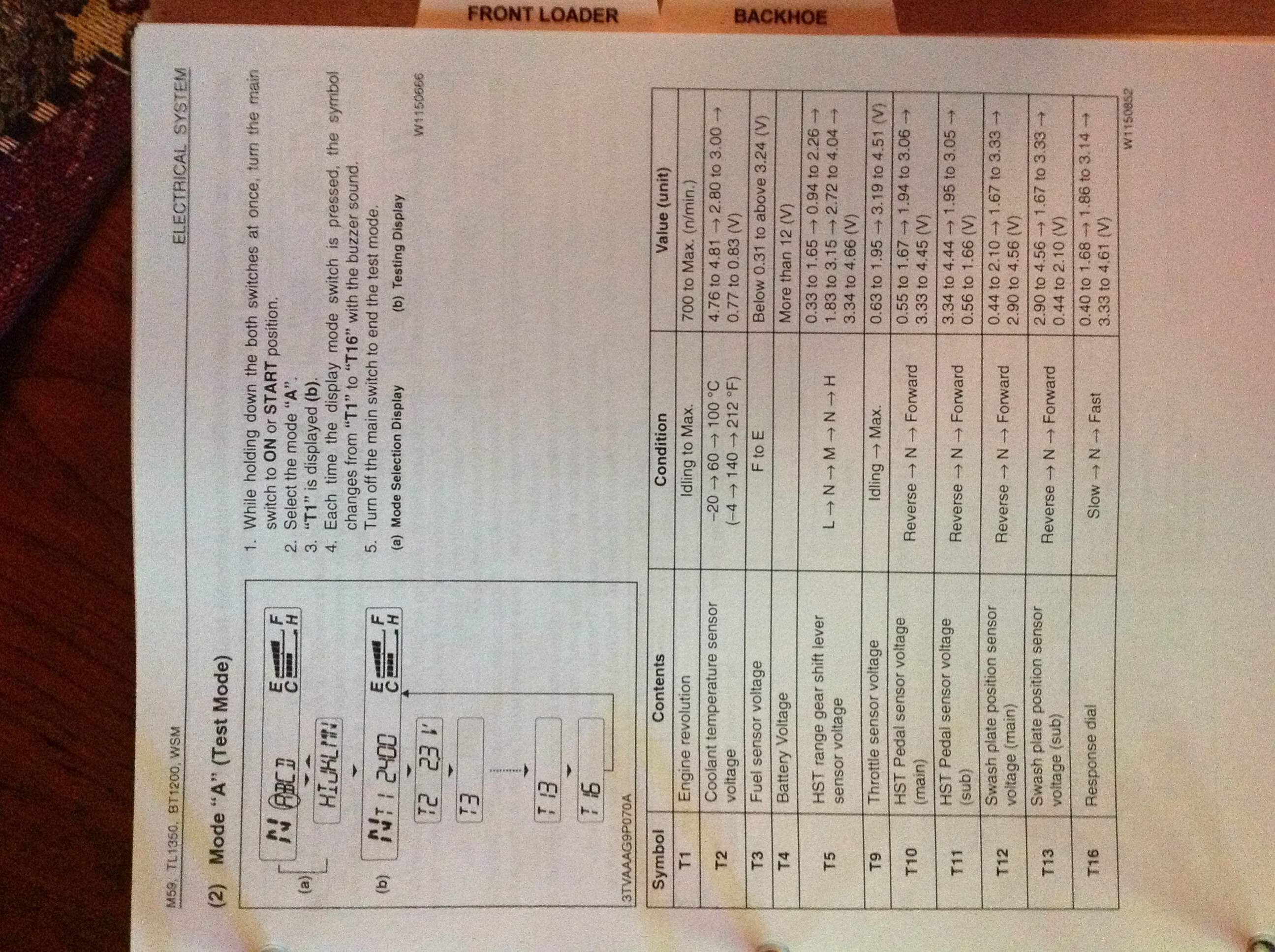

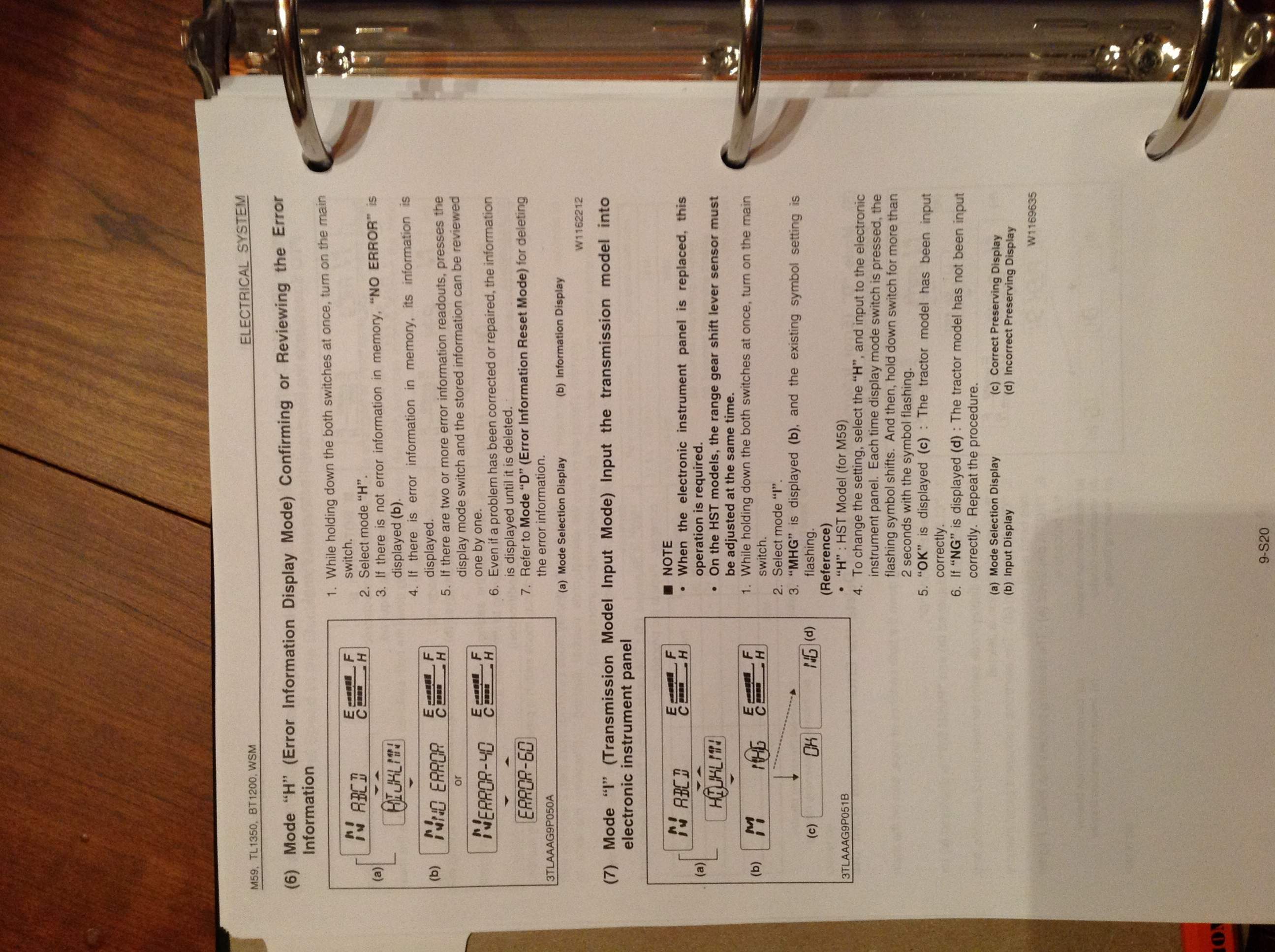

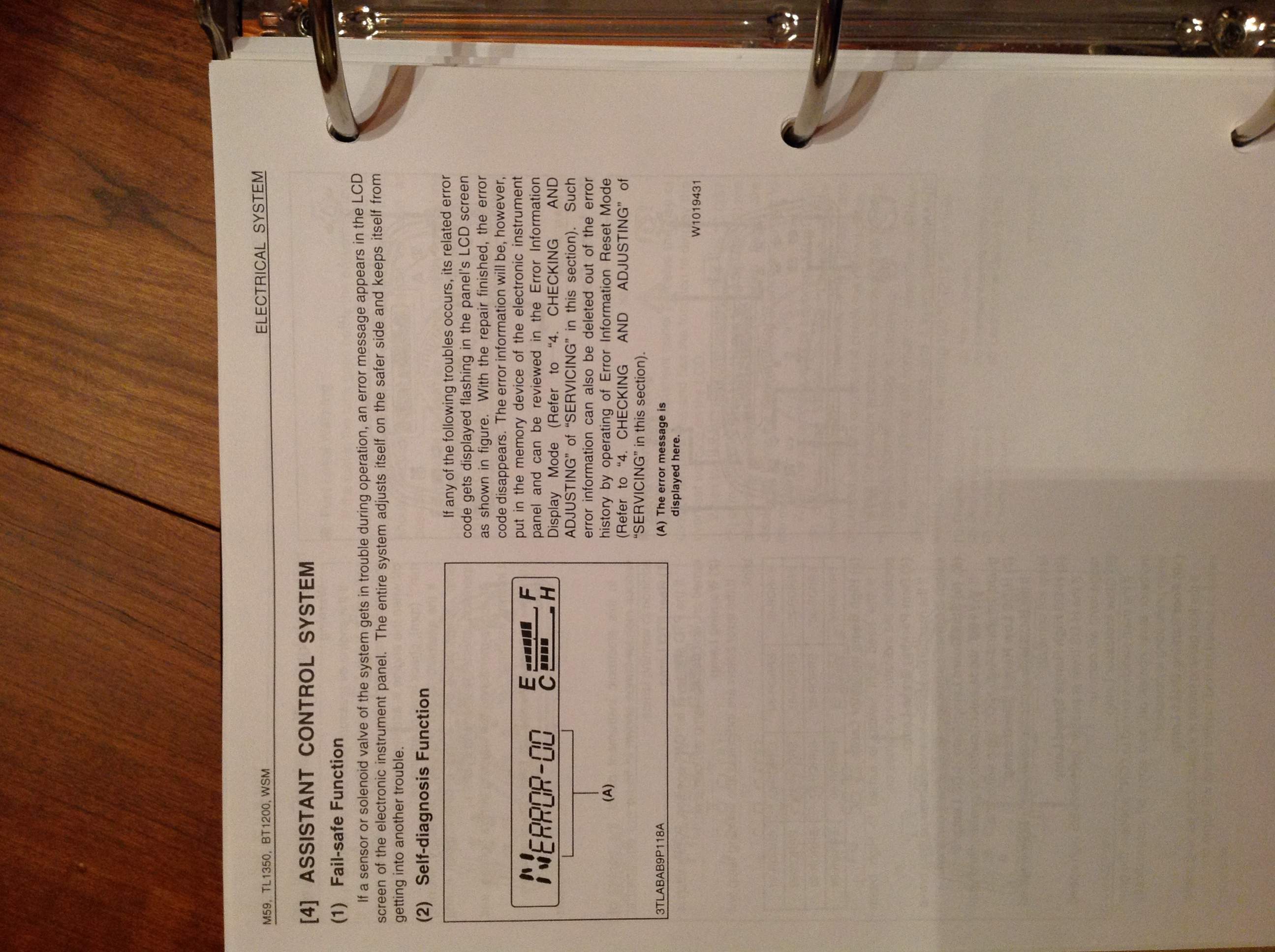

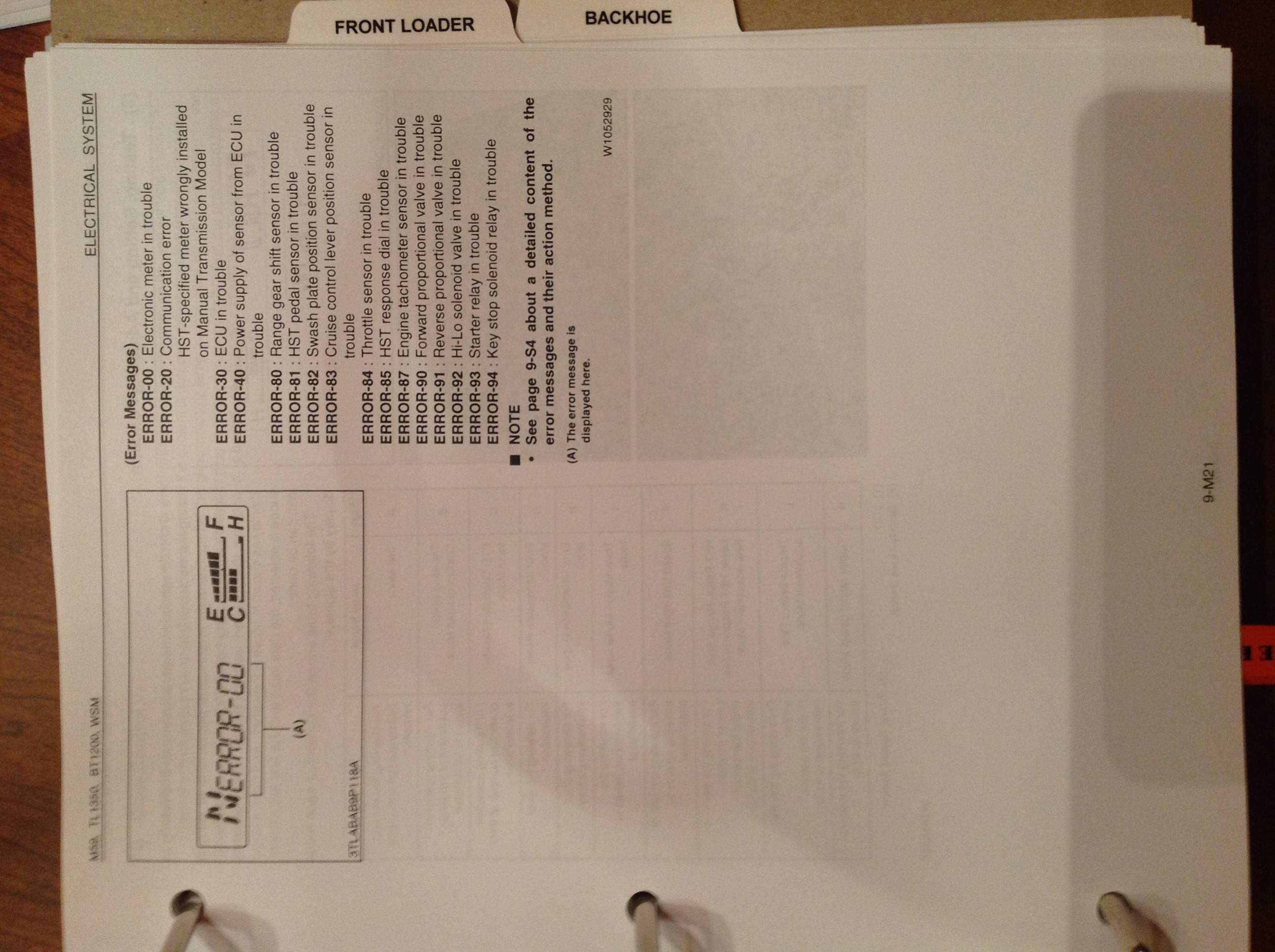

The system will save in memory any error codes that occur. They remain in memory until deleted even if the source of the error has been resolved. Any chance you may have missed seeing an error code? Attached provides instructions to recall errors.
T12 and T13 are the swash plate main and sub position sensors. The expected values are in previous attachments. If they are not normal I think I would check the wiring and connectors.
I can send you the adjustment sequence for these sensors. However, it sounds like you have no signal at all.

I do have a voltage reading from the sensors, it just doesn't change as I give it throttle. Thinking this means something between ECU and swash plate is wrong?

Did you ck for error codes in memory?
