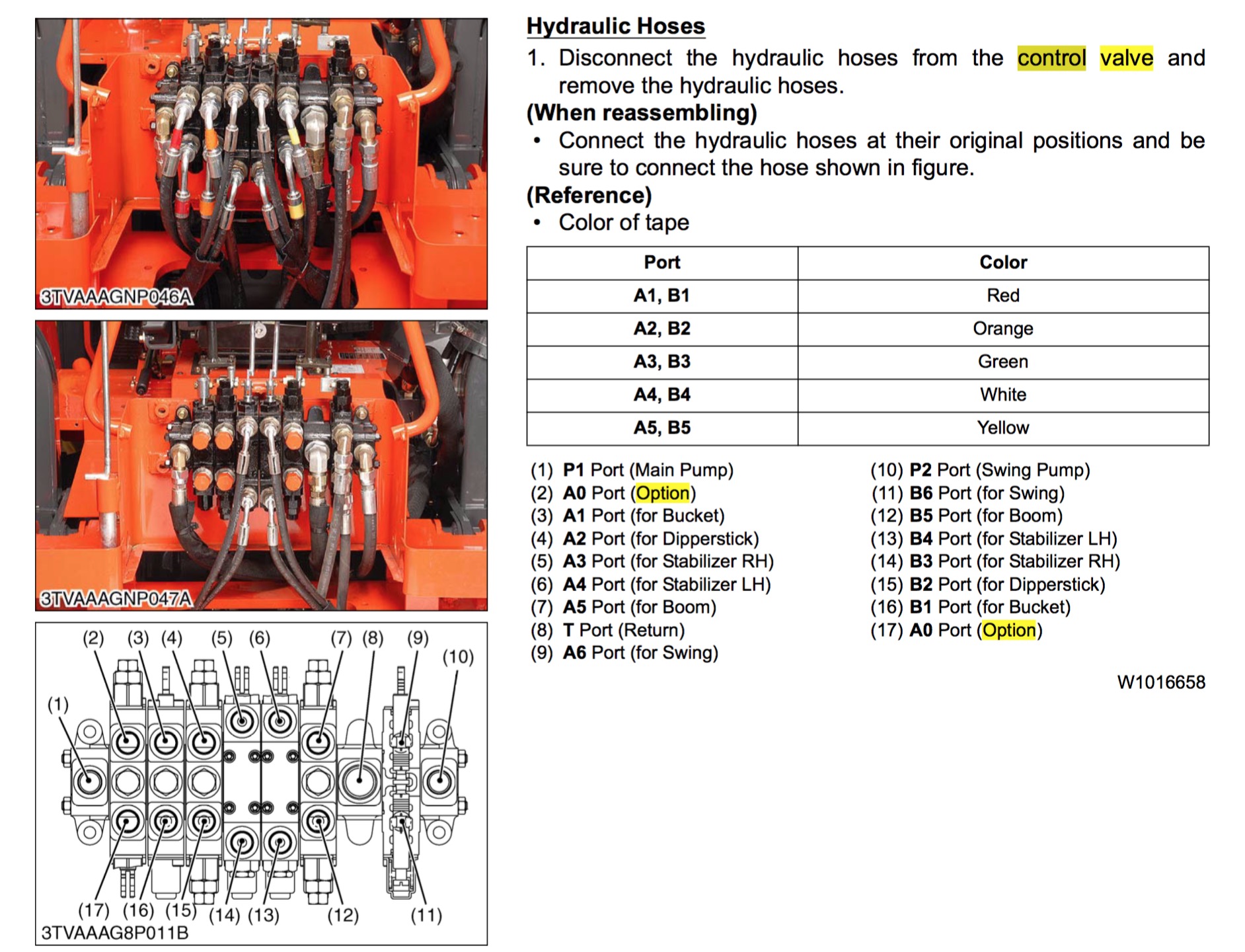

Has anyone here looked at swapping/modifying the aux. manual hydraulic control valve to electric solenoid operation to replace the foot lever?
And before I start opening things up does anyone know what kind of valve body Kubota uses if I can match up to an aftermarket valve?

Same complaint here, it’s hard to actuate the pedal wearing steel toe boots. I want to put a toggle switch on the bucket control. Ideally I want to find some kind of electro-mechanical actuator kit I could simply bolt on to the existing valve body to replace the foot lever. I see a lot of pneumatic actuator kits for trucks but adding a compressor seems a little too costly.

Surpluscenter.com have 12v linear drives for experiments. They also have 12v hydraulic valves.
A simpler idea might be a hand lever near the backhoe hand controls mechanically linked or replace the OEM foot control.
