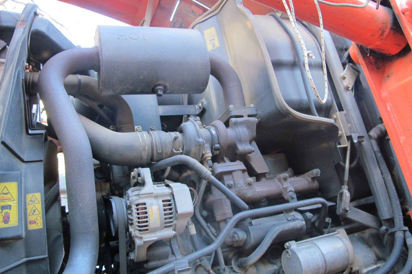

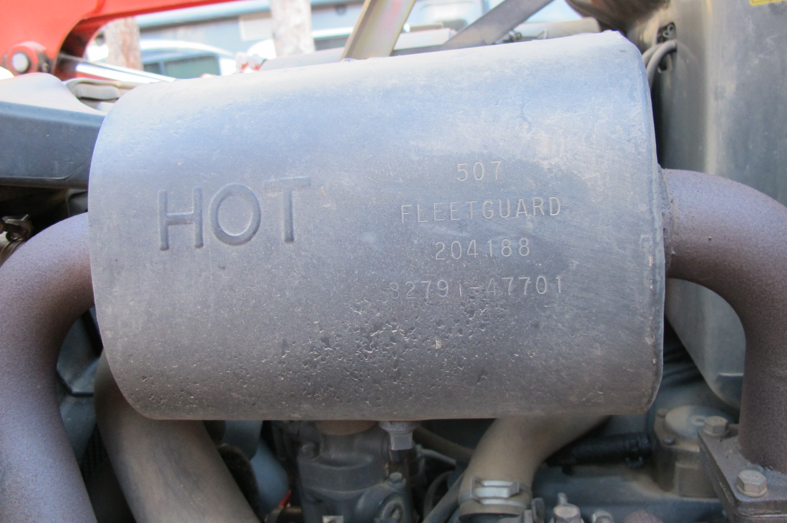

Here are the photos. The plug is clearly visible.
It's a "FleetGuard"
Looking at the exploded parts diagrams on Messick's site, it looks like our mufflers are the same muffler can but with different bend to the pipes in and out because of the turbo.
Kubota's price is in the 500 dollar range, which is enough to dissuade me from buying one just to cut up for curiosity. Good place for a borescope though.
My bet is it a simple longitudinal screen within a can....Might be able to track it down by the FleetGuard model number stamped on the muffler.

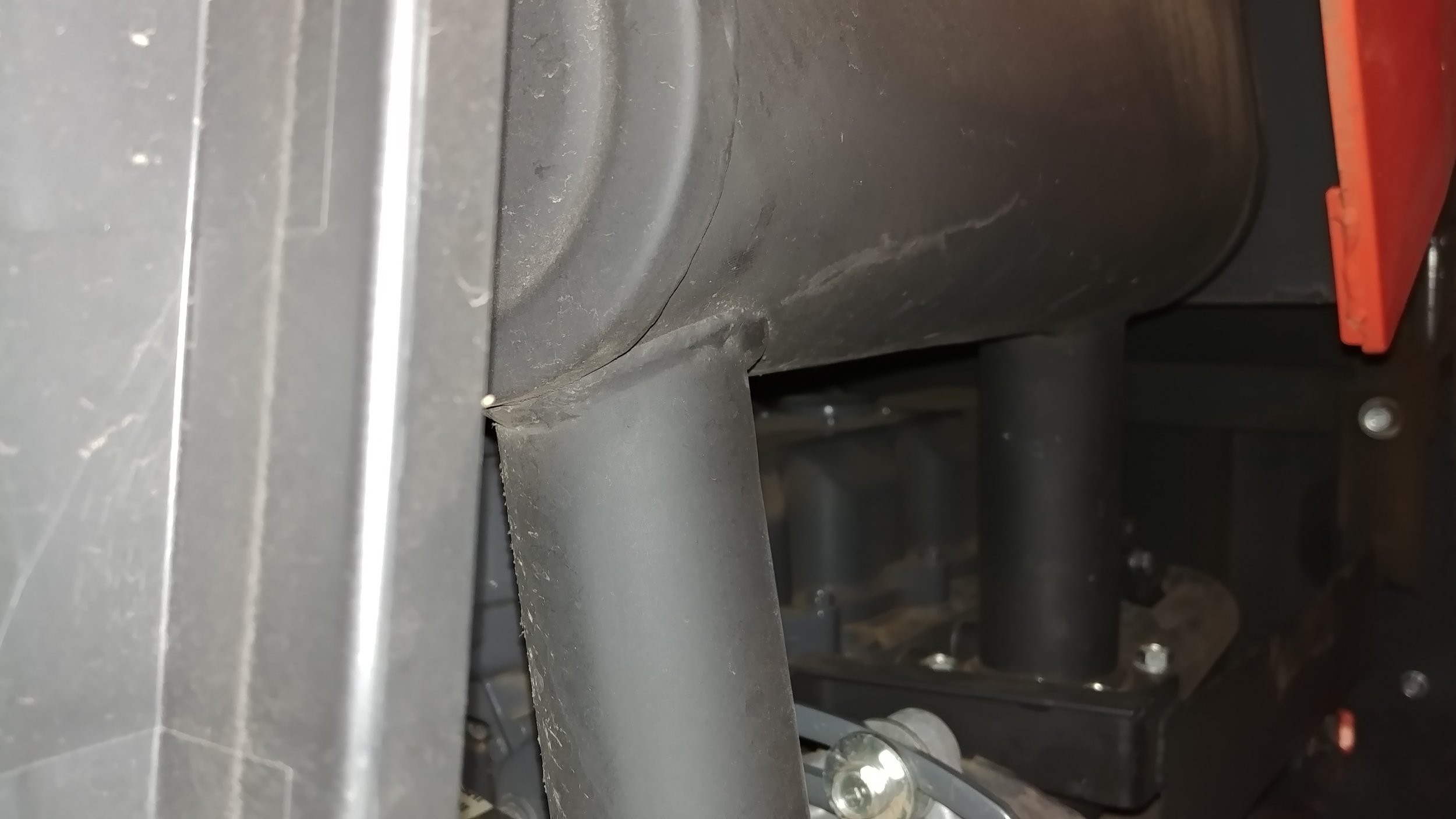

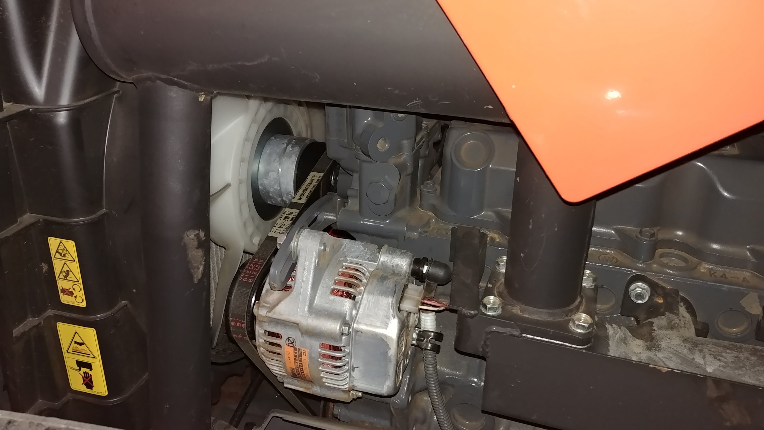

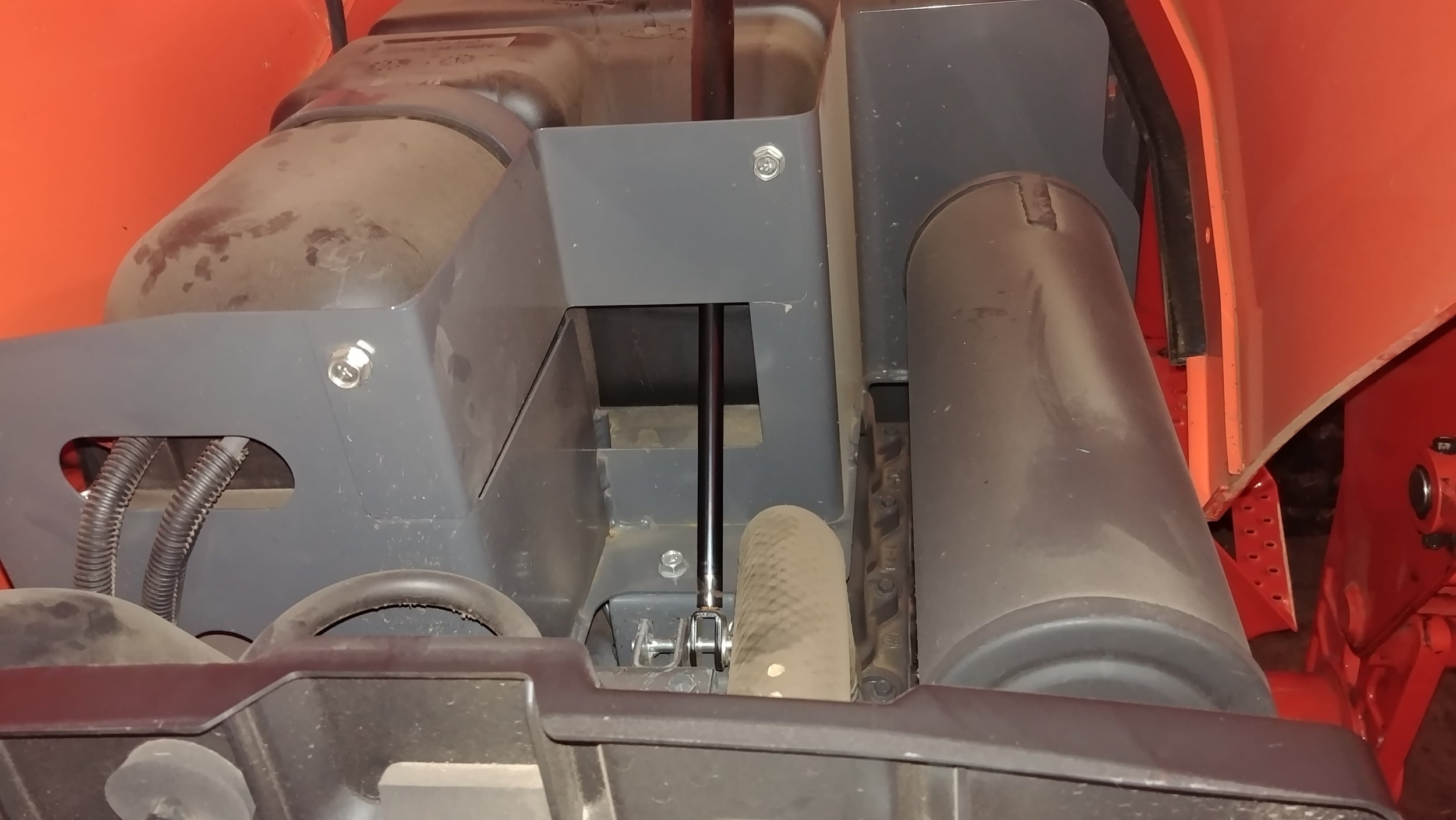

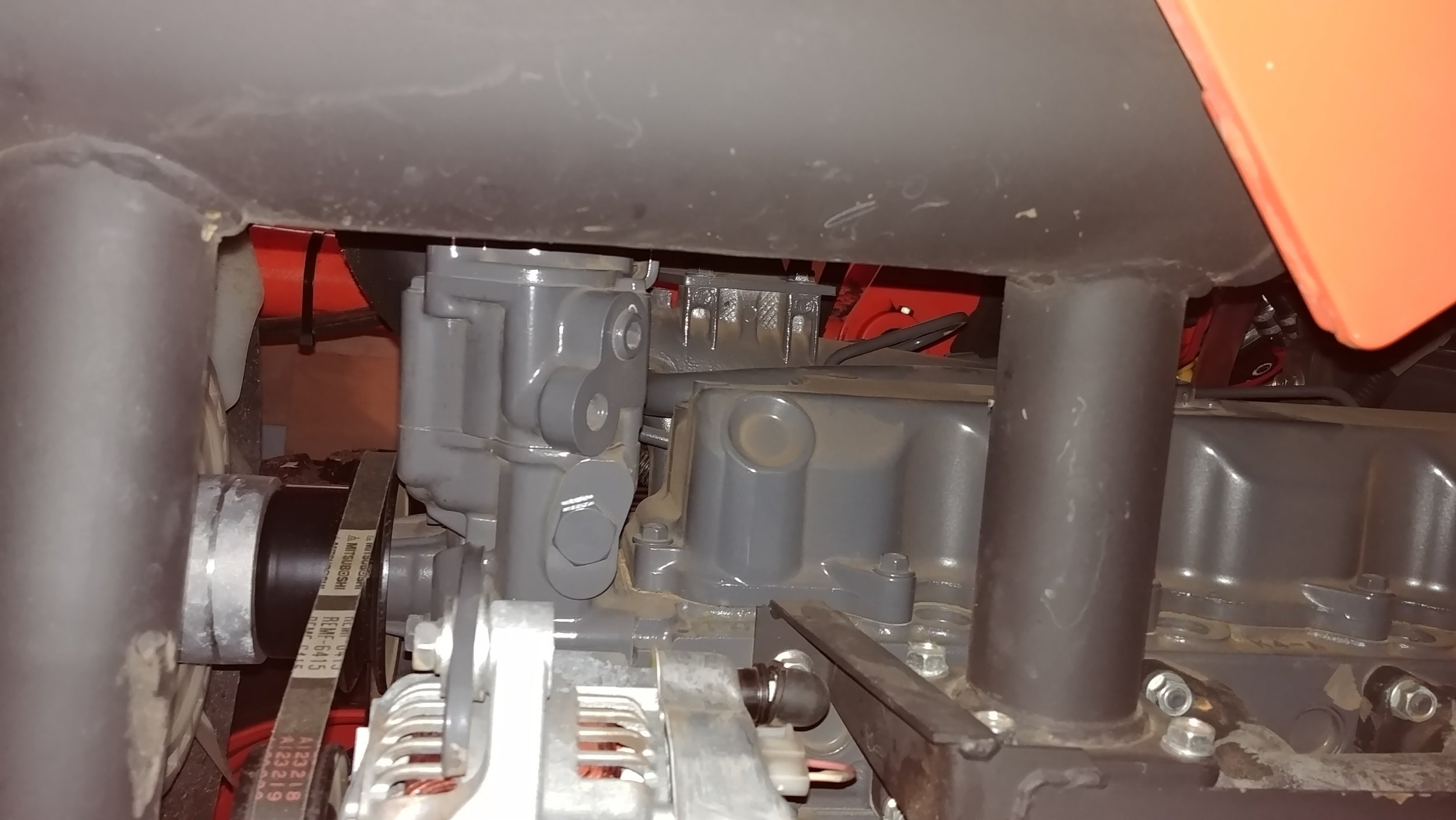

Oh, interesting. My muffler looks a little different. Here are my pics. Sorry not as good as yours. Front end loader and hood in the way.

Thanks for posting those pics!! Also checked the workshop manual and it did not mention servicing the muffler. I forgot to see if there was anything in the owners manual. I will try to remember tomorrow. If you wind up doing this service could you please let me know how that went? Wondering how much crud would come out.

Your pictures seem good enough to see what is going on. I don't see the square headed drain plug in your muffler that we can see in my M59 & not sure what that means....
BTW, I didn't remove that plug on mine to see if it would put out some carbon. I just turned it a quarter turn just to prove to myself that it was free, will wait until some day when the muffler is hot to remove it. I'm not expecting much.
Right now my inclination would be to borescope it and follow that with a snake if it seemed necessary.
Our M59 smokes heavily when starting or changing revs...but burns clean at constant RPM. The EGR valve system doesn't appear to do anything at all.

Thanks for your responses rScotty! I understand not wanting to mess with the exhaust unless you have to. From what I can tell the EGR on my machine is simply taking the positive crankcase ventilation gases and reintroducing them into the intake manifold. I believe older machines use to just vent to outside air.

I looked at the pictures that you posted earlier. What makes you think your tractor has EGR?
There's no doubt about the EGR. I don't know how many other years or models had this particular EGR system even within the Kubota line. In fact that's one of my questions. I also don't know if other tractor manufacturers used a similar EGR between 2007 & 2014. But Tier IV Interim Emissions regs allowed for all sorts of chicanery in emissions during those years. Kubota chose an ACTIVE EGR system to make this particular engine meet the letter of those regulations while ignoring the reasons. This EGR was attached to their popular 148 ci engine from roughly 2007 to 2015? I'm not sure about the exact years.
Kubota calls it an EGR, but it is only vaguely similar to the passive old EGR we saw on American cars a few decades back. That one was just a passive pressure balance tube & rattle valve between the crankcase and the intake manifold.
For one thing, Kubota's EGR is anything but passive. It is turbo-driven pressurized system, metering water-cooled exhaust gases back into the intake air flow. Injected and controlled by engine temperature and valved through a fairly complex control gadget (the actual EGR) with valves and springs. You can't see that EGR controller in the photo because it is on the other side of the engine. But in that photo you might be able to see the exhaust gas cooler. I'll go look....
EDIT: Yes, you can see the cooler. In the photo with message #6 it is right above the starter.
rScotty

I did notice that cylinder style item. But it seems weird to put exhaust gases into the crankcase.
I did expect to see a line being teed into the exhaust after the turbo, running through a cooler, a control valve and finally into the air intake.
Yes, and that's exactly what happens. The cooled gases go through a pipe to the other side and are fed into the air intake manifold via the EGR control valve.
But you have to ask yourself, "Why? or rather, WHY??"
Where is the advantage to all the parts & plumbing just to run hot depleted gases back through the combustion chamber? What's the good in doing that?
Basic thermodynamics will tell you that a loss in efficiency is inevitable, and that loss can only be be offset by burning more fuel - and thus creating more carbon.
And in fact that is exactly what it does. Someone noticed that the Interim Tier IV regs allowed more soot if NOx is reduced. Which is exactly what this system does. NOx is reduced in one narrow rpm range not often used on this model tractor; soot is increased substantially in all ranges.
It's a system designed by legislation over common sense.
