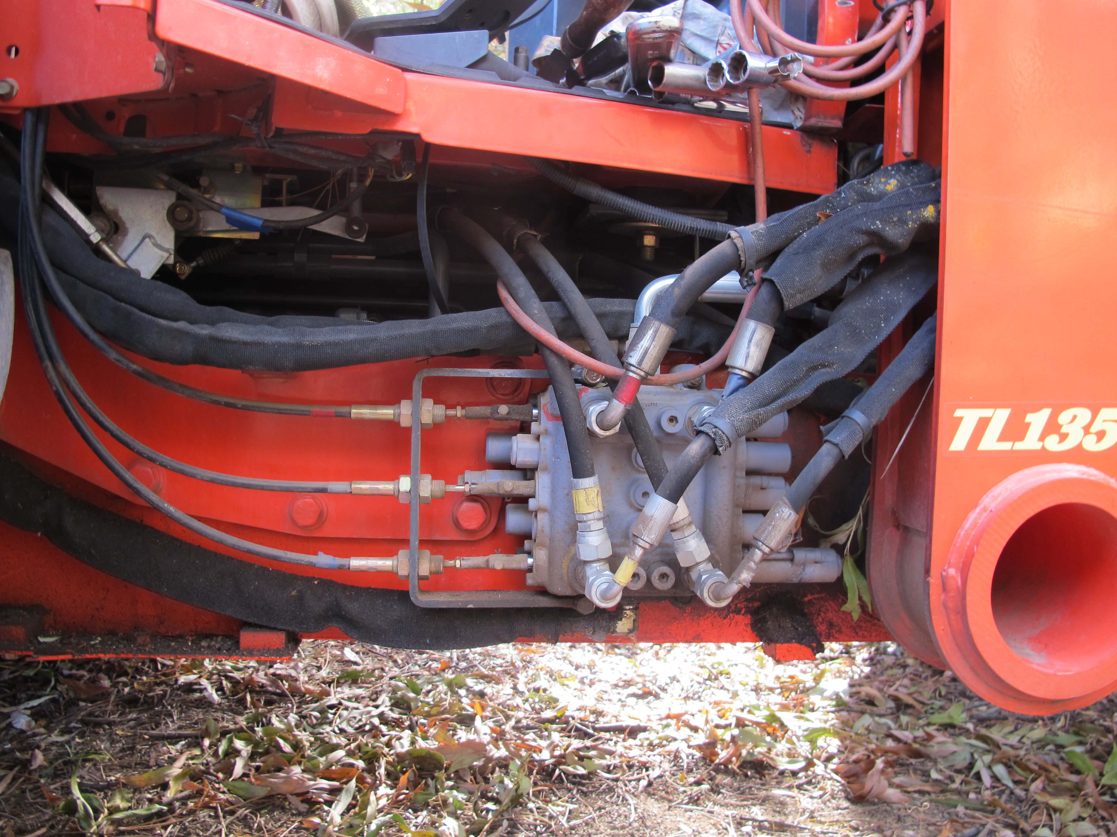

Here is the story: My loader control was beginning to feel different in one direction than the other so one day I decided to pull up the rubber cover and grease the loader valve pivots. Seemed easy enough because I thought that my loader control valve was probably under that rubber cover on the control stick. But what I found there instead are bell cranks & wire control cables that run down the control stick to the real loader control valve which turn out to be bolted to the frame under the right floorboard and behind a steel cover. After lying down beside the machine and taking that cover off the loader hydraulic control valve appeared to view....along with the control cables & associated small threaded end-play adjusters. Photo below.
I've been a mechanical guy for 60 years, and that is the most crazy complicated way to actuate a loader control valve... I've never seen anything quite like it and cannot fathom why they would do it that way. Not only is it a lot of unnecessary monkey motion, but it is down where dirt and mud accumulate. But do it that way they did. And of course those control cables are all eventually going to need lube. Mine are already working a little bit stiff in one direction. The problem is how in the world can we lube those cables? I'm open to ideas on this.
Can we force some lube up the cables from the bottom? Getting to the upper end of the cables is more difficult than you'd think.​

On the loader control, how does your M59 feel? Lubing from the bottom is much more accessible.
If anyone does try to access that loader control from the top, it involves taking off the plastic control cover - which involves taking off the plastic handle covers..... And be especially careful with the illuminated electrical activating button for the front hydraulics. I should have disconnected the leads from below and then fed them up as I pulled up the plastic control cover. But I didn't do so and somehow destroyed that button. It is very fragile and Kubota wants a fortune for one. I'm looking for a replacement.
That was about the point where I discovered that the control valve wasn't located up on the top of the control valve stalk as I was expecting anyway.....
The best way would be to come up with a gizmo to force lube up from below. Maybe something like the cable luber you show but fancier. BTW, it's worth taking off the lower cover anyway. Mine was full of mud.

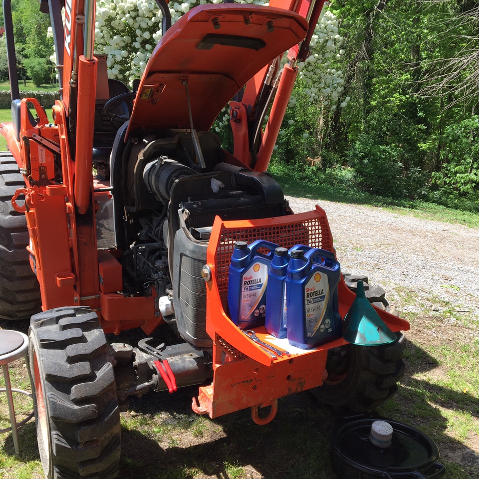

Loader control is smooth. Have not lubricated. Do ~3x/year wash or blow the dust and mud off. Now I have 100# of skid plates and tool holder bolted in front of that loader valve cover.
Just changed the oil and cleaned the fuel filter this morning. That bonnet protector is a sweet tool service bench.
The manual says 9.9qt with filter. I get 9.1. Used no oil in the last 200 hours and 3.5 years.

It could be flat spots on the tires. Surely something is causing it. No matter what it is, a hydraulic accumulator would br the simple way to take care of it. Or of course I could just slow down.....
Remember to put that bonnet protector back up before lowering the bucket or yours will look like mine.
/ M59 Lube Challenges #8
Thinking of your sage expertise every time I open the bonnet protector. Thanks.

I was surprised to see cable controls for the M59 loader valves. My suspicion is that any sloppy or sticky feel is due to the cables rather than the valves but those cables sure are hard to get to.
The backhoe levers control the valves directly and they are still accurate. Maybe some lube on those pin joints in the levers will keep them that way.
