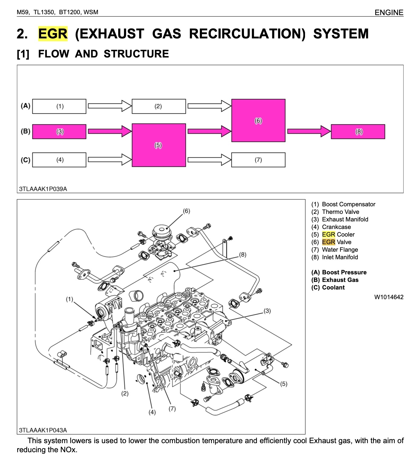

How do you disable the EGR? Thoughts on adjusting the timing?
There is a rather large company in a nearby rural county that adjusts diesel big trucks, big equipment, ag etc to improve performance, economy and longevity. Since they do on road diesels I’m sure they do what’s legal. Not your teenager with diesel pickup hot rod shop.
My old M5030 could bush hog with about half the fuel of my M59. So if one could improve the power and economy would be nice.
Hey Smokey,
Do you have an M59 workshop manual? If so, you'll have noticed that each mechanical system has a "how does it work" section followed by how to fix it.
The EGR section in the engine chapter of the workshop manual is particularly good.
The EGR assembly is a pressure-activated bellows which opens an EGR valve allowing the turbo to force a bit of cooled exhaust into the intake manifold. But the EGR doesn't open until a thermostat at the front of the engine senses that the coolant is above 149 deg.F. At temperature, that thermostat opens to allows a bit of pressure back to work that bellows in the EGR assembly which then opens the EGR valve. The bellows activating pressure is conveyed back to the EGR assembly by a quarter inch diameter rubber hose running back from the thermostat on the front of the engine. Line "B" on page 1-M3 in the manual.
If you simply put a valve in that hose you can turn the EGR on/off as desired.
Since I'm at 7000 feet, and my engine normally runs cool... and I've suspected that the EGR may not function as designed on our M59.
Eventually I plan to add a solenoid valve so that I can turn the EGR on and off from the dash. And may put some pressure gauges and a real coolant temperature gauge there as well.
Yes, the M59 Interim engine is a fuel hog. Remarkably so. Ours also uses a surprising amount of fuel compared to older engines. I suspect that is because of the timing, but I need to know a little more before thinking about changing that. From the workshop manual it sounds to be fairly easy to do.
