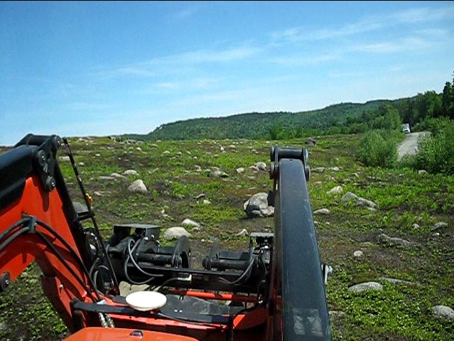

I go fast enough to toss me around the cab a lot. Same thing with the equipment on the 3pt. I put 440/65/24 Michelin Multibibs on the front of the 105S and the extra cushion is nice. Anything is welcome because bumps are relative- 2.5mph on ground where you should be traveling 2.0 or maybe 1.6 is really rough, even though someone else might think that 2.5 is realllllly slow and the operator must be comfy.
Action shot...
