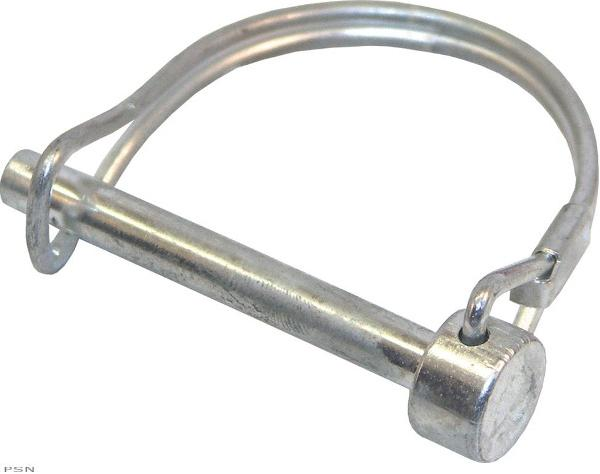

Re post 47. This lynch pin is a cheap type. The giveaway is there is no bend on the ring where it enters the pin head so the ring ends go in at an angle. This lets in dirt that gums things up making the ring stiff and sit out slightly from the pin exactly as in post 47 photo.
The best / reliable type are the ones with a bent end on the ring to ensure the end goes into the pin "square" and this seems to keep the dirt out as well, so it is rare for the pin to get stiff, and not sucure properly.
